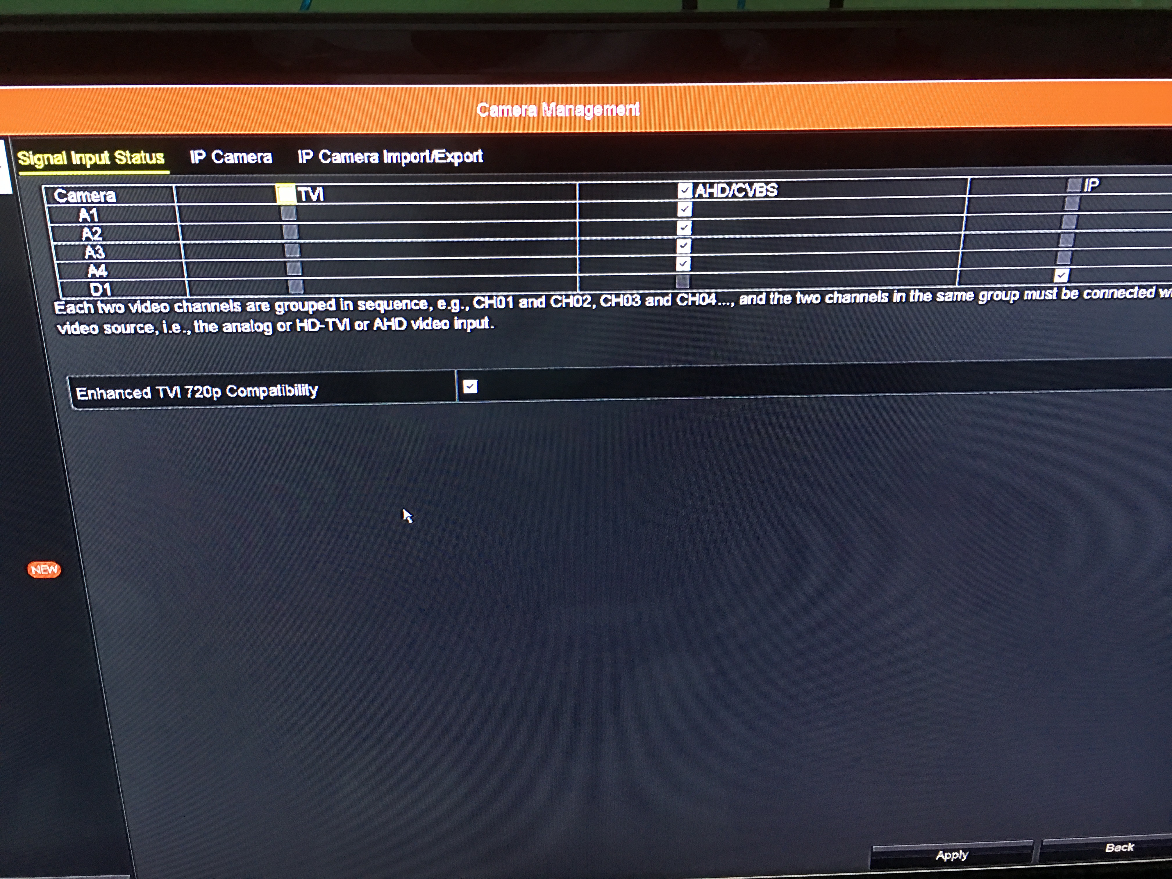

When I connect with TVI option, camera works with black and white.
I connect with AHD option , no video.
Any suggestion? Plz help me out. Thanks again.

I'd definitely recommend you update to v3.4.70 as I mentioned above. The automatic signal choice would be a useful troubleshooting step.

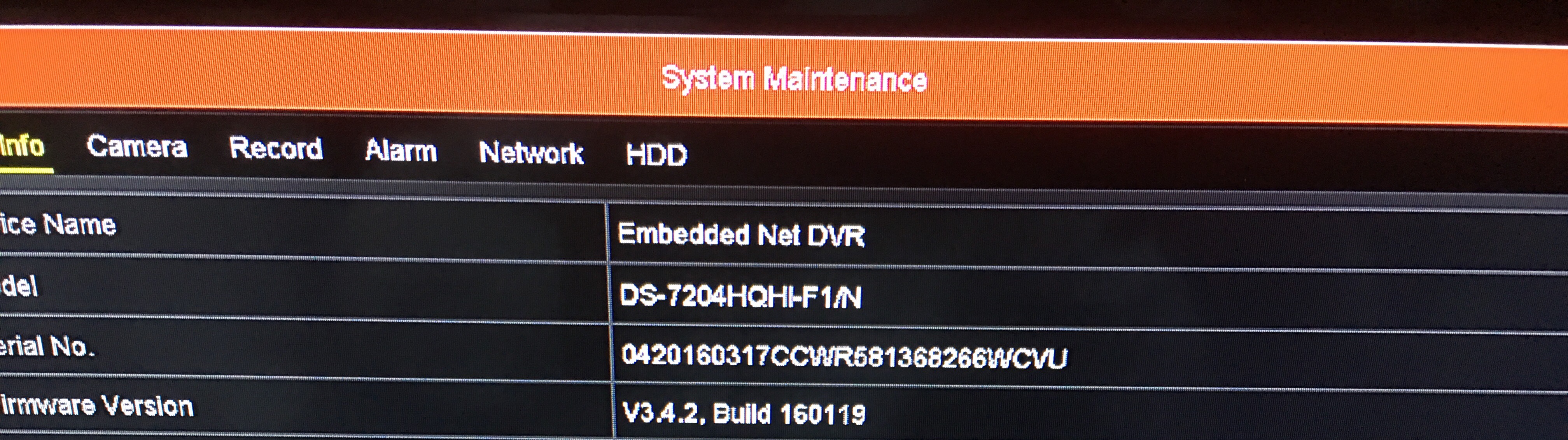

Thanks for your support. Sorry, my dvd is 4 ch, 7204HQHI-F1/N.
I can upgrade to firmware version, 3.4.70.
Can see AHD video black & white first, later changed to colour and video loss.
