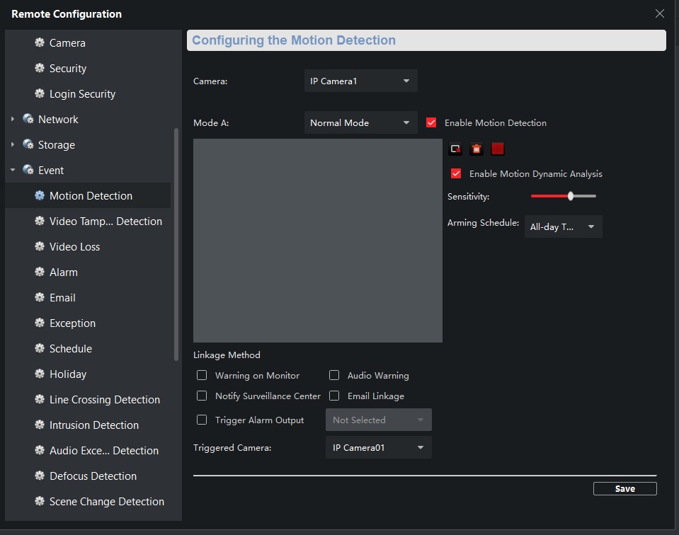

I've just recently setup a Hikvision CCTV system at home, but i'm having a couple of issues.
I've got a DS-7608NI-K2/8P NVR running the latest firmware, and i'm using iVMS-4200 3.1 to configure/monitor it on my laptop over the network.
However i don't get a Preview when i'm trying to setup anything that involves a preview of the camera image (for example motion detection, or image settings). I just get a grey box like the screenshot attached. However when i configure via a browser (IE) i can see the image and draw the grid.

Latest firmware?
Have you installed the web components plugin?
Firmware - V3.4.103 build 181226
Yes i have the web componenets plugin... configuring on a browser works fine, the issue is when using IVMS 4200 within windows.
Windows 10 64bit.
