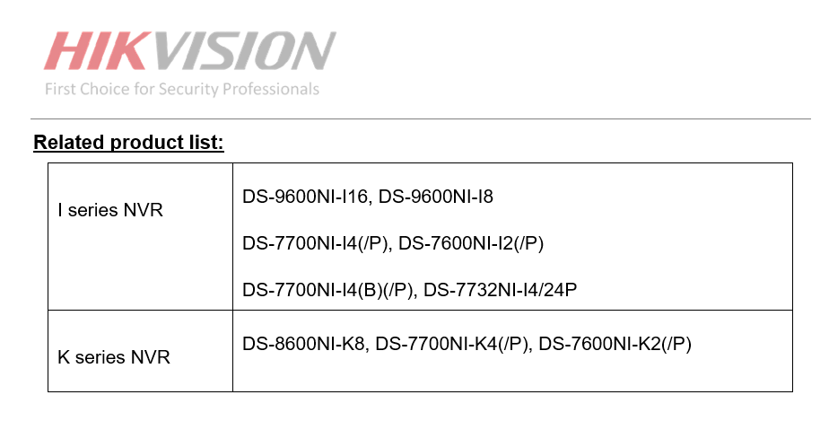

Hikvision even say so themselves, in the release notes for recent V4 firmware. See the screenshot below:
The above is taken from the latest release notes doc on the V4 firmware (EU portal).

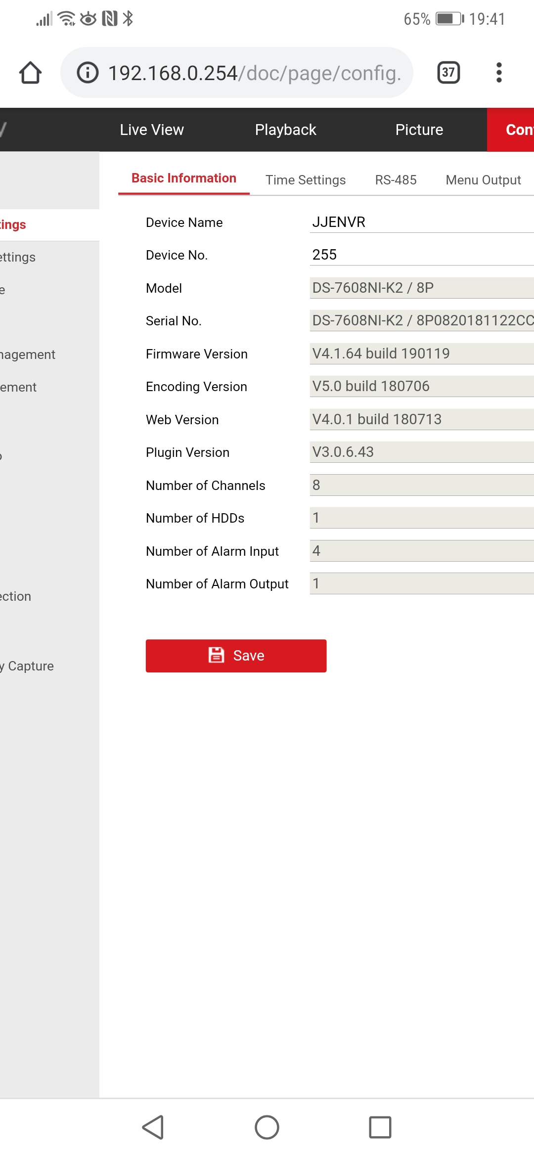

I've just tested the new V4.1.64 firmware on the DS-7608-NI-K2/8P and it's fine, everything works. This is with DS-2CD2385FWD-I cameras.

Actually it was V4.1.64 I installed after all :)

Here is the screen shot showing the V4 on the -K 2 series
