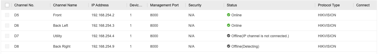

Hi everyone,
I purchased a DS-7608NI-M2/8P from Use-IP last November, and paired it with 4x 8mp cameras (DS-2CD2386G2-IU 2.8MM AcuSense 8MP)
I've had ongoing issues where at least 2 of the cameras, sometimes 3 will go Offline and stay offline. It seems to be an intermittent issue, in that if I restart the CCTV then all channels are available, then slowly but surely they'll start to go offline. Sometimes in channel management it'll show a different error message, such as Offline (detecting) or it'll say Offline (Network connection failed.) - I'm also currently seeing Offline(IP channel is not connected.) but then will be fine if I restart the unit again. They'll also randomly appear as 'device offline' in the Hikvision app but then appear online in channel management on the NVR web menu.
All cameras are connected via plug and play and are in the right IP range (from 192.168.254.2 upwards in sequential order).
Has anyone come across this? Could it be that the 4x 8mp cameras are too demanding on bandwith? I have them all set at 4k but did enough research (I think?!) to think that should have been fine with this NVR.
Everything is on the latest firmware, however I've noticed that the only camera that doesn't go offline is on the firmware V5.7.12 build 221201 and the other three that do go offline are on the firmware V5.5.800 build 210628. The NVR is on V4.63.010 build 230619
Thanks in advance for any help!

another error appearing:
Offline(Channel streaming failed.-0x1b01043)
It's not that...you're unlikely to run out of incoming bandwidth on the M series. It could be a connection issue, a poorly terminated CAT5E cable (wrong colour scheme [even if pins 1-8 are straight through], poor connection) or moisture in the connector will cause cameras to drop offline.
