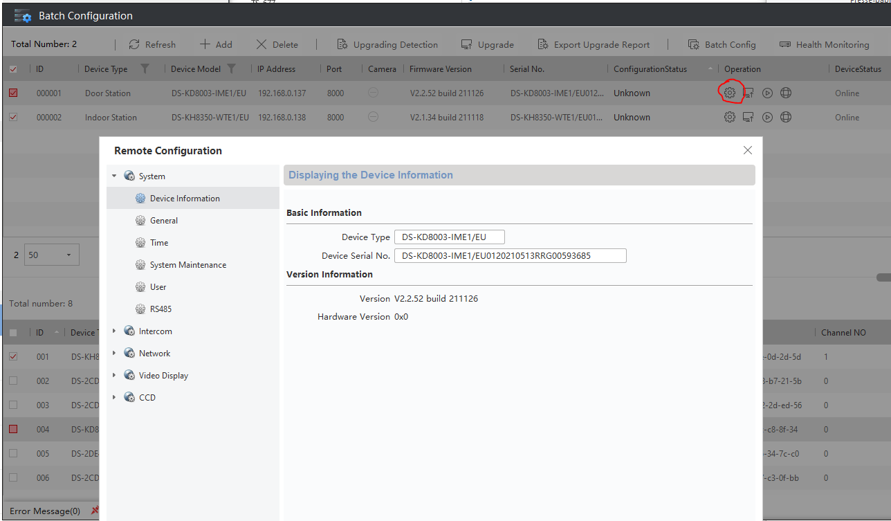

Through batch configuration tool I can access to remote configuration, while IVMS still gives me a blank page...

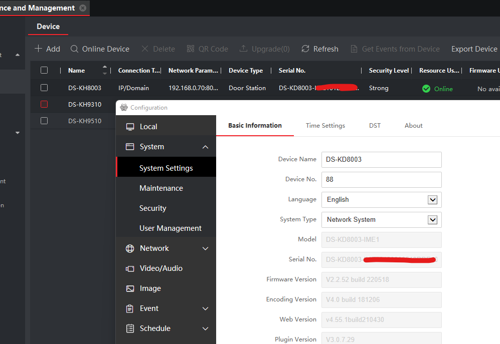

i run this version: V2.2.52 build 220518
i have no issues with this device, hikconnect works, also if i test SIP it works, no issues, quite stable
Maybe its ivms related? try updating ivms too, i remember issues with ivms and newer firmwares , i run 3.6.1.5 build 20210831
