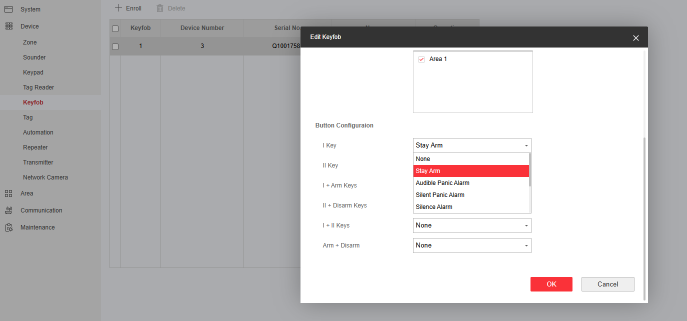

The output you need is solved by pressing Away Arm on keyfob, and assigning Key I to do StayArm
So you can select zone which will be bypassed by StayArm. It will act as indoor zone and it will not be triggered. If AwayArm then it will be triggered.

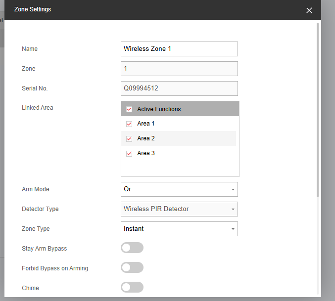

1. awayArm is default arm icon on keyfob, there is no stayarm by default. and you add that via configuration
2. It seems its firmware fault. Currently i dont have wired central but it works the same. As this one can be expanded with wired inputs.
What firmware are you on? Im on 1.2.9
UPDATE: Yes now i see your problem, same here. Delay does not allow OR, now i finally understood. I will pass problem to my hikvision contacts.
