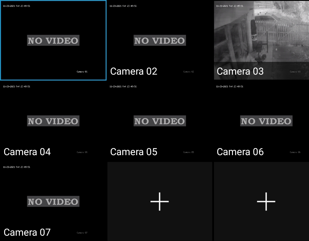

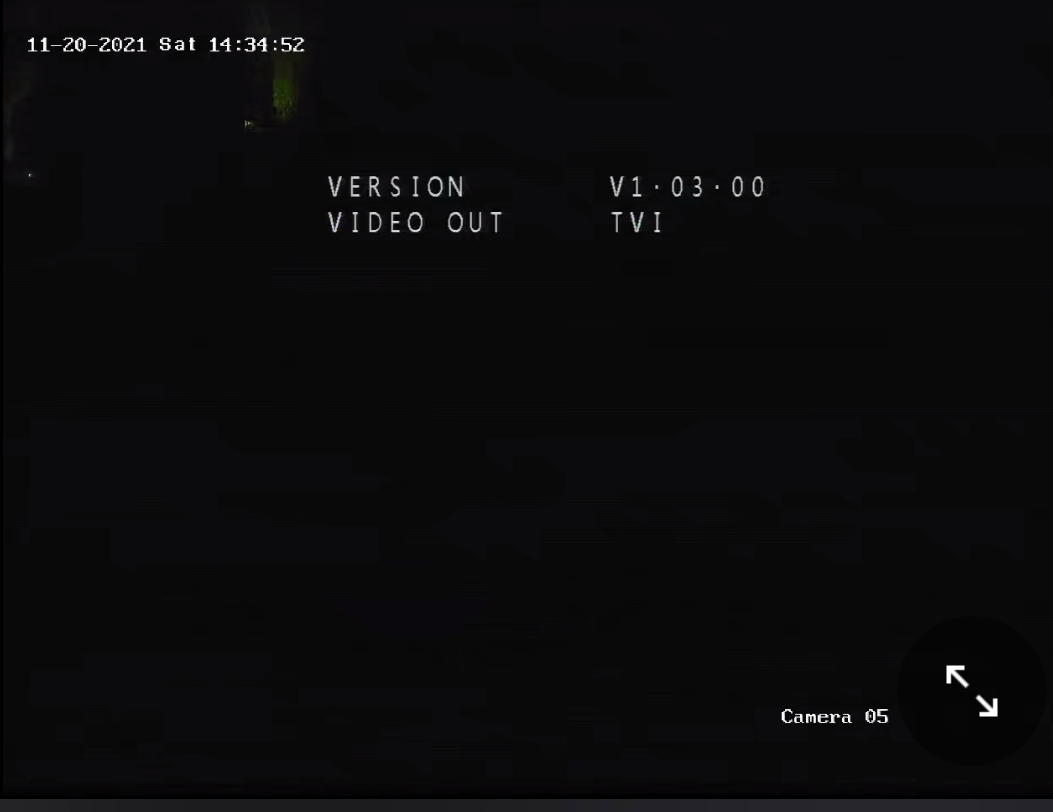

Bit of strange one, about 3 days 3 of my cameras started going black, flashing picture and showing text of version and video out.
It eventually stopped the following morning but last night all 8 cameras started doing the same thing.
I ve restarted the DVR and unplugged the power to cameras for 10 mins but no difference.
Eventually all the camera but 1 have gone to show no video.
