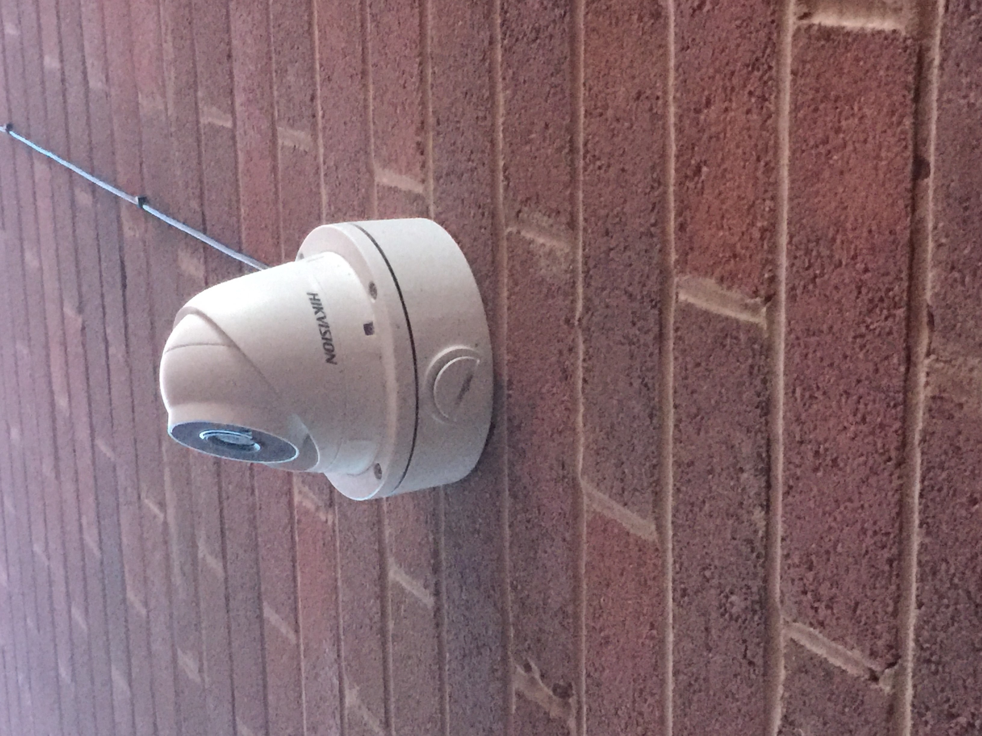

Thanks for the reply, the model of the recorder is DS-7024HUHI-K2, Serial C73647625 im unsure of the model of camera, i have attached a picture, if that helps?
