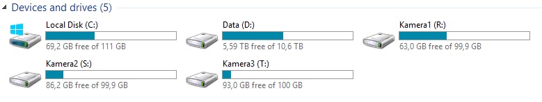

I got three identical cameras (DS-2DE3304W-DE), the same settings on main stream, but when they record to my server (NAS) one of them takes a lot mot space, than the other two. Anyone know why?
As you can see in the screenshots, disk R, S and T is where i store the recordings. I started these yesterday, almost at the same time.

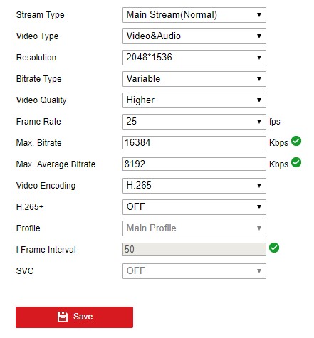

And the other screenshot shows the video setting on the main stream, that are beeing recorded.

Are you absolutely sure the settings are the same?
h.265+ is OFF in your screenshot.
I clicked on it before i took the screenshot.
But it is switched to on at all the cameras.
The only thing that is different is the firmware version (also the encoding version)
The camera that takes up more space is the one that had the oldest firmware, so i tried to update it, but did not help.
I believe the camera is almost two years now, and the two others was bought early this year.

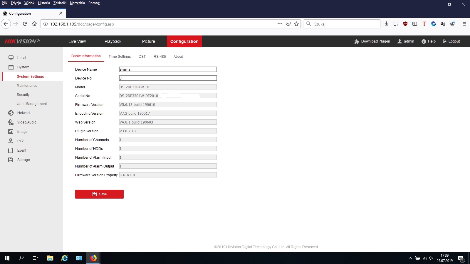

Hikvision have sent us the v5.6.14 firmware for the R7 PTZs which is attached to this post, as @Phil says above this will hopefully be on the download portal shortly but for now, you can download the zip. file here on the forum.
Hello.
I can already see some progress. The datadir0 folder has been full and is now recording to the datadir4 folder. I'll let you know later if it fills up other folders.
so far so good in your testing?
going from V5.5.71 build 180725 to 5.6.14,
step 1; 5.6.11 (needed by release note)
step 2; 5.6.14
or should i follow another path?
First you need to upload versions V5.6.11 and only V5.6.14.
Recording works well. At the moment I have 178GB saved and are following.
thanks, my camera is now updated with 5.6.14, let hope thing goes well on my side too! :cool:
