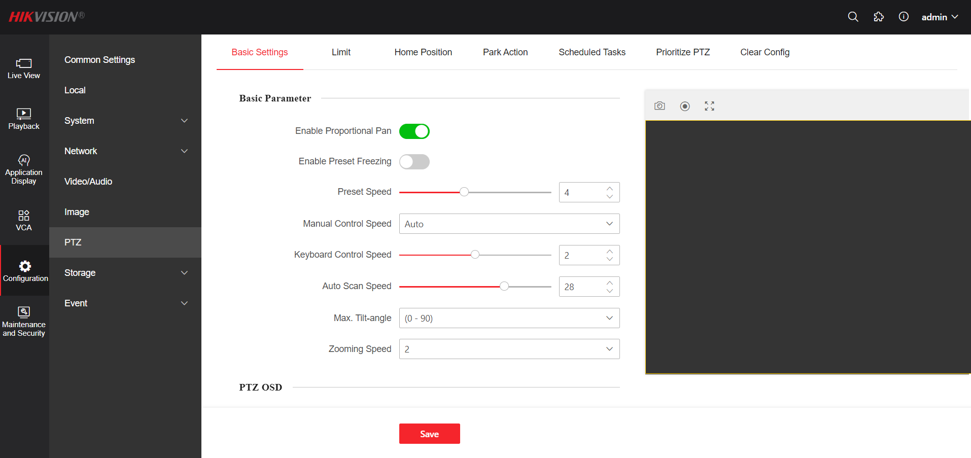

Hello, please forgive my ignorance as I am new to this. I have recently installed the above camera, along with my NVR (DS-7608NI-K1/8P). and I just cannot seem to be able to get the auto tracking to work. I have successfully logged into my camera through virtual host on the NVR, however the login portal seems to be different than for every video that I have seen for the set up of this feature.
This is the UI i am faced with when i log into my ptz camera, i have searched this for 'auto tracking' to no avail. The screenshot below is the page with which all online tutorials are met, only they say 'ptz' on the left menu. and its also the same page format i get when i log into my other fixed cameras (hence no PTZ menu) (3x DS-2CD2347G2-LU)
My question is why does my PTZ have a different log in portal/UI on login?
And how can i activate auto tracking on my PTZ camera?

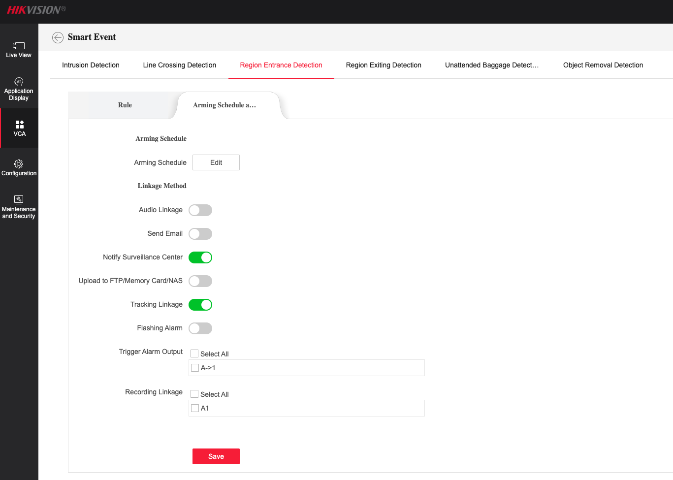

screenshot-2024-12-15-at-14-11-34-png.12116
Should have provided more information, sorry.
So to get this working, I had to do it directly on the camera, there is no option for me on the NVR. I use the NVR for basic motion detection.
Then on the camera directly, I set up VCA > Smart Event > 2 Set Application > Smart Event > (choose which event type) > (setup the rule) > Arming Schedule and Linkage > Tracking Linkage
You can also setup in the top right corner from that page the advance setting for tracking too like how much to zoom etc

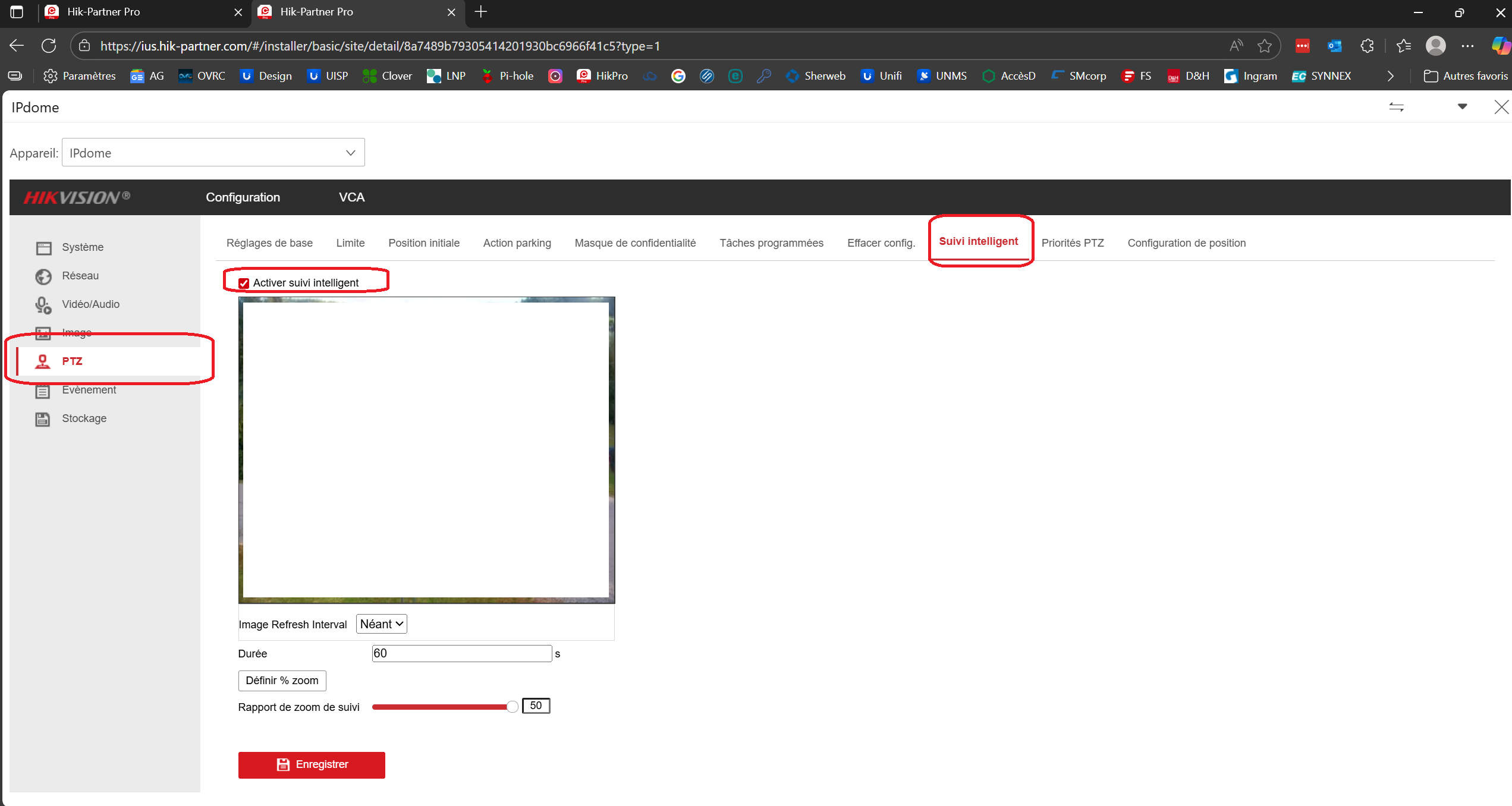

I have a DS-2DE7A432IW-AEB(T5) camera delivered with firmware version 5.8.0 Build 231109. Hikvision Canada tried to help me with the auto-tracking feature, which had been disabled. Their final solution was to return the camera under warranty to perform a downgrade.

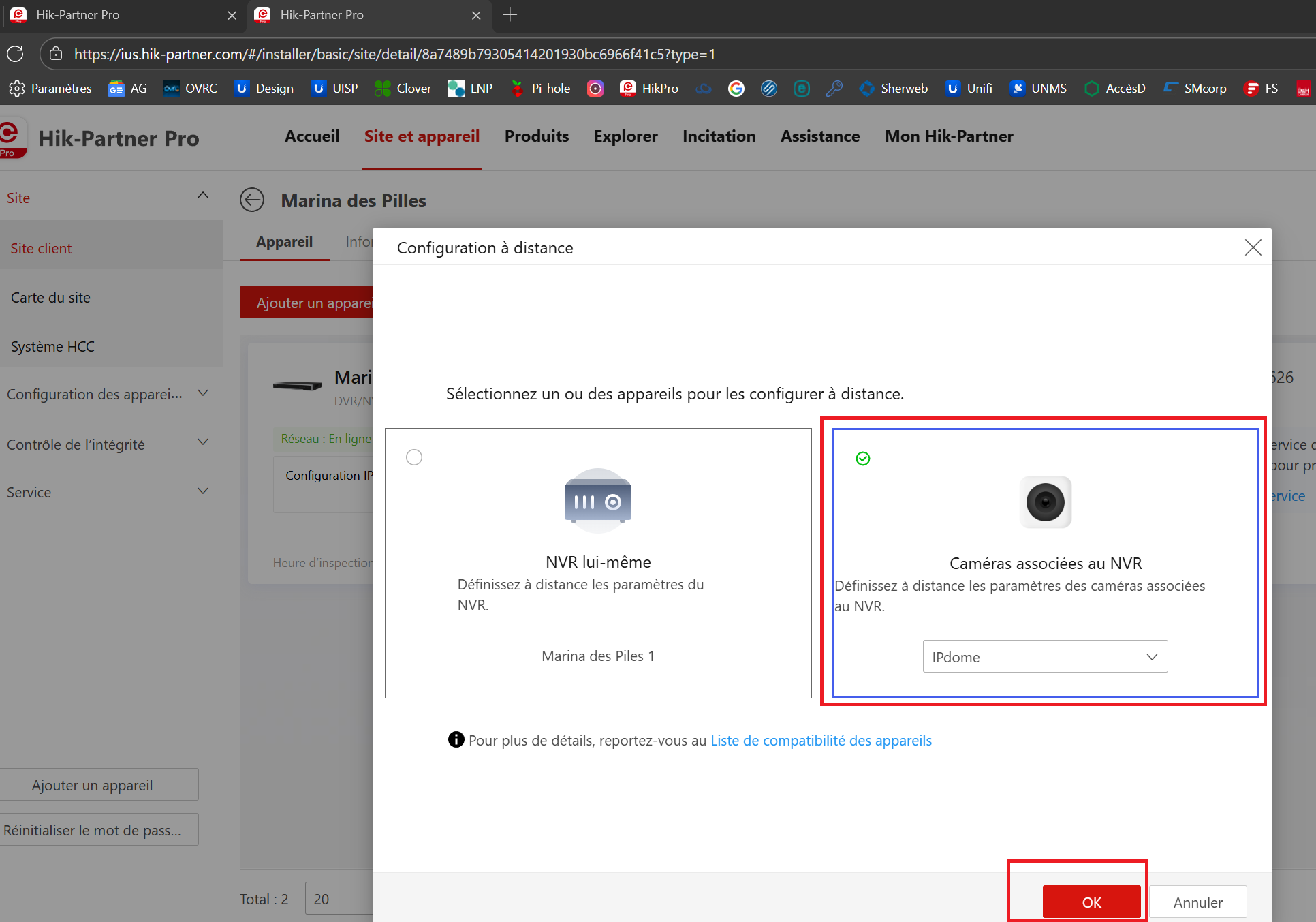

After doing some research on my own, I discovered that with a HikConnect Pro online account, it’s possible to enable SmartTracking through the HikConnect Pro management interface. This brings back the old interface—and it works perfectly.
The post is a bit old, but in case it helps someone:
Hi, where in Hikconnect pro did you enable this ?
In the devices, instead of accessing the camera settings through the NVR, access them directly from the camera. You will see the old interface, and you’ll be able to activate auto-tracking.
My model: DS-2DE7A432IW-AEB
Firmware version: V5.8.0 build 231109
