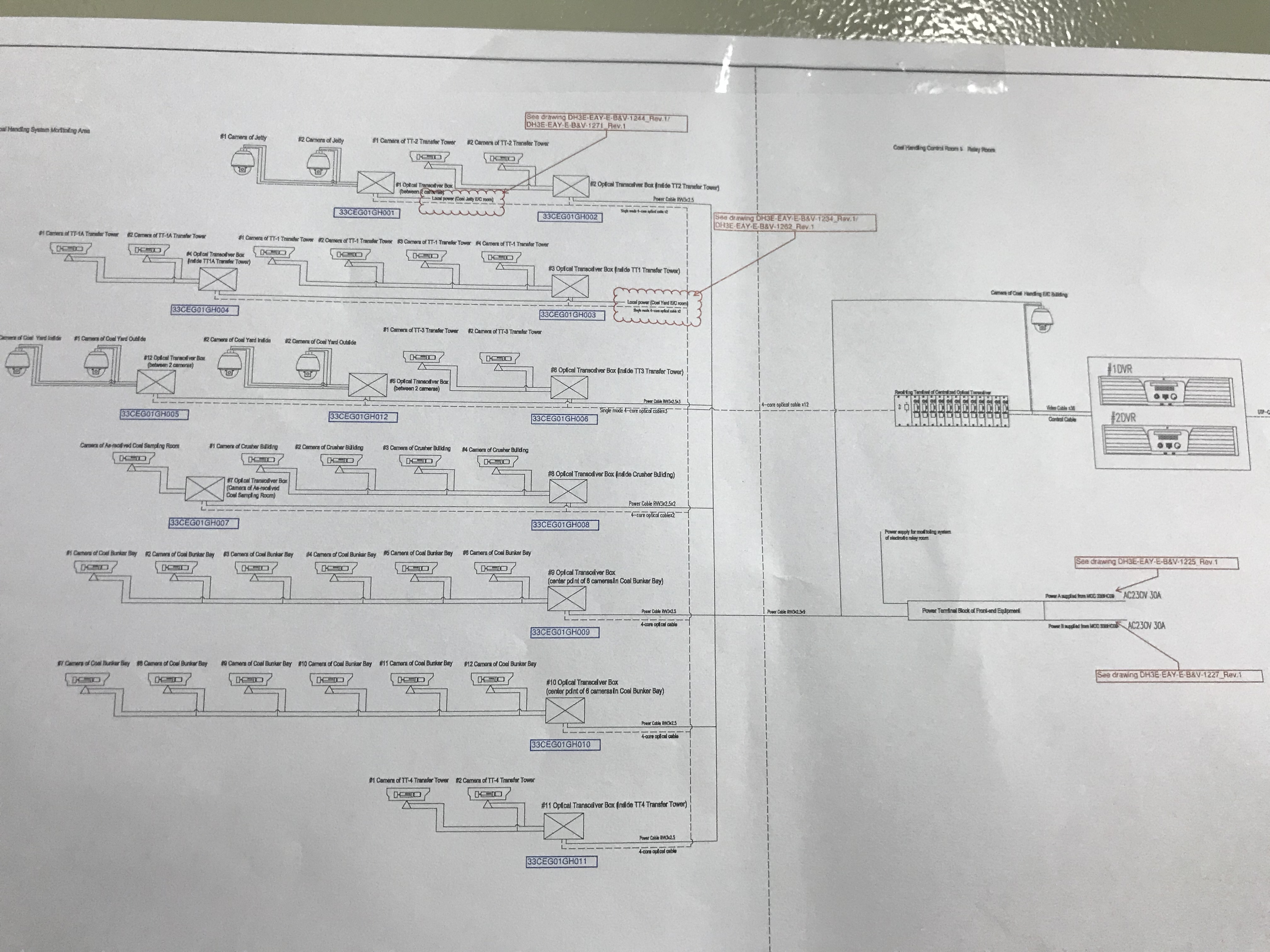

I just see DVR on the SADP table: Type DS-7224HQHI-K2 IP 192.168.1.64 Software version: V3.5.50build180106. I set my PC IP: 192.168.1.207. I can not see any camera on the list. I have gotten some solution on internet and tried but not success. As installed WinPcap_4_1_3, log in 192.168.1.64 on google chrome or IE and go to camera management but I not see any camera. Restart DVR as well not resolve.
Please give me some advice. Thanks

I'm sorry about the delays due to Christmas.
We have no experience with Hikvision's analogue DVRs and their setup, but I would anticipate that it should be very similar and you should be able to see the cameras when you access Camera Management for the DVR via Internet Explorer.
