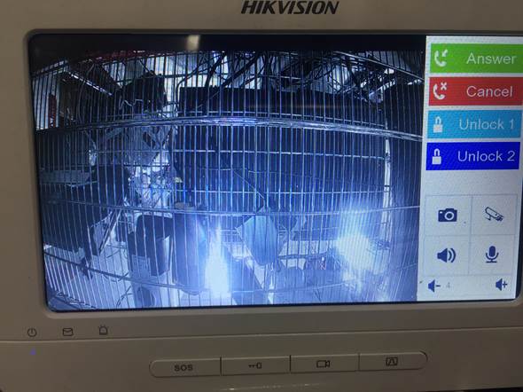

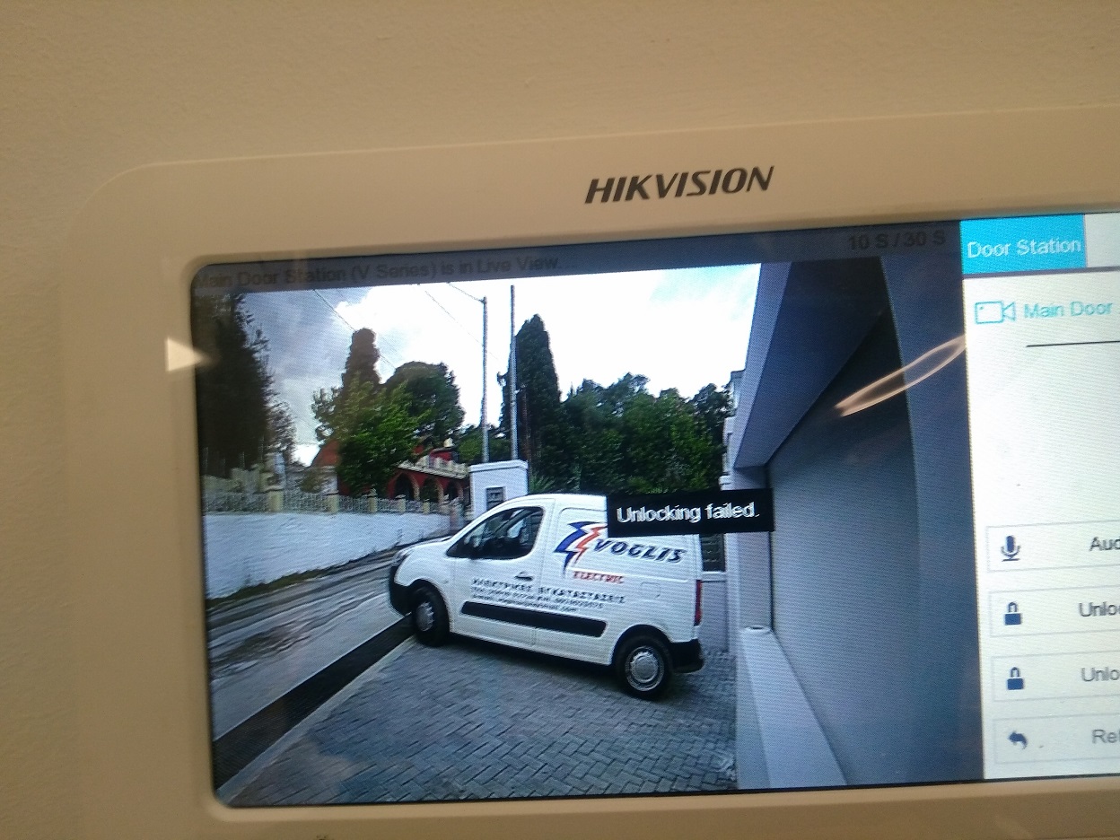

We have asked this from the local supplier and they provided as with a customized firmware for the indoor stations which provides 2 Unlock buttons at the screen, but they are not sure how to use the second unlock button. Currently When pressing the Unlock 2 button we get a message "Unlocking Failed". Pressing Unlock 1 button opens both doors at the same time.

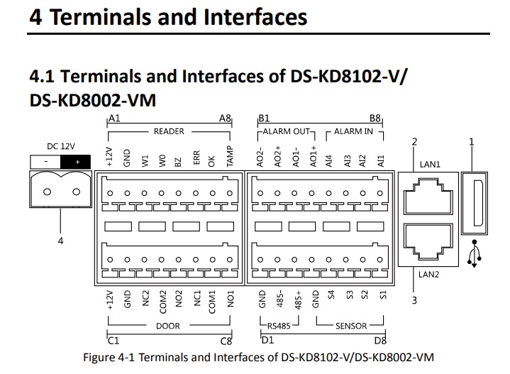

Maybe via customized software supported that, but i think (i m not sure) you must have the DS-KD8102-V/ DS-KD8002-VM to do this . I check in user manual of this model that have 2 outputs (att. file) .

Hmm, the models you suggest they indeed have multiple outputs, 4 to be exact according to the datasheet. But they have numeric keypads instead for just a calling button. This would make things complicated in our occasion for the visitor, since this is 1 villa, no need to input a code or dial a specific apartment.The customer just needs 1 calling button.
