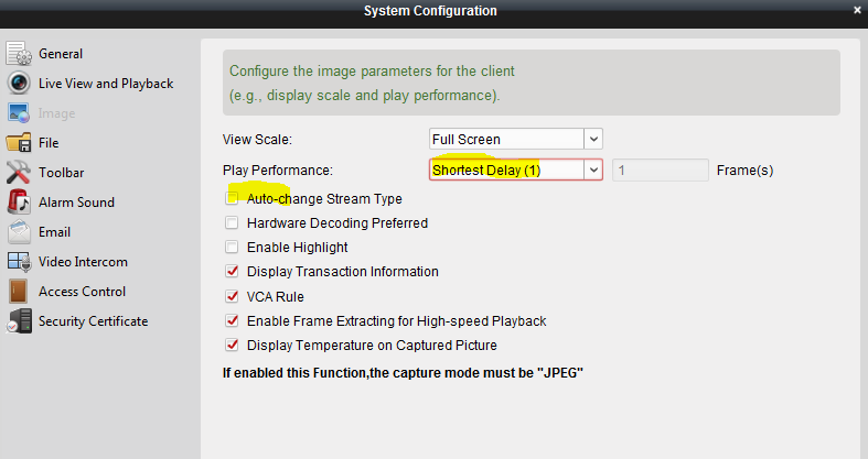

Clutching at straws, but try experiment with these settings in iVS-4200. Tool>System Configuration>Image
Thanks for your help with this, I did the above re-booted but no different. I think I'll roll back to an earlier version on ivms-4200 to see if this cures it. When I was running v2.7.0.6 it worked great apart from the annoying error message as mentioned at the beginning of this thread. I'll see if there's a version in-between the two.

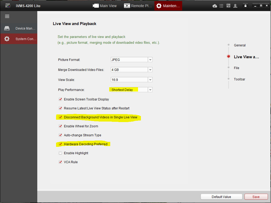

Hi,
I've also been struggling witm iVMS-4200 (v.2.x and v.3.x), it would constantly hang on start-up or randomly during use.
Swithing to their LITE version (download link below) and making a few changes (see image) helped stabilize things somewhat.
Still not perfect, but at least enough to make it usable.
