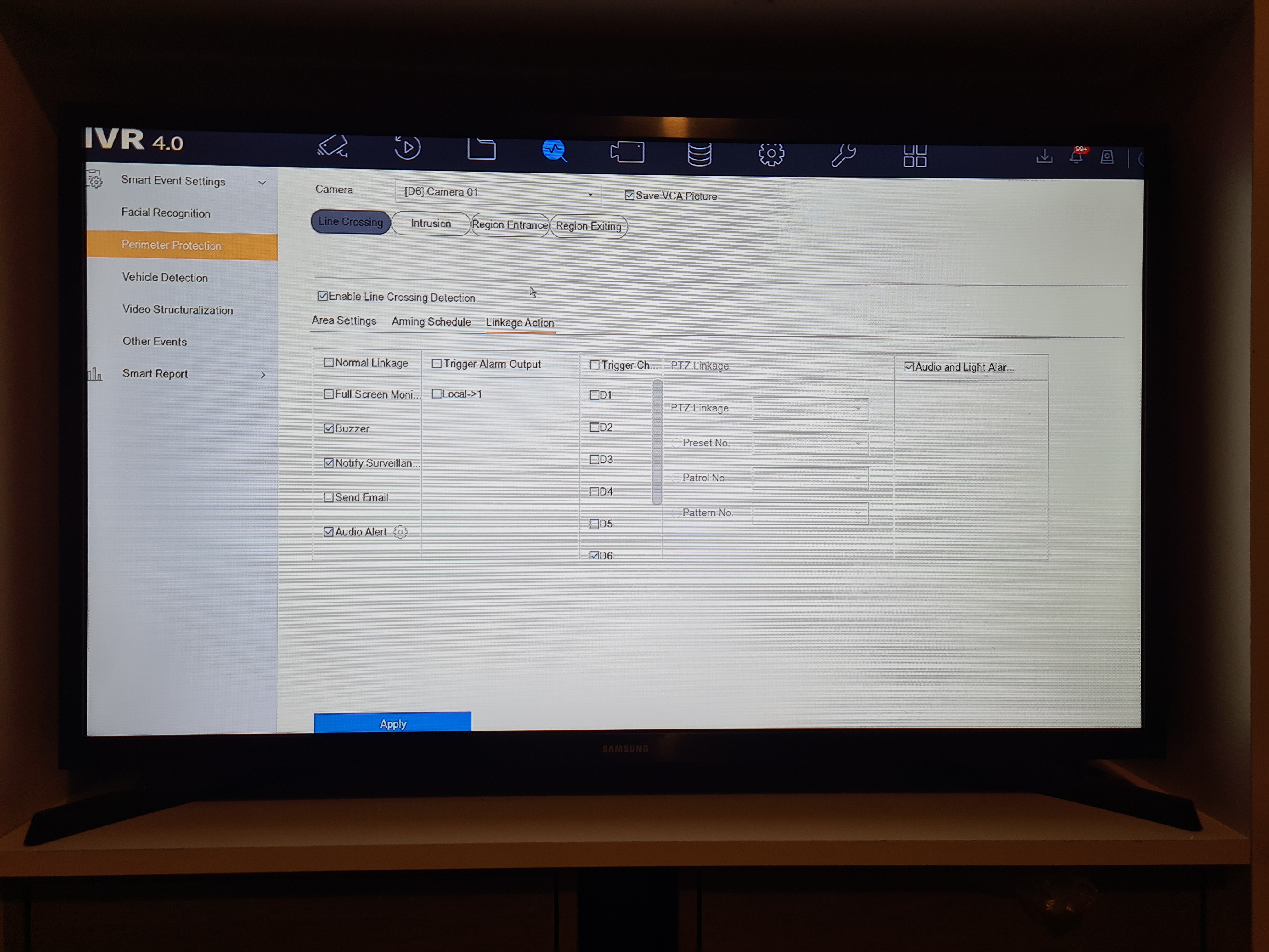

This is a screen shot. What is trigger alarm out put?
I want it to alarm at the nvr when the line is crossed like it did on my 4mp. Is everything ticked that should be?

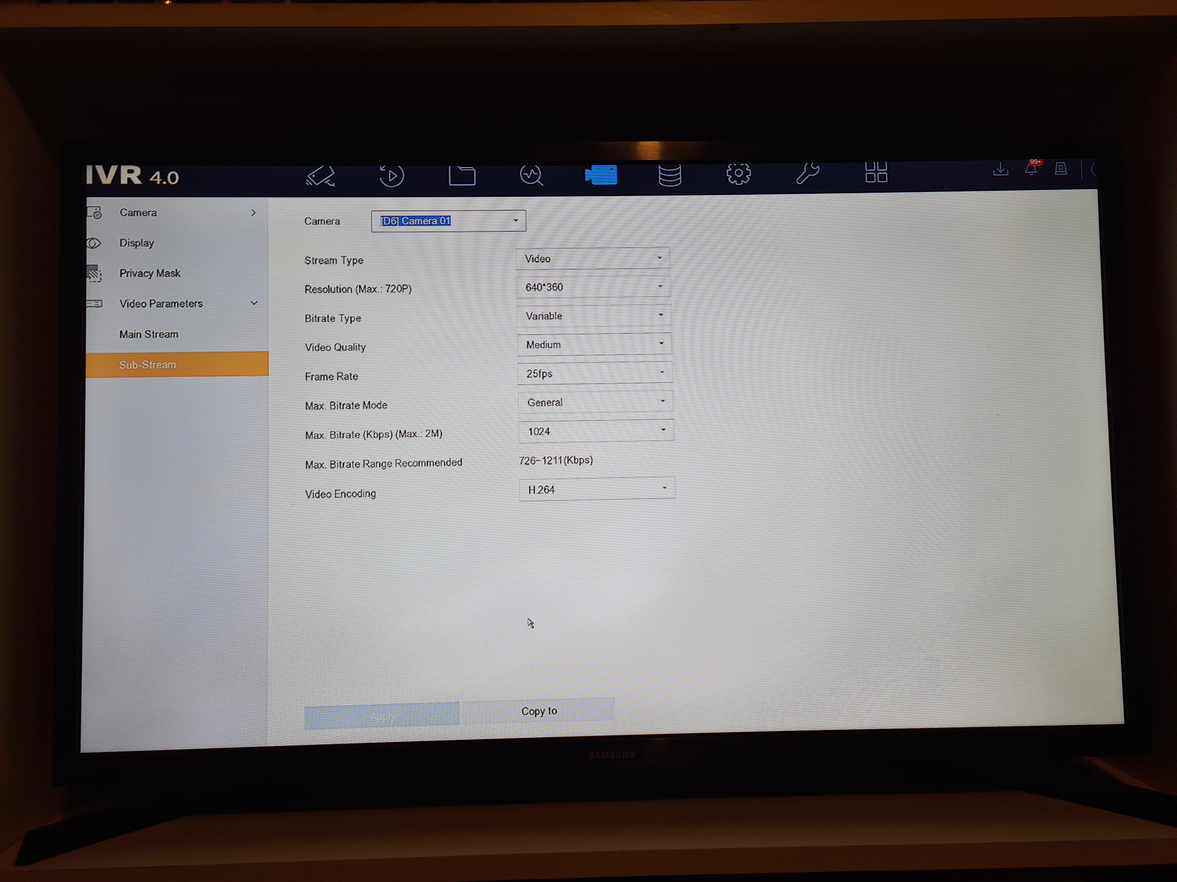

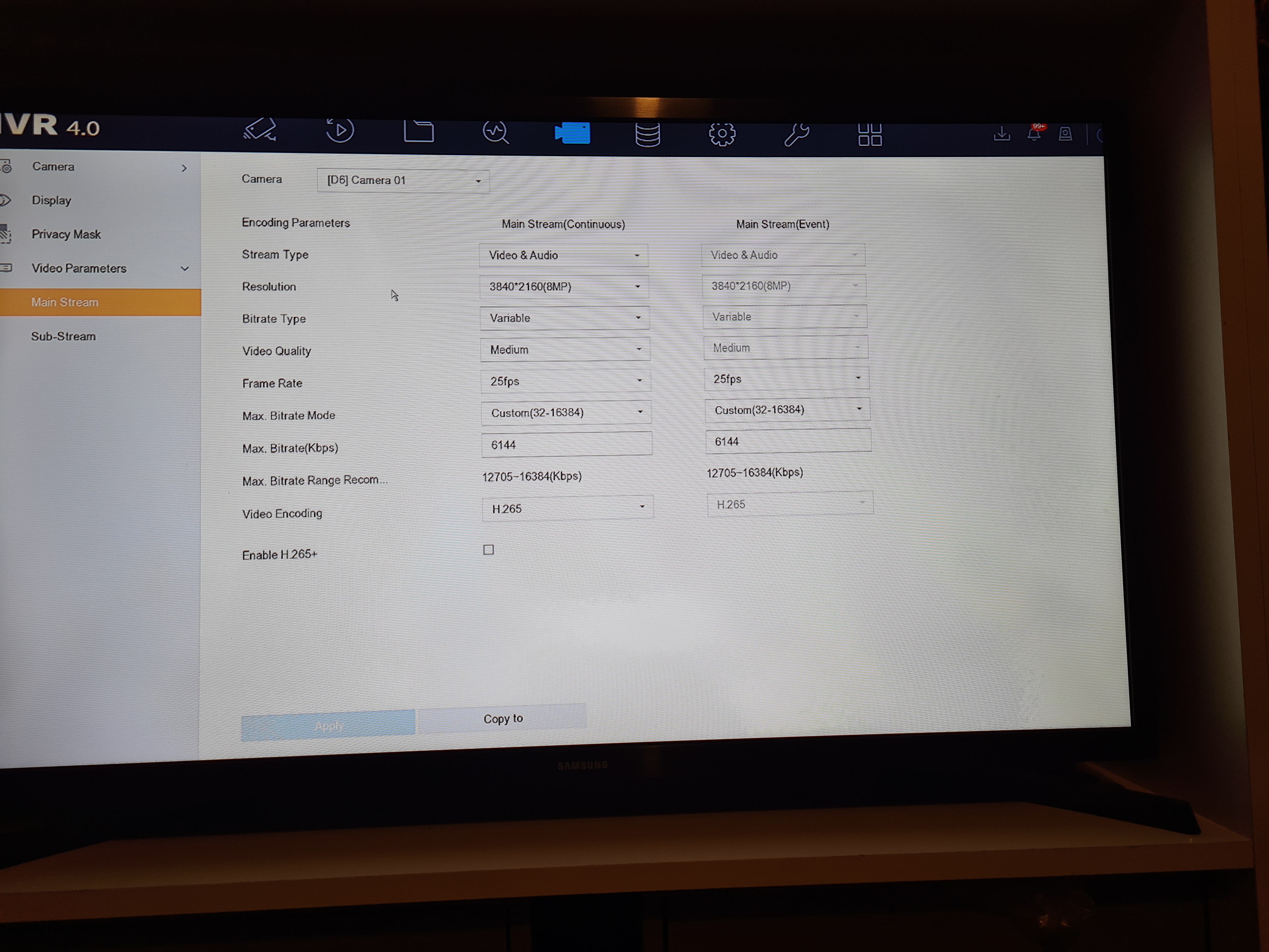

My current settings. Changed just now to 25fps from full frame.
A couple of pointers.
Sub stream is not so important as that's the SD stream that you would normally view on your mobile. However you should set it to Video and Audio, otherwise you'll have no audio when you're viewing that SD stream on your phone.
Main stream normal and main stream event should always match - which they do. However you've got the bit rate on 6144 which is below Hikvisions recommended value of 8192. From memory mine is set to 10240.
For the audible alarm at the NVR you need "Buzzer", for the HikConnect notification you need "Notify Surveillance Center" and you must have a tick in the box for the corresponding camera under "Trigger Channel" which you do. "Audio Alert" and "Audio and Light Alarm" should NOT be ticked unless you have a camera that supports it (camera model ending ISU/SL or LSU/SL)
Trigger alarm output is for if you had a light or sounder wired into output 1 of the NVR and wanted it to switch on when the event occurs.
Is the bit rate determined by the Internet then. Not by what I manually do? The only thing to note is my nvr is not plugged in to the router directly as its upstairs. It's on a wired tp link.
The bit rate you set is what the camera will attempt to utilise. It will try and produce the stream at 25fps at the resolution you set. If it cannot do that due to the amount of movement in the scene it will burst over what you set and then drop frames.
