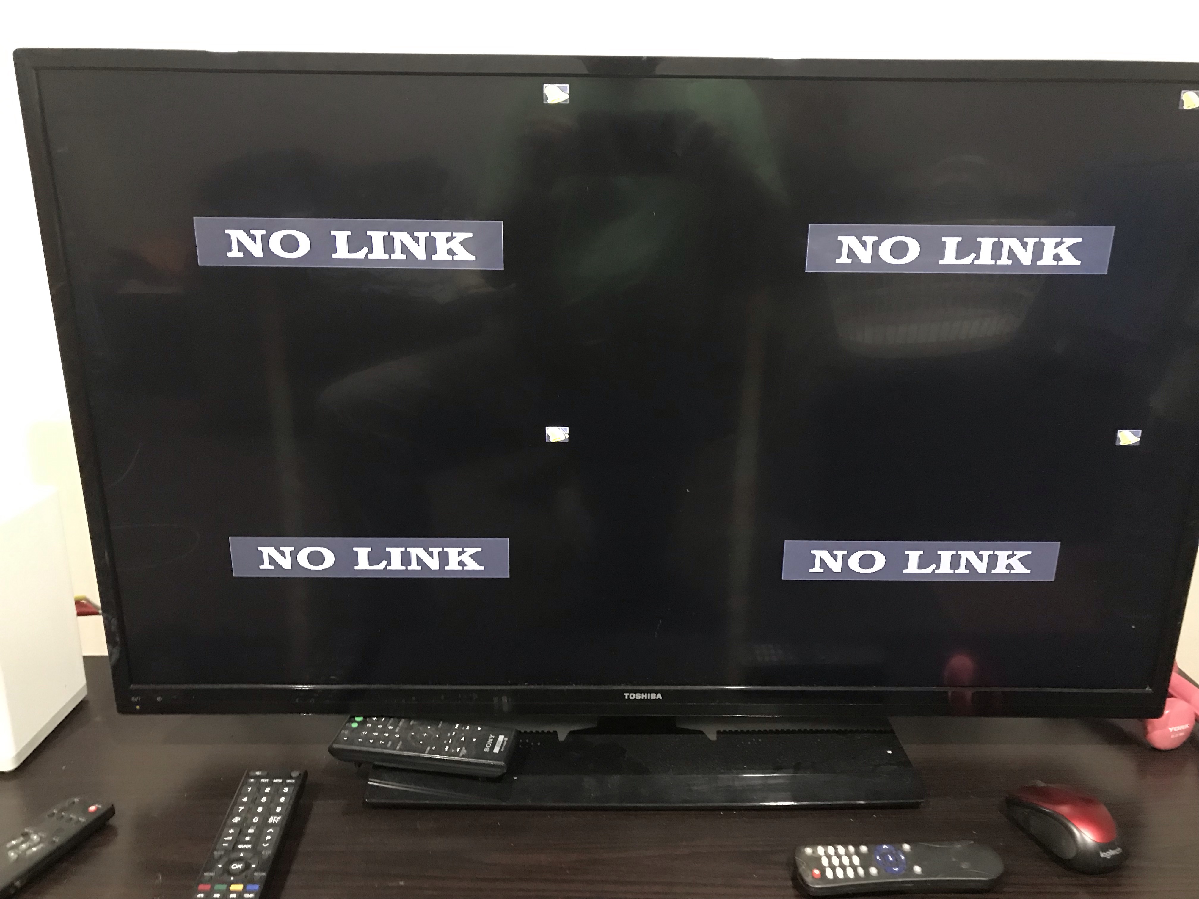

Hi Guys, I recently did a reboot of my hikvision ds-7604ni/4k nvr. Following my reboot I'm no video is being displayed, only seeing "No Link", what could be the cause? Thanks
There's no difference with either the HDMI port and serial port

NVR is a K1. Whether I have one camera or all cameras connect all ports say "No Link". The latest firmware is installed, if I'm correct it's V3.4.0

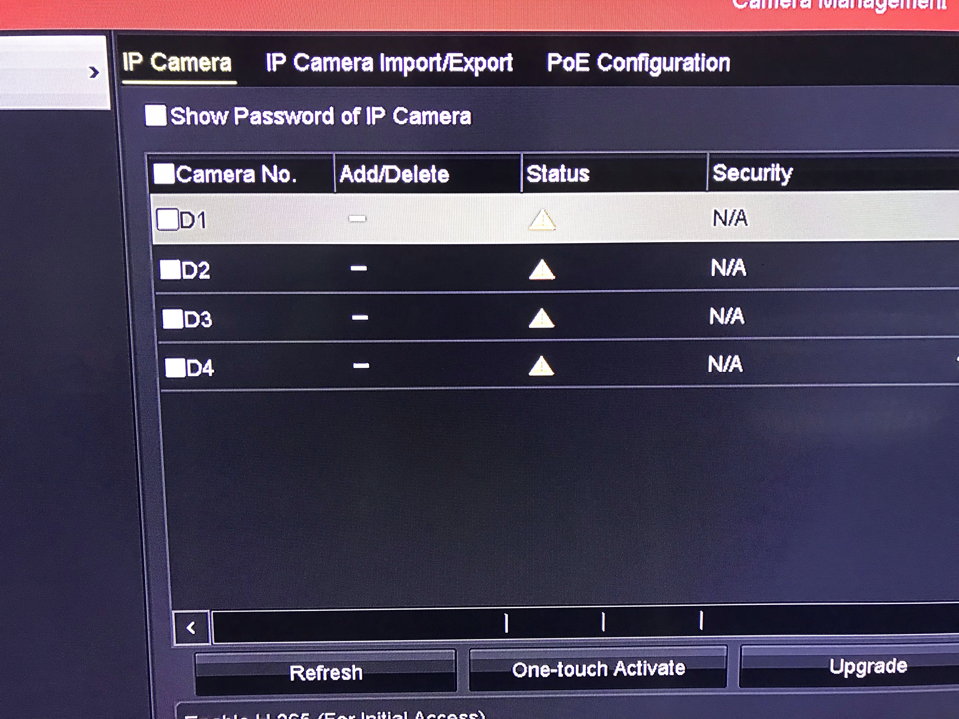

Hi Guys, Thanks, done just what the doctors ordered, firmware successfully upgraded to V3.4.103 but still showing "No Link". On the rear of the NVR all camera ports appear to have activity as both the green and yellow lights flicker. When I click on camera in menu then remove the camera cables from the ports, re-instate them it show "detecting" then nothing. There's the yellow triangular symbol in the Status column.
Any help is appreciated.

When I remove the HDMI cable then the monitor goes blank so there's obviously connectivity between nvr and monitor
