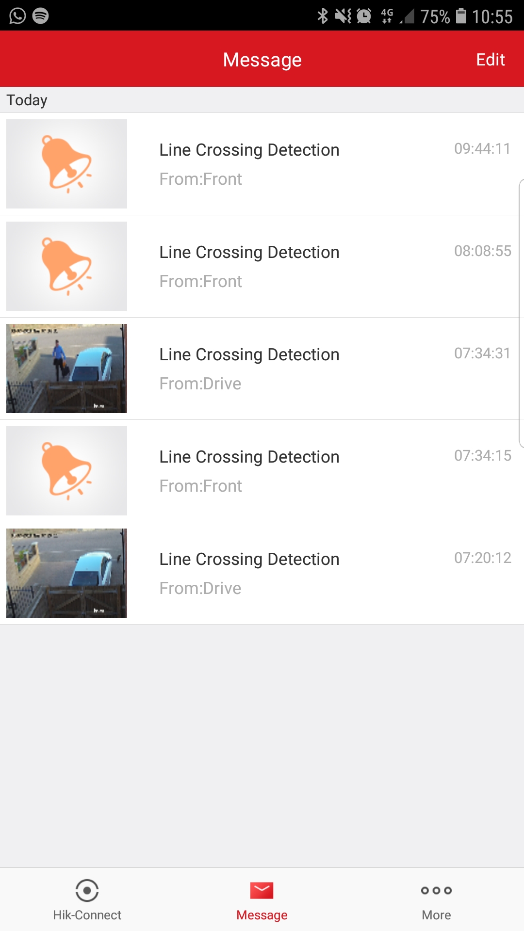

So I changed the digest settings for all cameras but it made no difference. Image attached for reference, any ideas anyone?
