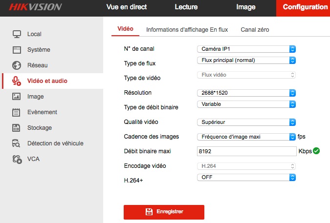

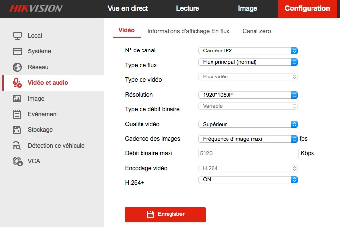

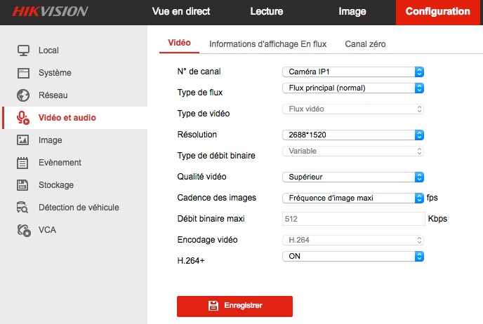

It sounds like you might need to increase the bitrate settings of your camera. They may be too low for the amount of motion in the scene, causing the camera to overcompress the image to meet the bandwidth limitation.
Could you post a screenshot of your video settings?
Sorry but it is the first time for me with a video LAN setup ...

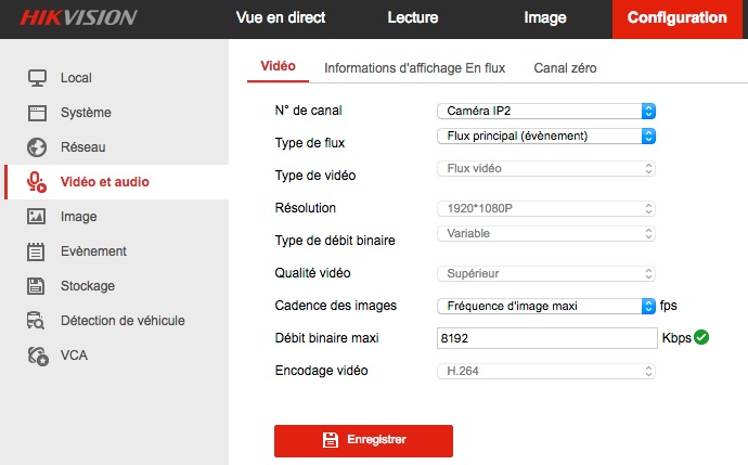

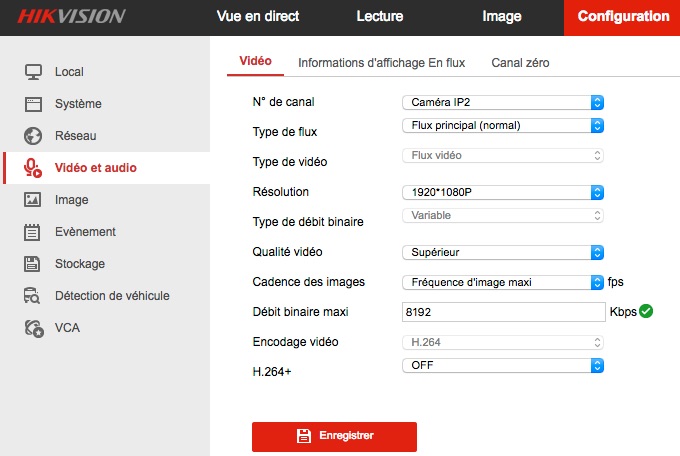

Here are two printscreen of the video setup of my configuration screens.

For a test, would you please disable H.264+ encoding on both cameras, and increase the variable bitrate maximum to 8192kbps?
Make sure you double-check that the Main Stream (Event) settings (Type de flux) also have the same settings as the main stream for now. These settings ordinarily come into effect when an event is triggered on the camera such as motion detection, but for now it'd be best if they weren't lowering the camera's bitrate when motion is detected etc.
I changed what you said. It seems that the image quality is better but I have an horrible lag !
I takes forever to connect, then I have the first image of the two camera and then it doesn't actualise.
I took 2 printscreens each times because I have 3 choices for each camera:
Main Stream (Normal)
Second Stream
Main Stream (Event)
You have a printscreen of the 2 Main Stream options.
