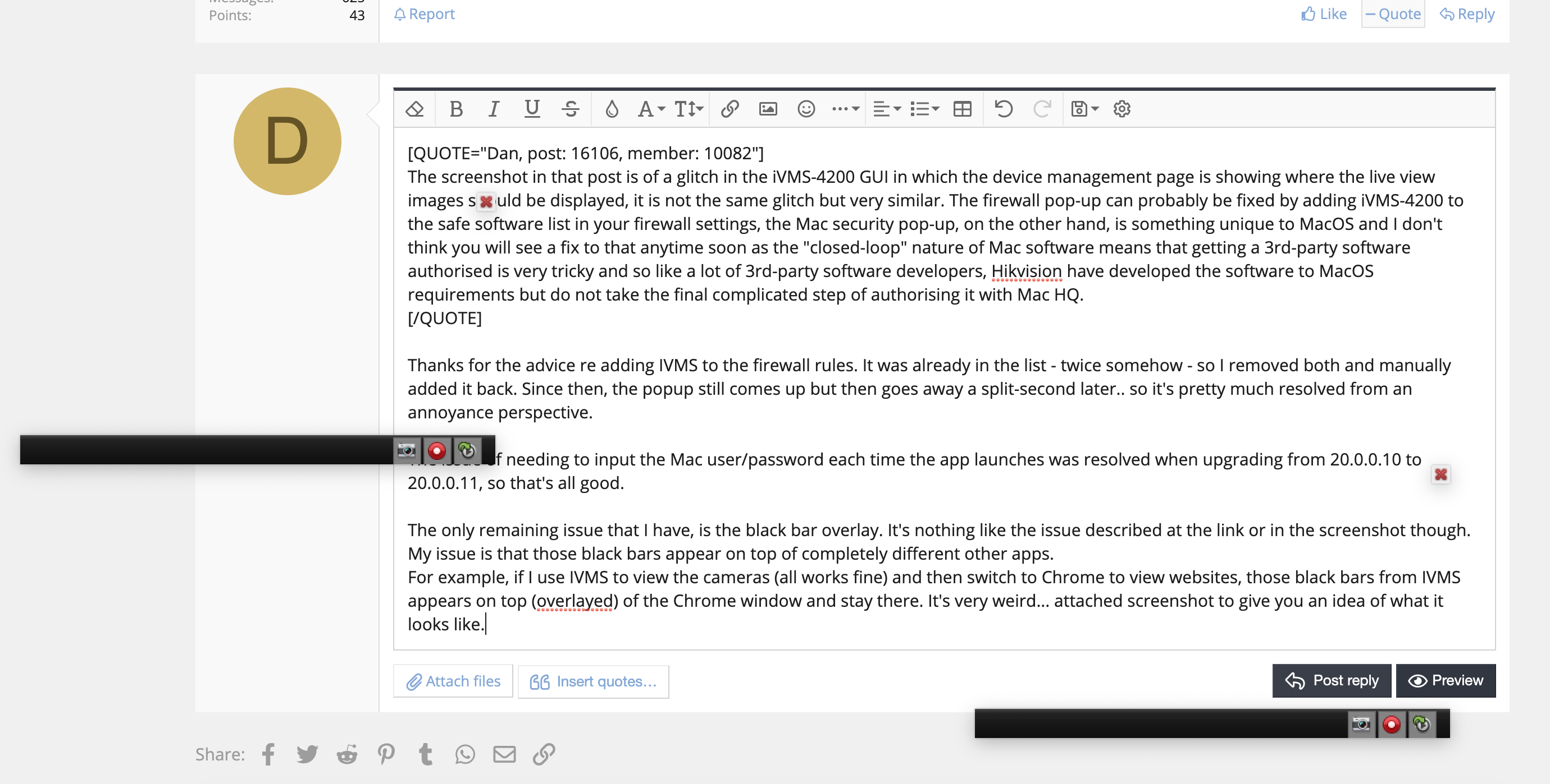

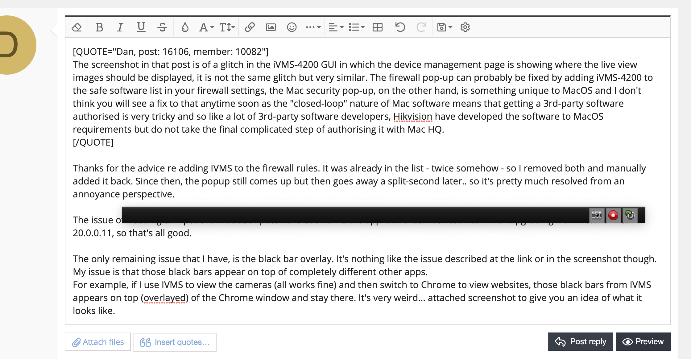

Further to that, I often find that when live view is open with various cameras displayed, some of the black bars (with the buttons for Capture/Start Recording/Switch To Instant Playback) manages to overlay itself over other apps/windows. This has been the case since I upgraded from the previous version, to 2.0.0.10.

Thanks for the feedback Dan. The issue doesn't happen with any other apps, and only started occuring after updating to 2.0.0.10 (and still present in 2.0.0.11) - so my feeling is that it may be more related to IVMS than anything else. Open to all suggestions for fixes/troubleshooting though.
That link that you posted didn't seem to relate to these 2 issues of the black bar overlays or the firewall popup - unless I missed something in that thread? To be clear, there is no loss of images/streams - all camera views are fine in the app.

The only remaining issue that I have, is the black bar overlay. It's nothing like the issue described at the link or in the screenshot though. My issue is that those black bars appear on top of completely different other apps.
For example, if I use IVMS to view the cameras (all works fine) and then switch (CMD+Tab) to Chrome to view websites, those black bars from IVMS appears on top (overlayed) of the Chrome window and stay there. It's very weird... attached screenshot to give you an idea of what it looks like. I alt-tab'd from IVMS to Chrome to reproduce the issue.
