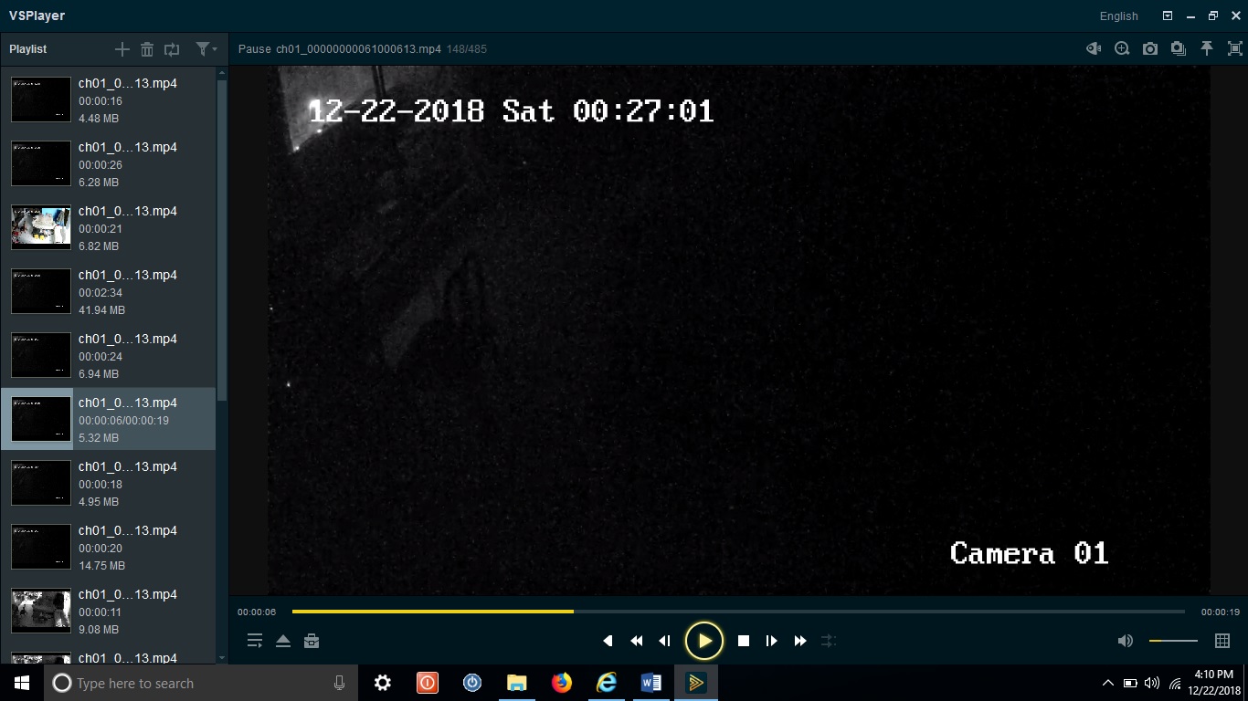

Hi guys I need your help, I upgrade to latest firmware on my -[2.8mm] Hikvision DS-2CD2542FWD-IWS 4MP Built-in Mic Wifi indoor Dome Camera , after this NIGHT VISION is completely not working at all. Please let me know is this HARDWARE ISSUE of FIRMWARE ISSUE.

Please have a look in Photo.
1--yes I did Factory Reset whole Camera, as well SOFT FACTORY RESET & HARD FACTORY RESET, this does not fix my issue.
Please help me to get back my NIGHT VISION, I already tried many things none of them fix my Camera.

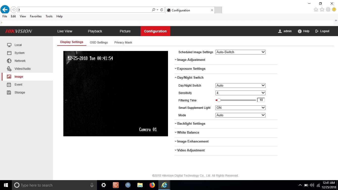

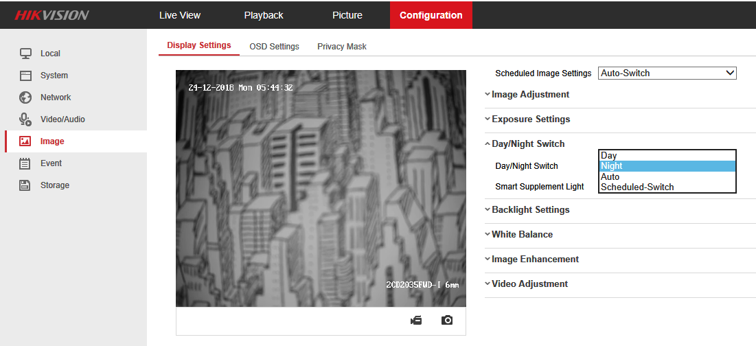

Test whether your camera's IR LEDs are actually still working - switch between day / night settings here:
(night should illuminate the IR LED's and force the camera into monochrome)
That light source in your scene will not help your eventual image.
It looks like you are using a wireless laptop for your latest update - try again with a wired connection to your network.
Although, we would recommend that you use the latest firmware, and - nobody else is reporting this 'no IR' problem with this firmware update.

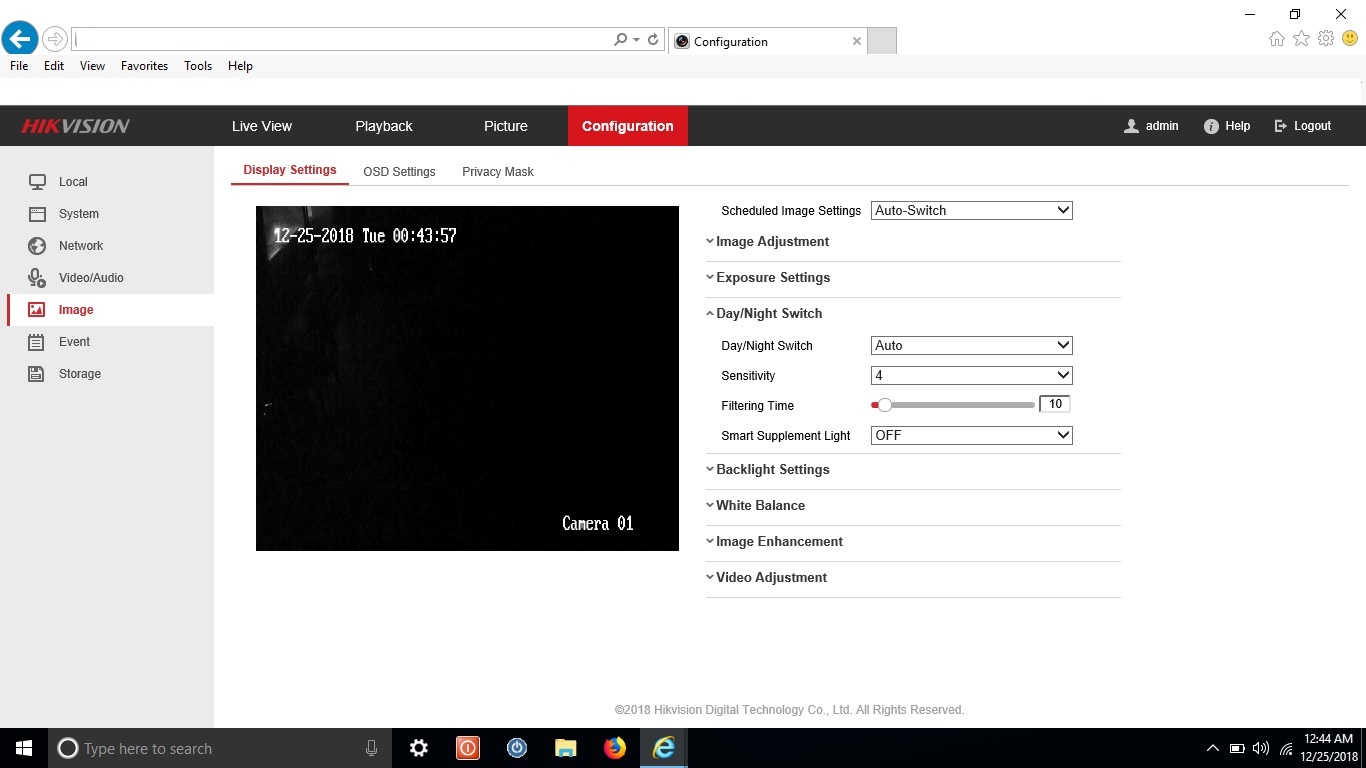

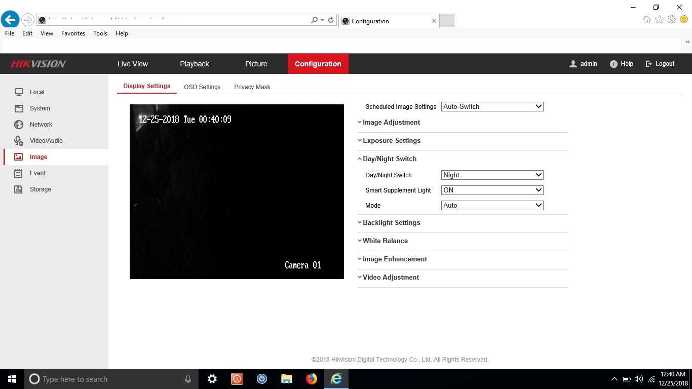

I tested to see if night vision is working with the above setting "Night" I select, after this I can see BLACK & WHITE Picture, but the problem I am having is that when there is very little light in the environment, the video that is being recorded or when I look at the live view, the picture is GRAINY and the video is filled with little dots and makes it hard to see the picture. How am I able to fix this problem?

From the images that you have posted it looks as if your IR LEDs are not illuminating - can you see them lit/glowing red when you select night mode?
If not, I can only assume that the IR LEDs have failed.
In which case you will need to return the camera to your supplier (assuming it is under warranty).
If it is out of warranty, it can be repaired, but it is often not cost-effective to pay for a repair (better to purchase a new camera / newer model / with a new full 3 year warranty).
