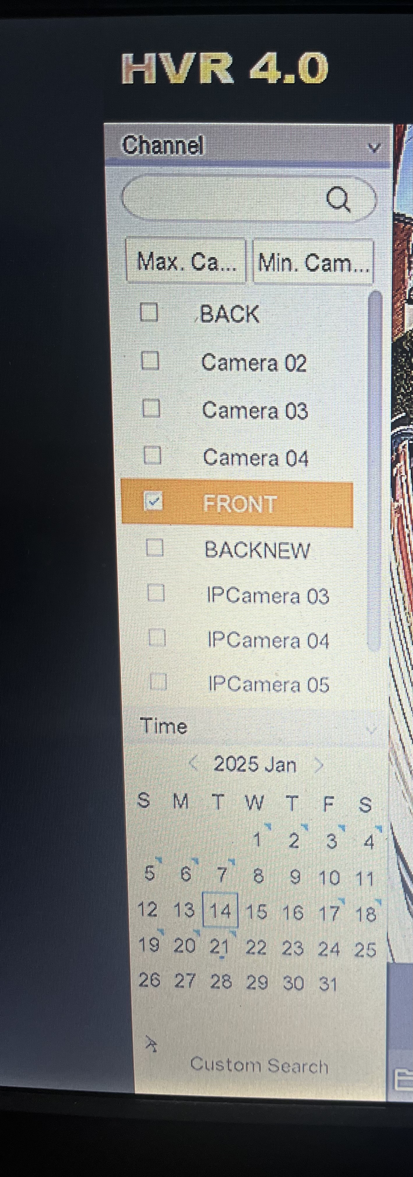

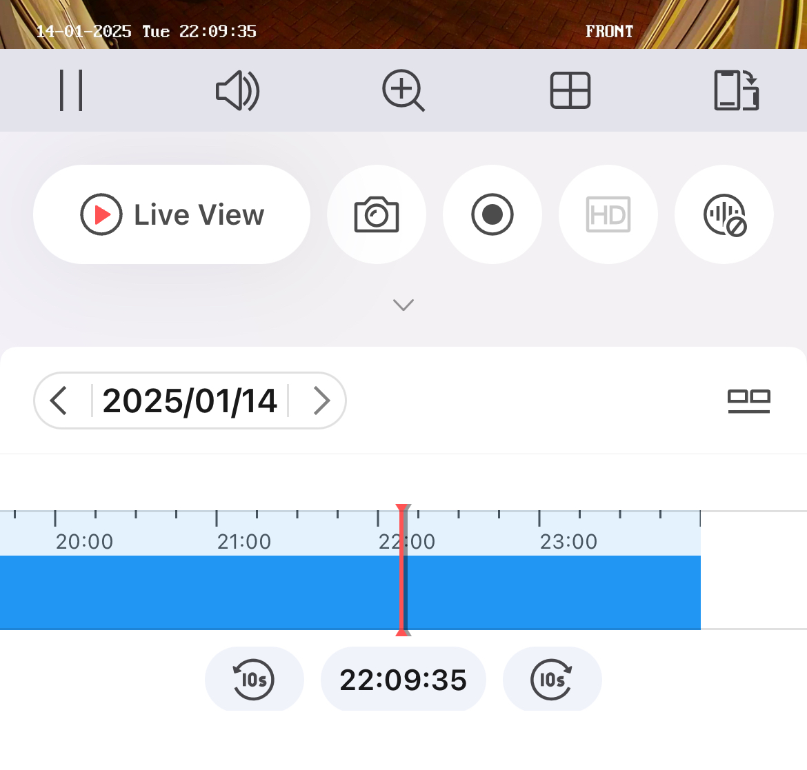

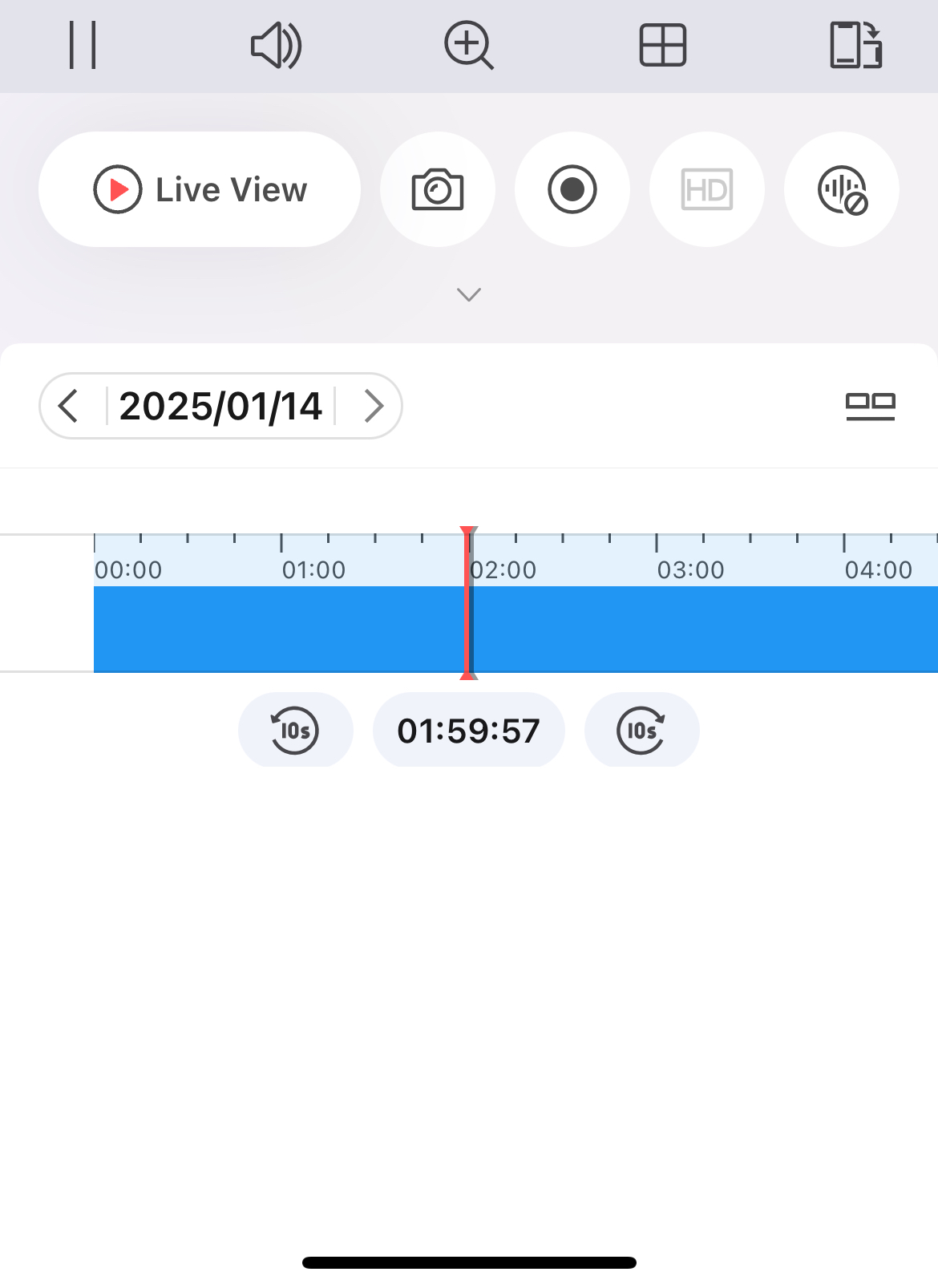

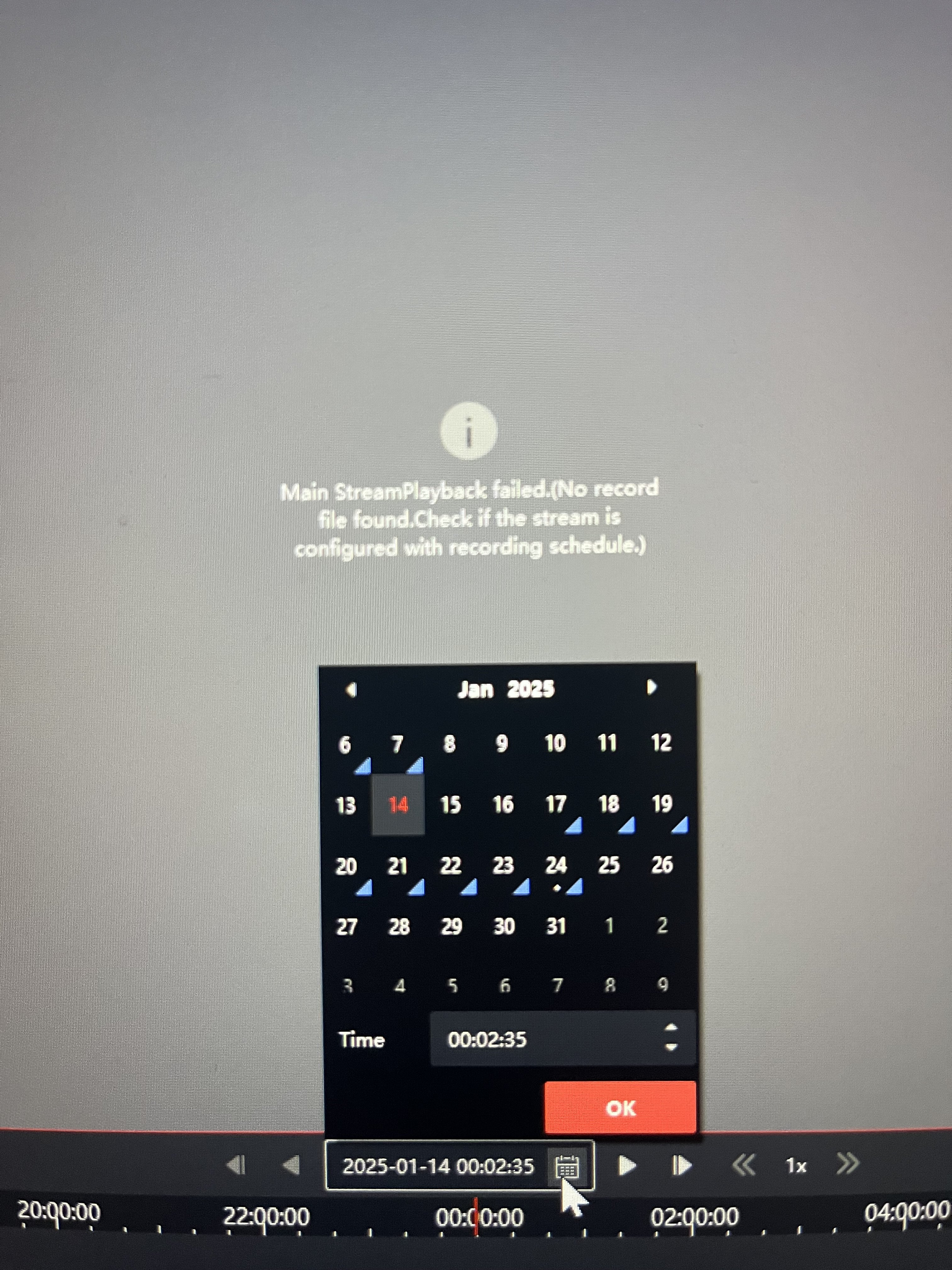

So I go to the DVR and playback then select the 14th Jan and it says no file found? Some days have like a little blue triangle in the corner but others don’t including the 14th?
I go to the 14th on the hik-connect app but no way of speeding the footage up?

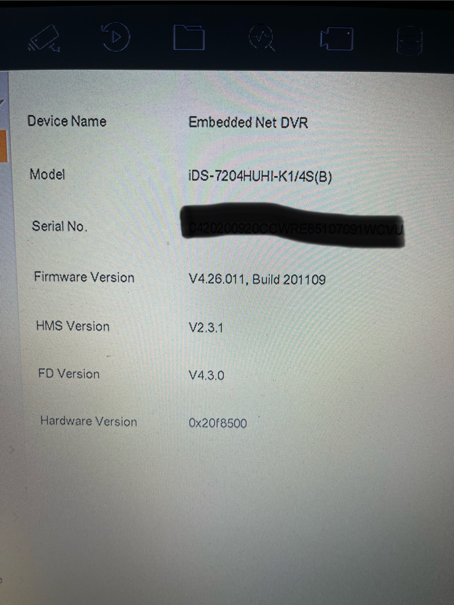

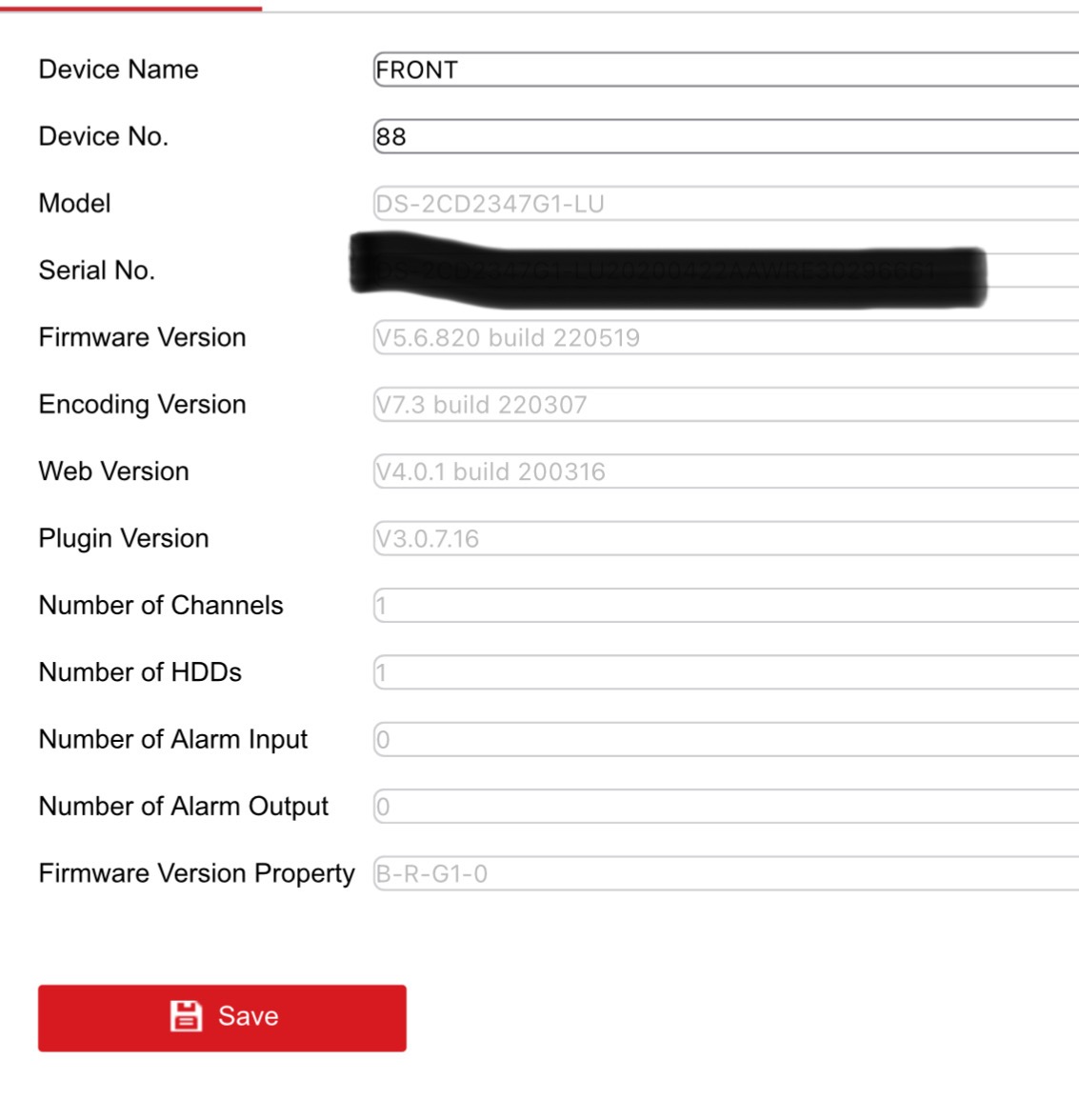

I have attached the screenshots for DVR and camera for the firmware.

Thanks, it looks like the camera firmware is up-to-date, so I'd check that their time is in sync with the NVR too.

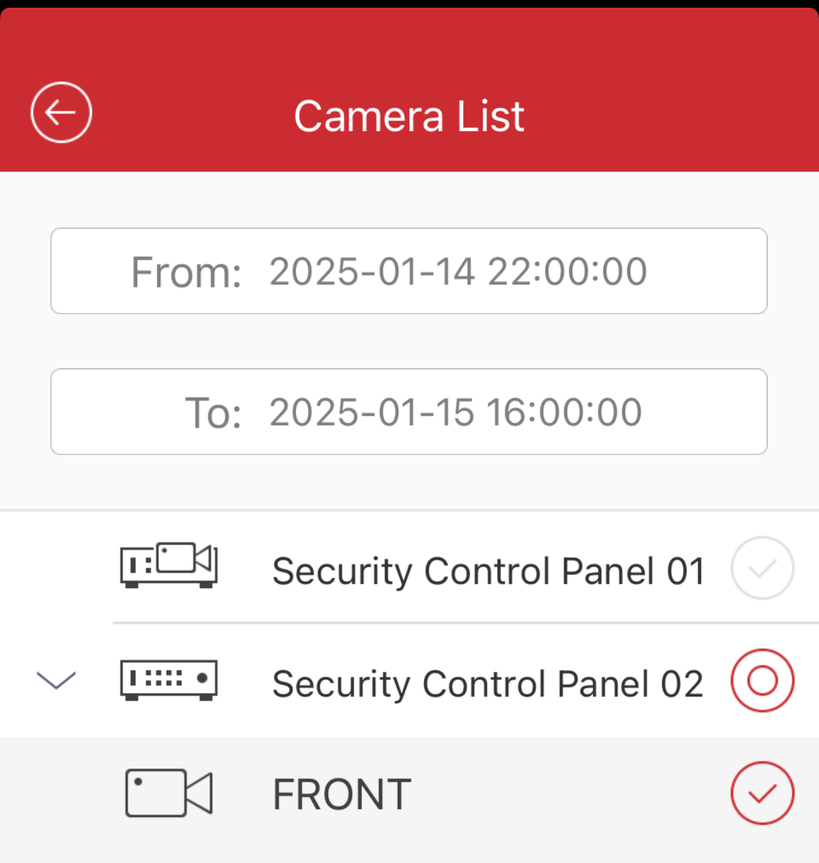

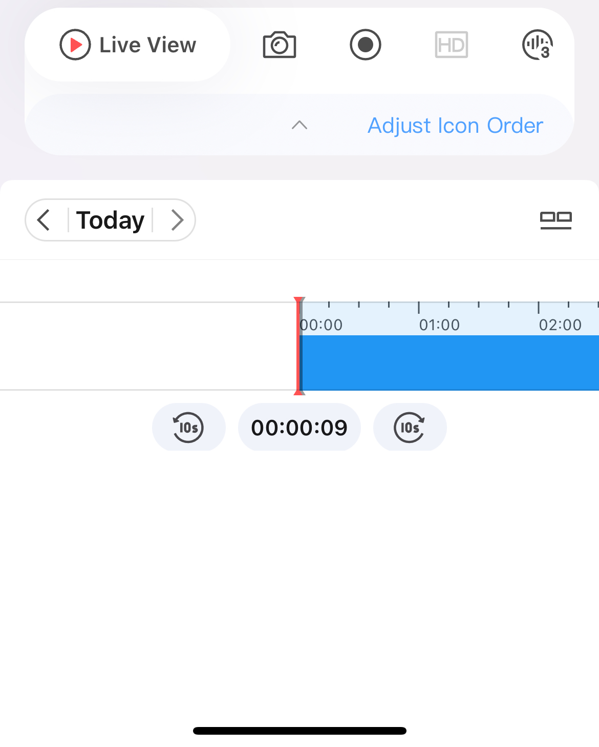

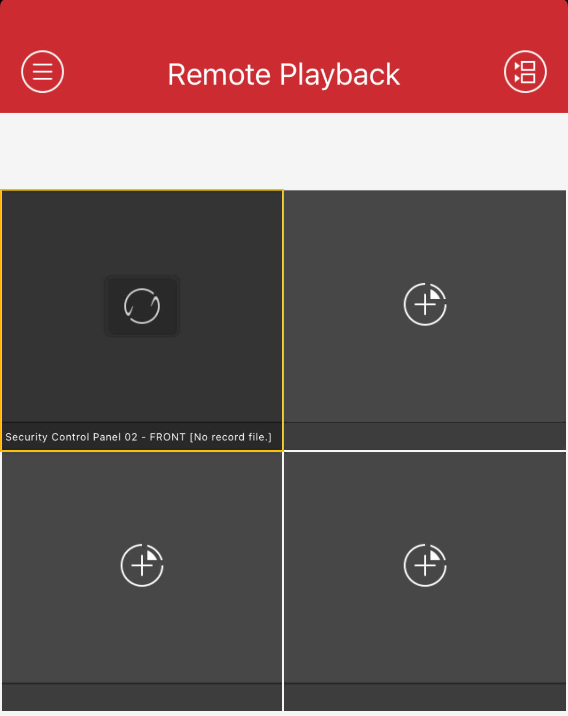

So from iVMS I get the same behaviour where the file cannot be found? I will attach screenshots of both. iVMS and Hik-connect. A separate question but should I not see an extra button in hik-connect for speeding up and slowing down footage?

That looks like the iVMS-4500 mobile app - can you try iVMS-4200 on a PC?

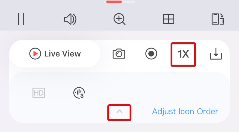

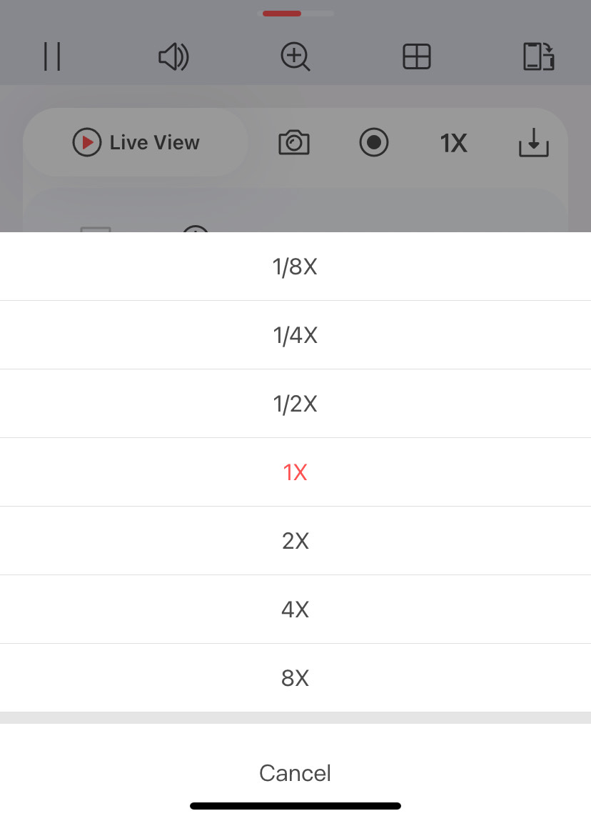

Yes, you should be able to adjust the playback speed in Hik-Connect by pressing the "1X" button - you may need to use the arrow to expand the icon menu:
Thanks. I have looked at the time and all the same. The hik-connect app is missing the playback speed button? I am on an iPhone with the latest iOS and the app is upto date.
I have installed the windows app iVMS 4200 but it is still the same with no file found?
I will upload some screenshots.

OK, unfortunately, I guess not having the option to adjust the playback speed in the app is a limitation of your DVR. We've seen similar cases where cameras and NVRs have different options in Hik-Connect.

Go to HDD settings and do Rebuild database, it will work afterwards
