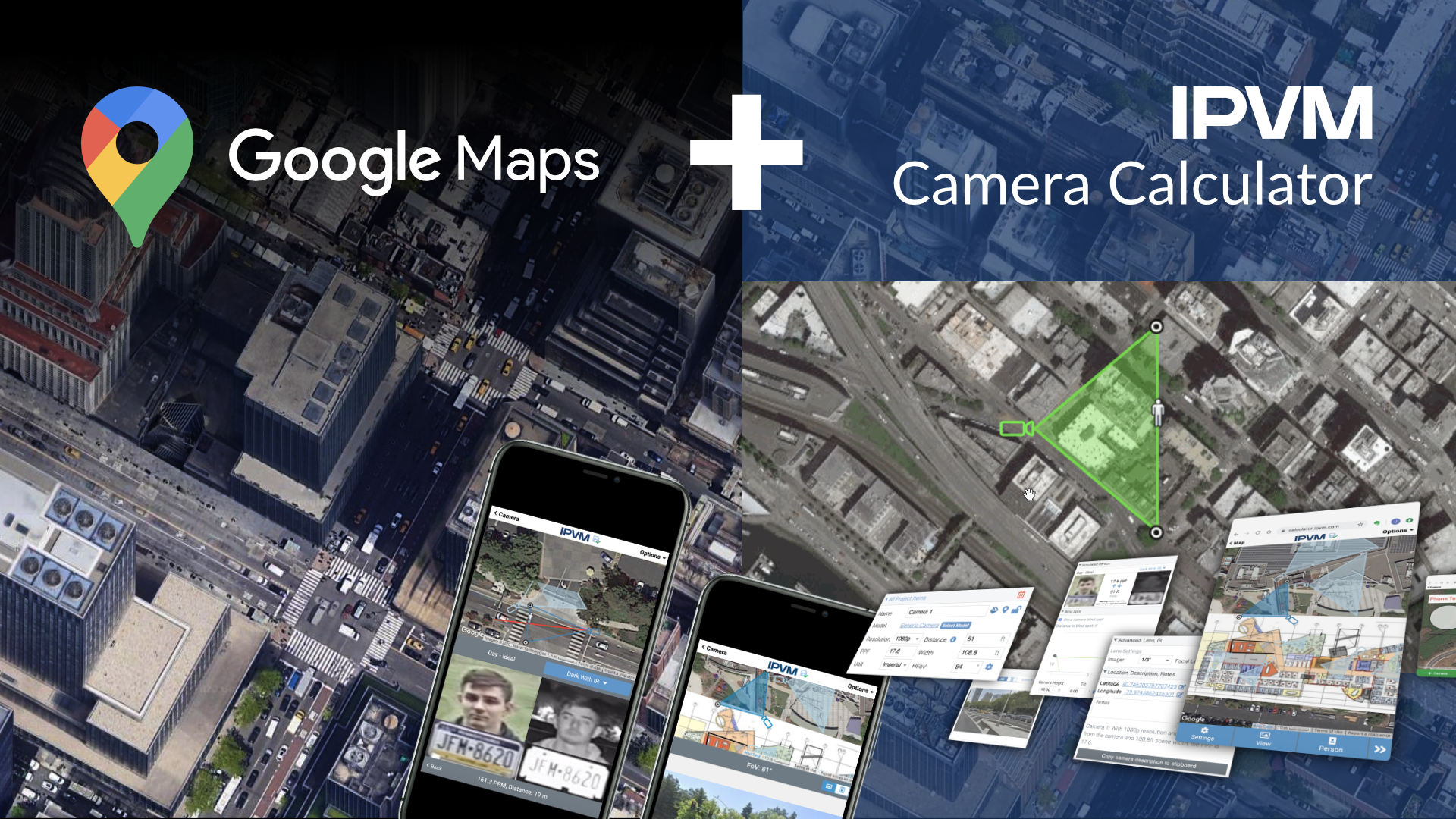

This camera calculator is also great for this, as you can find your property in Google Maps and situate your chosen cameras/focal lengths around it to see the coverage they offer:
