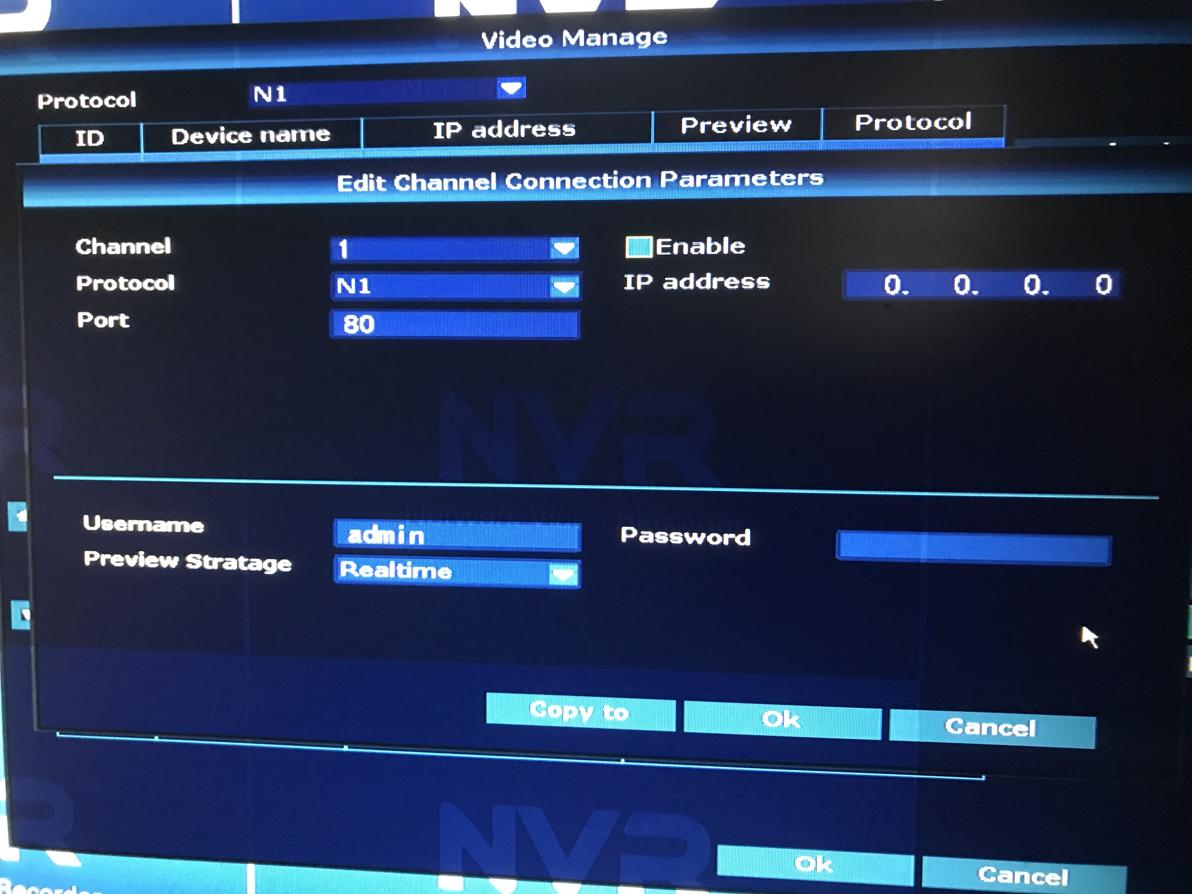

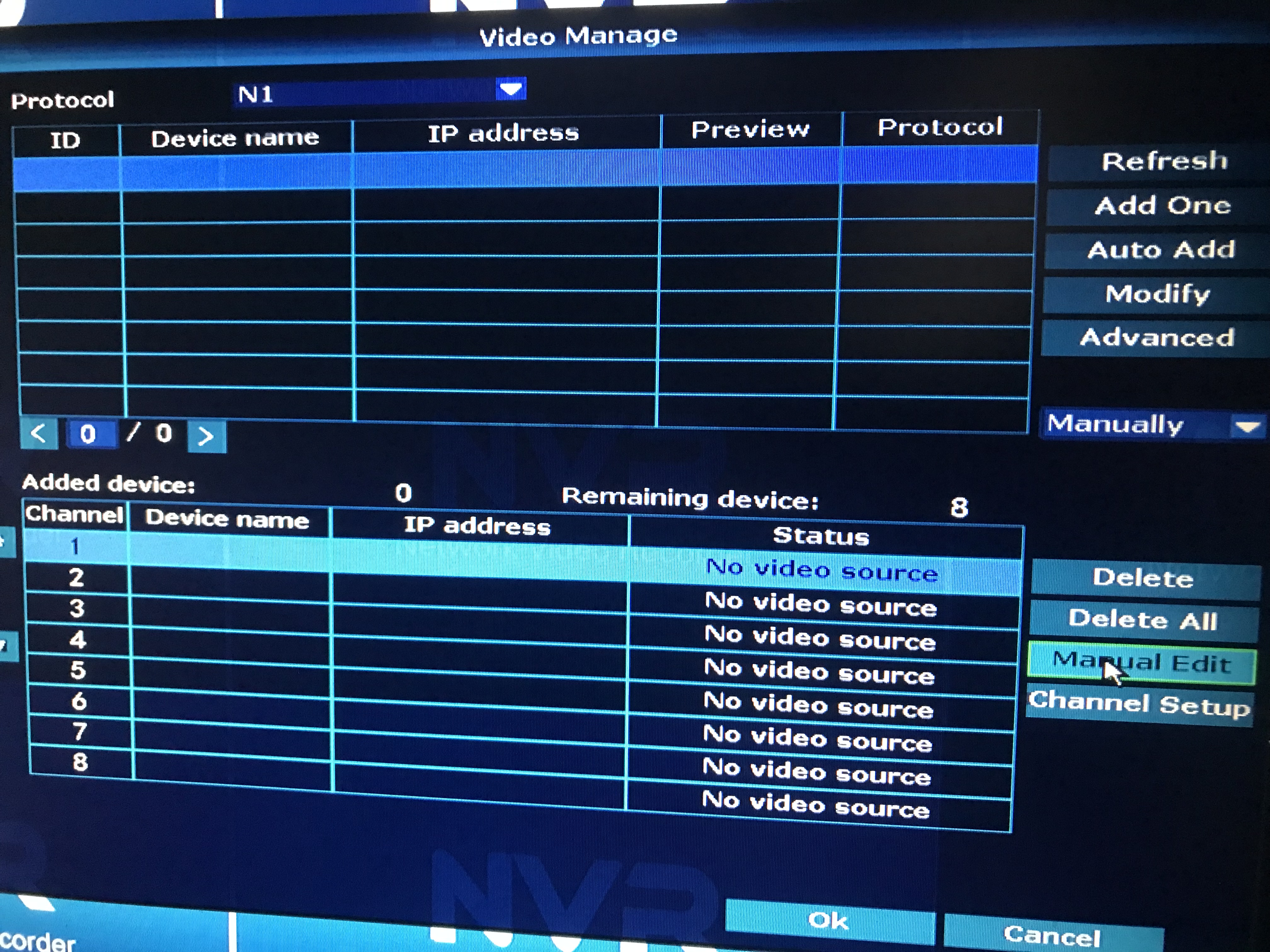

So on the video manage page, when I hit refresh it won’t detect any cameras.
When I try to add one manually, I have no idea what IP address to use.
Would anyone have any tips?

I did the factory reset which deleted the cameras off the dvr, and now it won’t recognise them at all.
Even when you search for them it doesn’t show them.

When I first connected them they didn’t work, but on the photo I attached at the start, when you click add one, it enabled the camera and they just worked.
I can’t seem to get the dvr to find the camera.

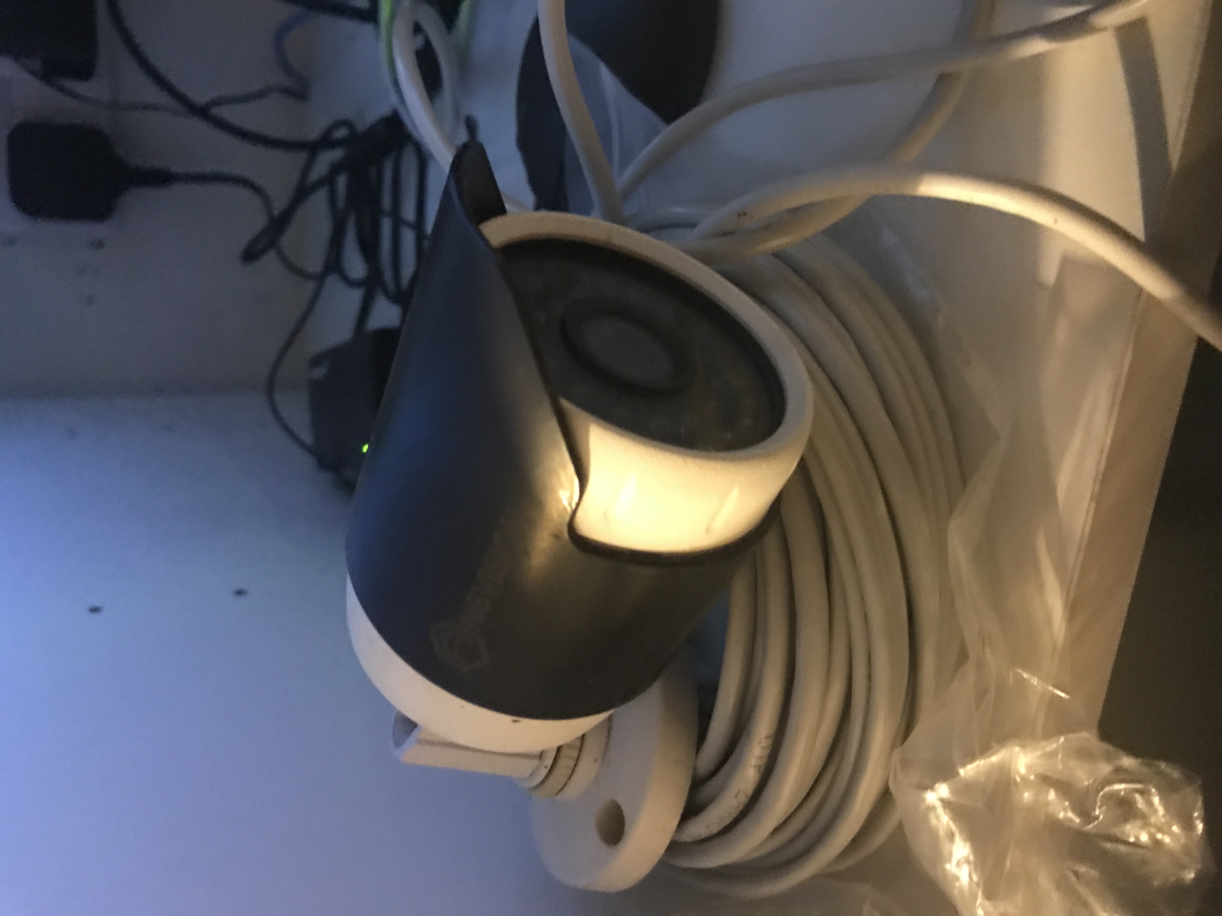

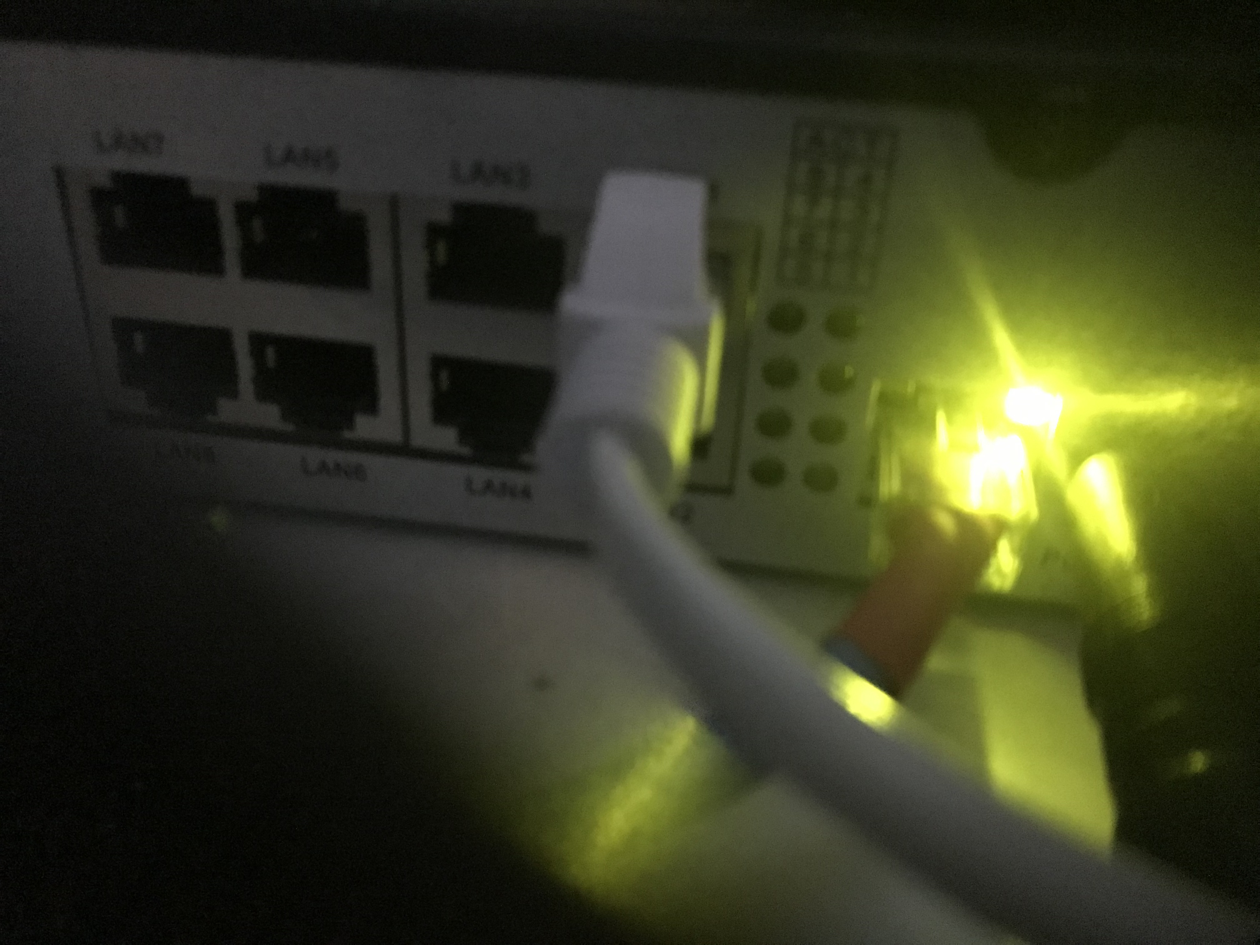

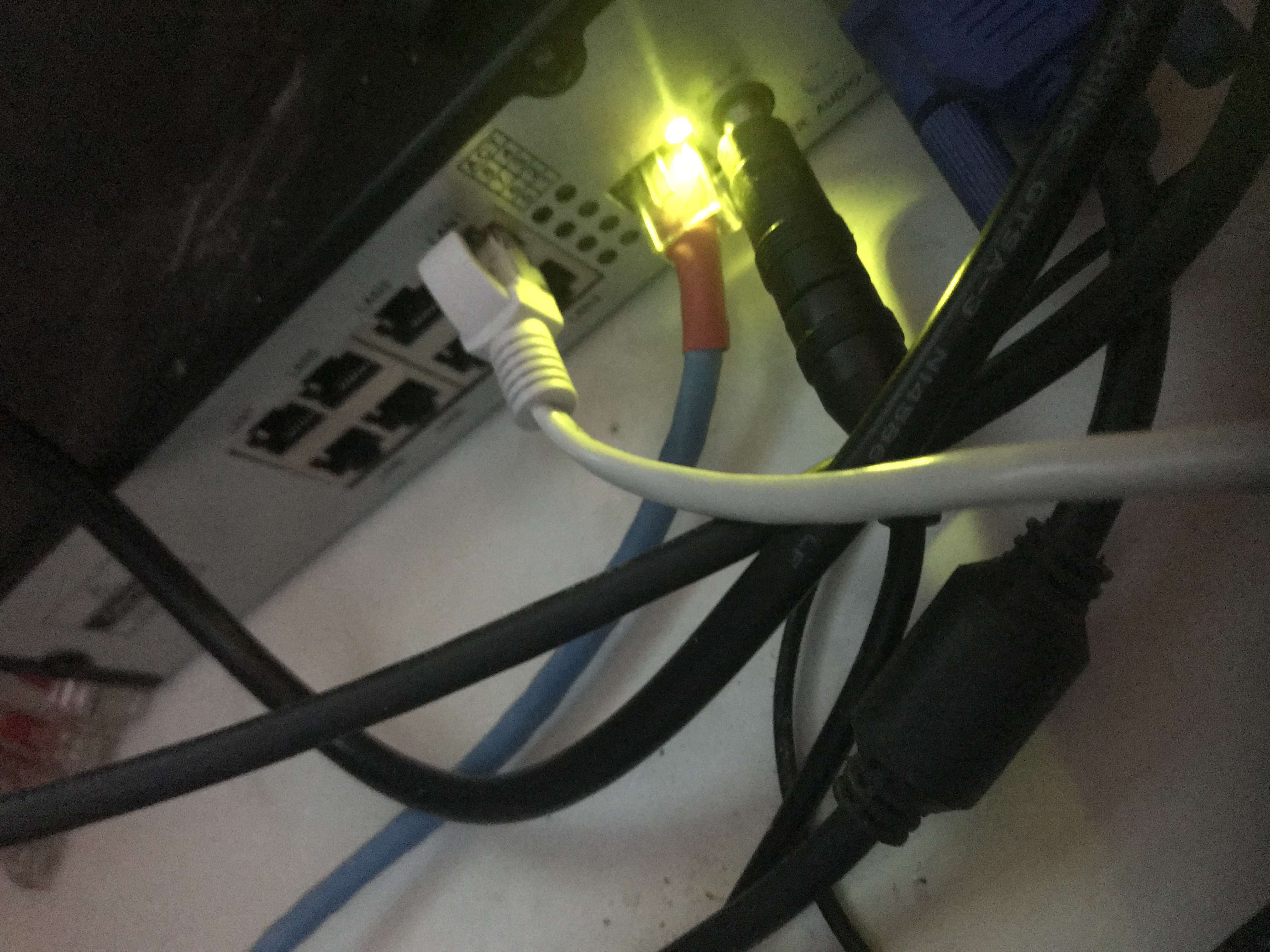

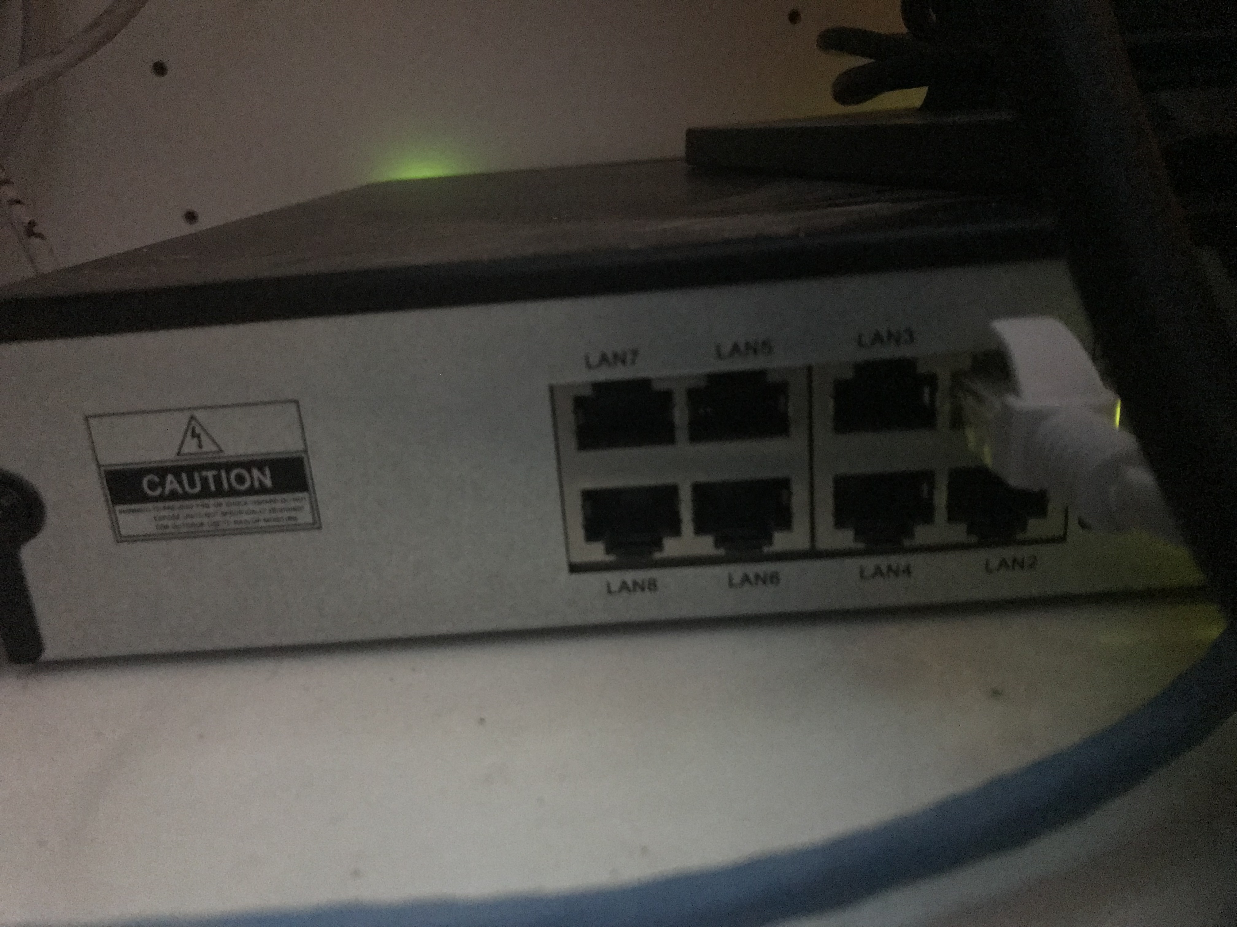

So I have removed one camera, and brought it to the dvr with a short cat 6 cable.
There are no lights at the port, and there is no power to the camera.
It seems that there is no power out from the ports.
I have tried the camera each port. No lights at the back for each port, and no change with any selection.
It’s like the power has been turned off internally.
See attached photos.
The camera has ANBVISION stamped on the side of the cover.
Any ideas?

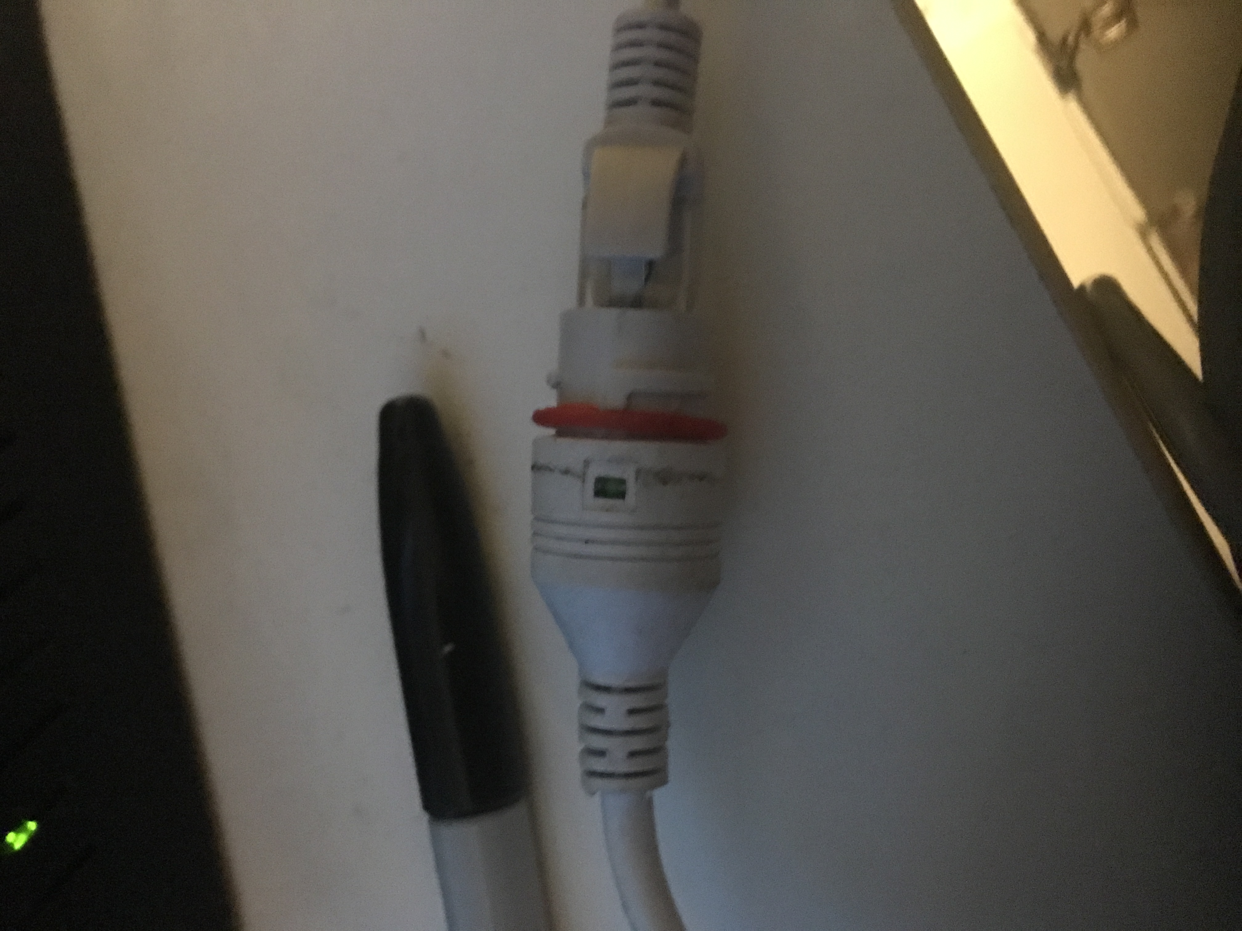

Sorry also there does not seem to be any hard reset buttons on the cameras. Just a cable inside.
There is a green power light on the camera cable, this was powered but now there is no power to the system.

You're right, the fact that there are no lights will be the source of the problem.
Most NVRs have a setting within them that allow you to turn the POE off on the ports, so I'd see if you can find this within your NVR and make sure that it is enabled on all ports.
Have you tested the one camera that you know worked after the power cut on each port to see if the ports light up with this one?
However, I'm afraid that my gut feeling is that the power cut has blown the NVR's POE switch and/or some of the cameras, it's normally not a good sign if you don't see any lights when a camera is connected.
If you have a POE injector or switch that you know works, you could try verifying that the cameras are still OK by connecting them to this and checking the lights.
