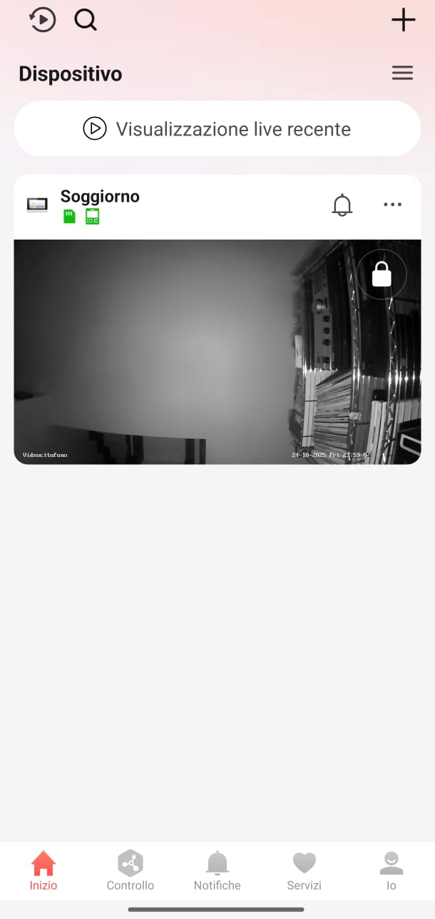

I have a DS-KV8113-WME1(C) with two DS-KH6320-WTE1 units. I configured everything with iVMS4200.
Everything works, I receive calls and even the live view.
I configured Hik-Connect on Android by connecting the main DS-KH6320-WTE1 indoor unit.
If someone rings at the intercom, I get the call with the live view and can answer or hang up.
The problem is with the live stream on Hik-Connect without a call. It works perfectly on the indoor units, but it no longer works on Hik-Connect.

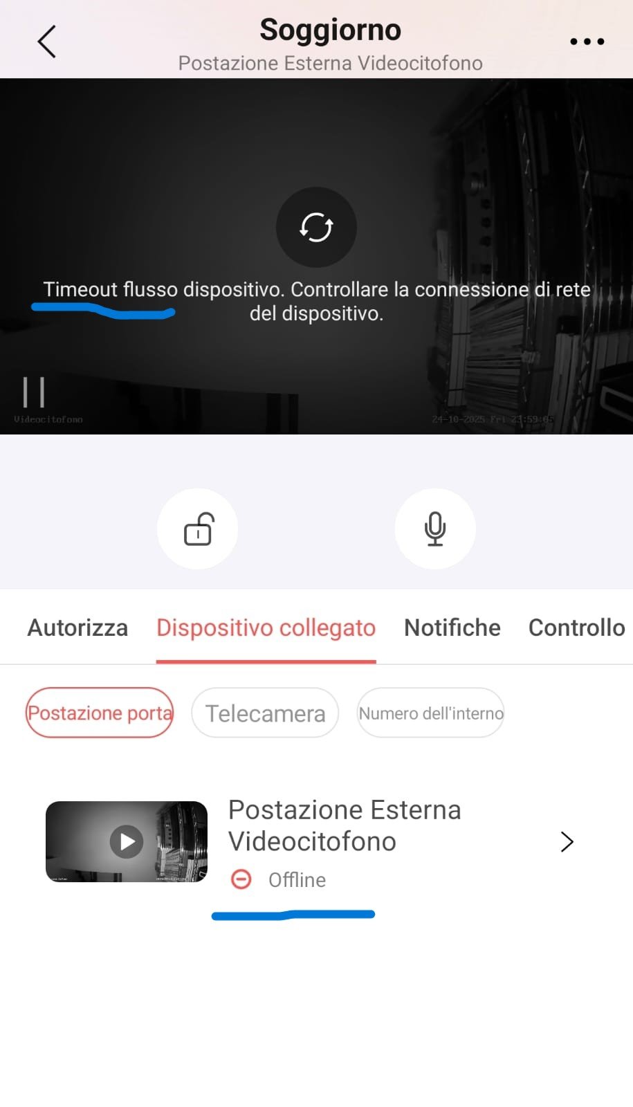

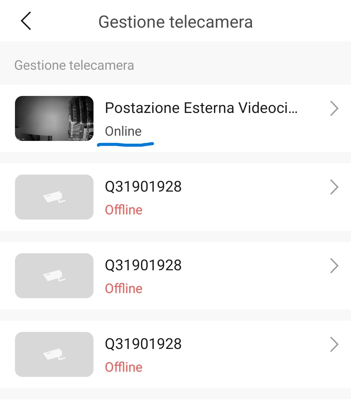

If I try to remove the DS-KH6320-WTE1 from Hik-connect and plug it back in, it works for a while, but then it stops and tells me that the external unit is offline and can't read the video stream. However, if I go to settings/cameras, it tells me it's online instead.

I try to stream video (live view) from Hik-Connect, but it doesn't work. However, if I do it from an indoor unit, it works fine.
Hik-Connect has connected the main indoor unit, which in turn "sees" the outdoor unit.
If I go to the Hik-Connect main page, like the previous screenshot, it says offline, but if I go to the indoor unit settings (still on Hik-Connect) and then to cameras, it tells me the outdoor unit is online.
And indeed, if someone presses the intercom button, I immediately receive a call and see the live view.
When I want to watch the streaming from Hik-Connect, it thinks for a moment and then tells me it can't get the video stream, that there are network problems, but in reality there are no problems.
