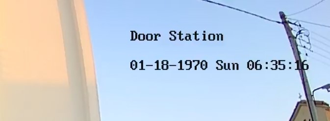

Good evening to all.
I have the following video doorbell kit and the time is not synchronizing.
DS-KIS703-P (Screen DS-KH6320-WTPE2) & (Door station DS-KV8103-IMPE2)
On the Screen DS-KH6320-WTPE2 everything it's ok i dont have Date time problem etc,
the problem is in the Door station DS-KV8103-IMPE2 the Date Time year is 1970 see the attachments
Thank you for your time!

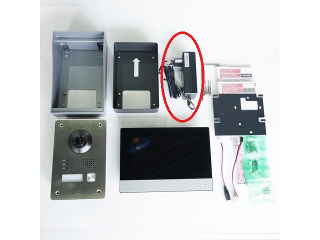

Good evening and thank you for your reply.
The connection is made correctly and everything works normally, open-close the garage and yard door, date/time on the screen is correct DS-KH6320-WTPE2 .
Hik-connect works fine from the mobile phone for remote control, SIP address etc. is set and the icon shows that it is connected normally.
The kit is two cables, the screen is connected to my wi-fi and from the menu one can add the door station DS-KV8103-IMPE2.
On the ivms-4200 it does not show me the door station DS-KV8103-IMPE2 online but it shows the name of the whole kit DS-KIS703-P.
As I wrote above, you consist of Screen DS-KH6320-WTPE2 & Door station DS-KV8103-IMPE2.
When I bought it I was told that I would not need a distributor or extra Power Adapter.
Distributor: DS-KAD706
Power Adapter: DS-KAW60-2N
Do you have the same kit? Have you connected it without the above and is it working normally?
The ds-kis703-p have Power supply 24vdc Power Consumption: < 8 W like the attachment
Thanks and sorry for the long post.
