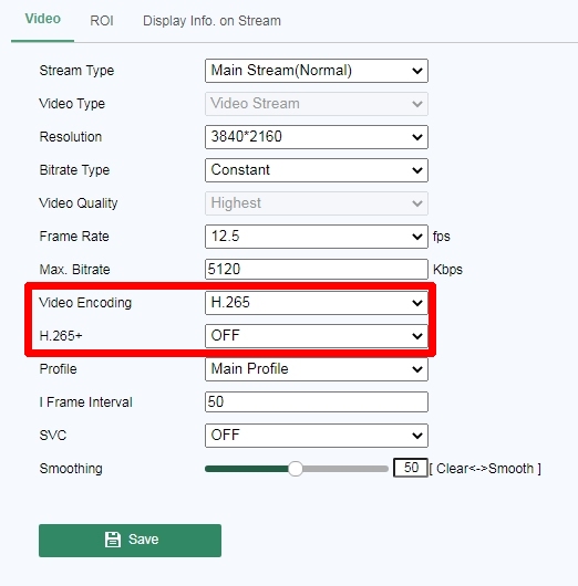

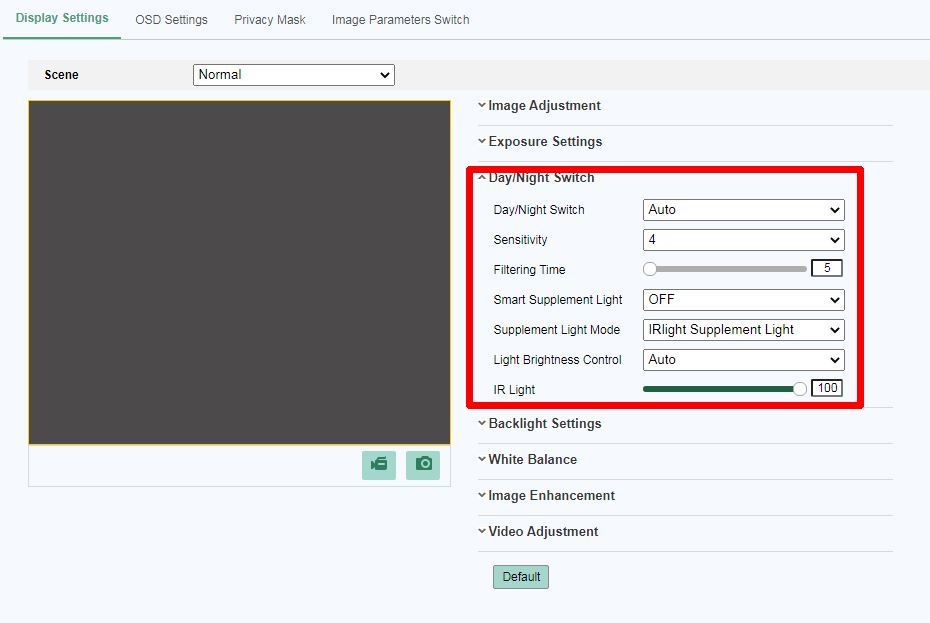

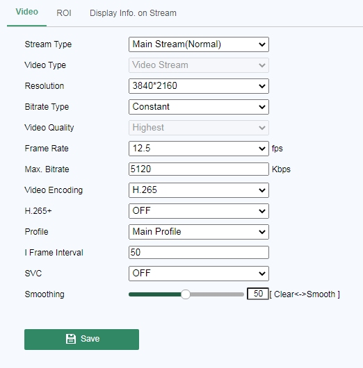

I have managed to whittle it down to 2 images and highlighted in red the only settings that I would like some guidance on. (Attached)
If you can say in laymans terms what these mean and if I need to change them then I should be OK?

Hi @jc001
I understand your MS word example but it doesn't really translate to CCTV because the settings you enable/disable are all dependent on the scene your camera is covering.
Below is a brief explanation of the settings you have highlighted:
Video Encoding - All IP CCTV streams are encoded/compressed because raw data would be too massive to handle, so by default, IP cameras are usually set to either H.264 or H.265. H.265 compresses the camera stream further than H.264 and this reduces the data/bandwidth and storage used by the camera. H.265+ will compress the data/storage use further but you will likely run into problems using smart events whilst having H.265+ enabled. If you only have one 8MP camera then using H.265 will be fine.
Day/Night Switch - these settings control how the camera behaves during the day and night, in most scenarios leaving this set to auto should work fine as the camera will just automatically switch into IR mode when the scene is dark enough. If you have lighting in the scene that is on all the time you can try switching it to day mode so the camera never switches to B&W IR mode and you always have a colour image (but you will probably need a lot of light to get a good colour image at night). Alternatively, if you have a unique lighting situation (e.g. floodlights that stay on for several hours after it gets dark) you could set it to schedule switch and set manually when the IR switch happens.
Sensitivity adjusts how dark it has to be before the auto IR switch happens and Filtering time adjusts how quickly the IR switch happens. Again in most scenarios, these settings left as default are fine, but you can have a play around with them if you want (check the IR switch in your playback recording to see how it looks before you make any changes).
When the smart supplement light is enabled it adjusts the power/brightness of the IR LEDs based on the activity in the scene (e.g. if people/objects come close to the camera it will reduce the brightness to avoid whiting them out. Again this is something to test to see if it makes a difference to the scene you are covering.
Hi Dan
That example of Word was as basic as I was trying to get. (i.e layman terms)
Your reply of the red highlighted areas and your response has covered more than enough.
I now understand what these mean and see if I require them or not.
Thanks again for your help.
