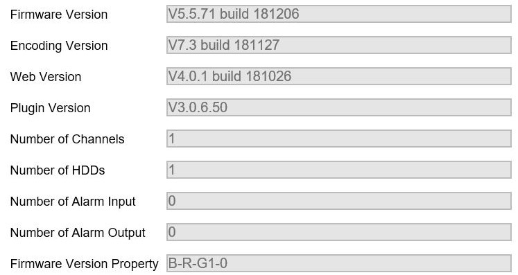

Camera Firmware - this is a US market camera.

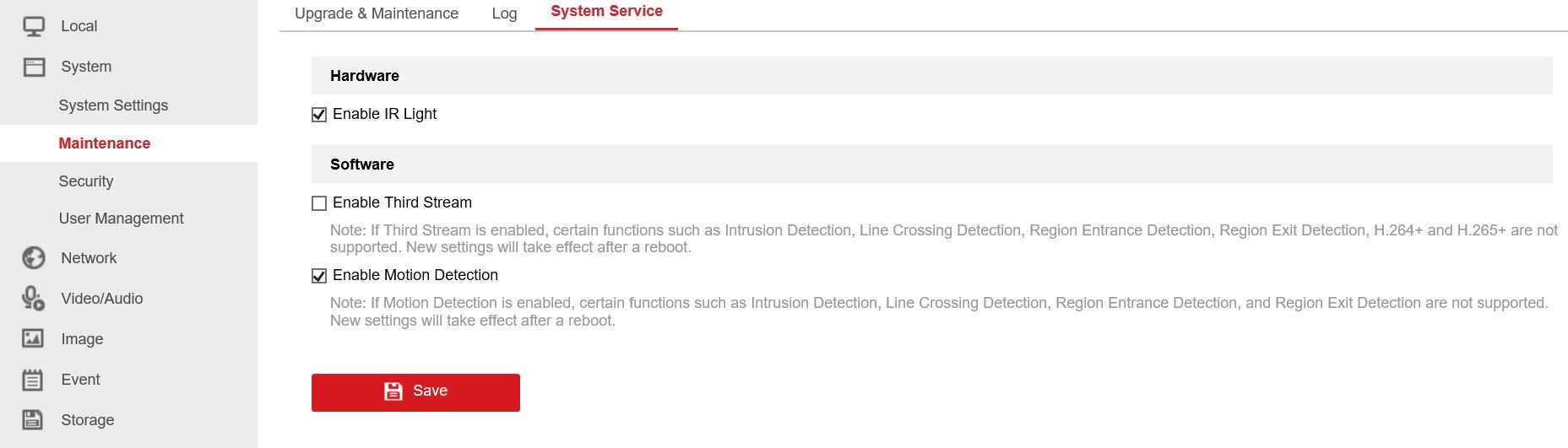

On this newer EasyIP 4.0 DS-2CD2646G1-IZ(S) camera those steps do not work. I had to do some extra configuration to make motion recording work.
- System > Maintenance > System Service and under the software section, > Enable Motion Detection first then complete the above steps 1 and 2. I am wondering if anyone else has seen this or if I am loosing my mind..
