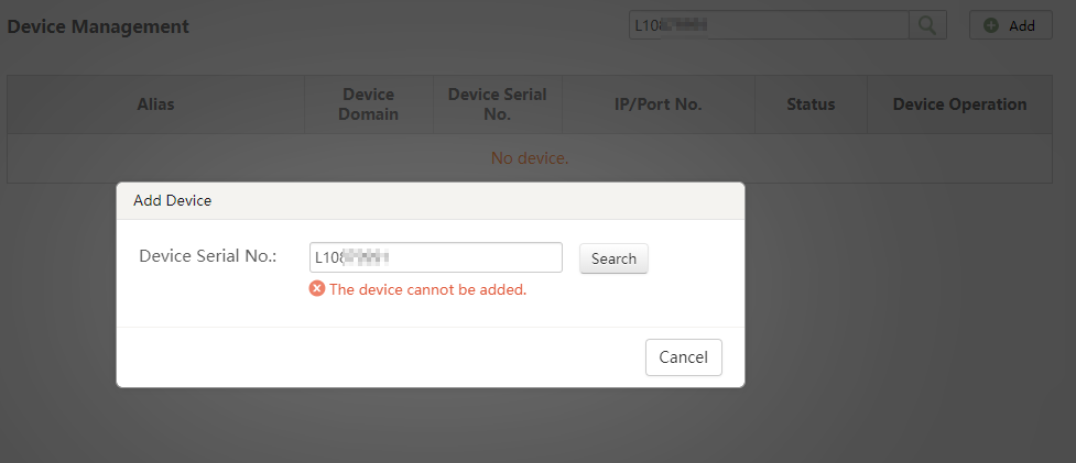

Trying to setup hik connect:
DS-7608NXI-K2 / 8P
4x DS-2CD2147G2
static ip
When i try to add the NVR on hikconnect website it says "the device cannot be added". I tried look on forum/internet/reddit there is no mention of this.

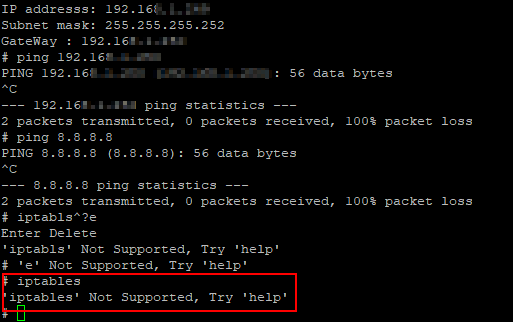

What i found is that when i connect in SSH to the nvr, i can't ping my gateway, i suspect some internal iptables rules to block the traffic, but i can't the iptables cmd as it says "not supported" how do you unblock it?

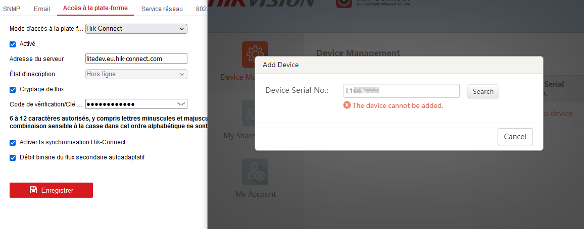

Hi @Martel
Was platform access already enabled when you first looked at it or did you enable it after I linked you to the above steps?
If you have just enabled it, could you please try adding it to the Hik-Connect Portal again?
I enabled it
Just retried with same issue "the device can't be added"

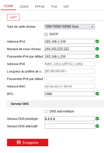

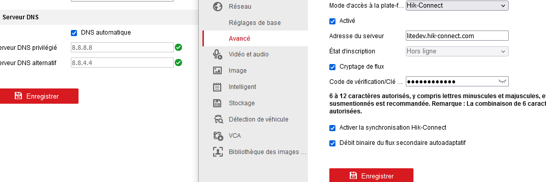

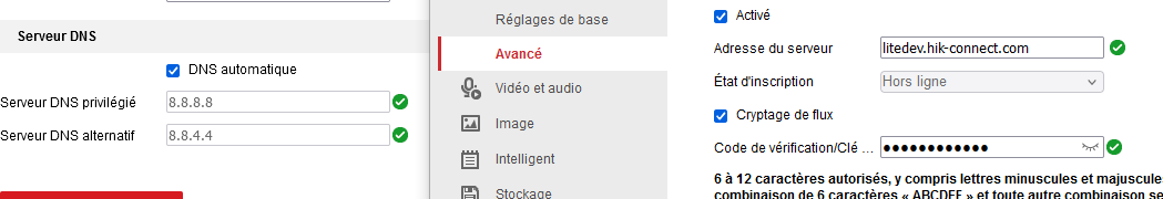

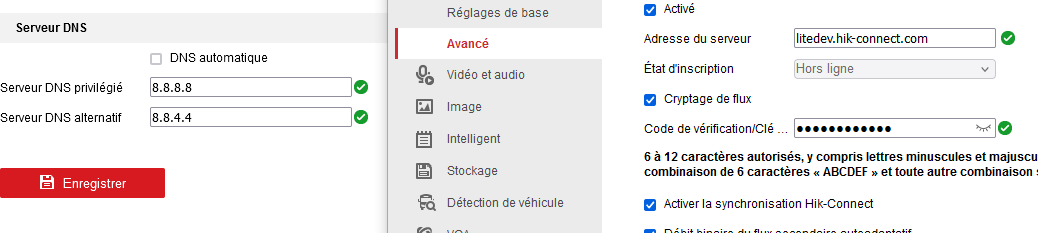

Thanks @Martel
We can see in your network settings that you only have one DNS server set, can you please add 8.8.4.4 as the Alternate DNS?
If it is still showing as offline after you save that DNS setting, can you try changing the DNS to Auto DNS and check platform access again.
Thanks @Martel
Thanks,
Still same with 8.8.4.4
No luck with auto dns

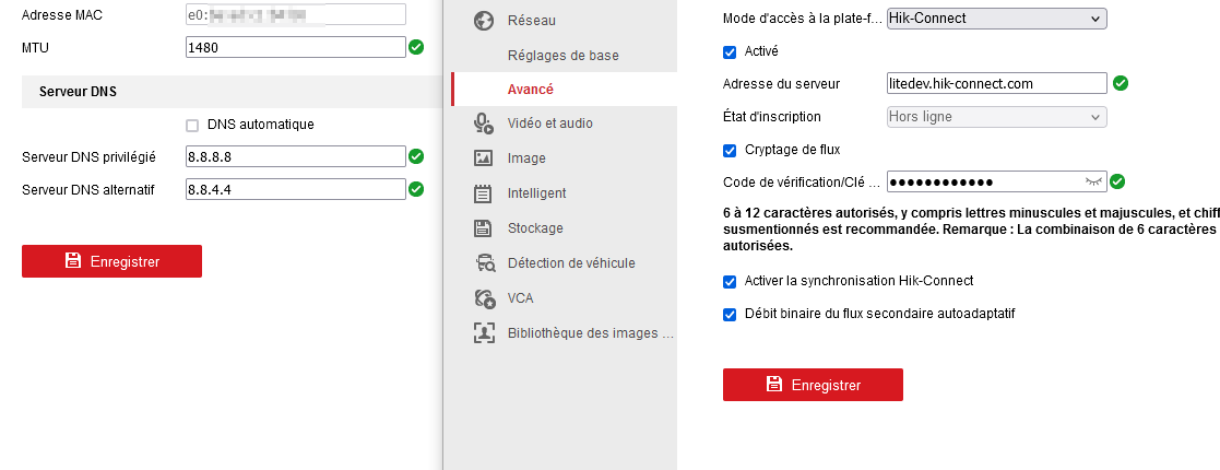

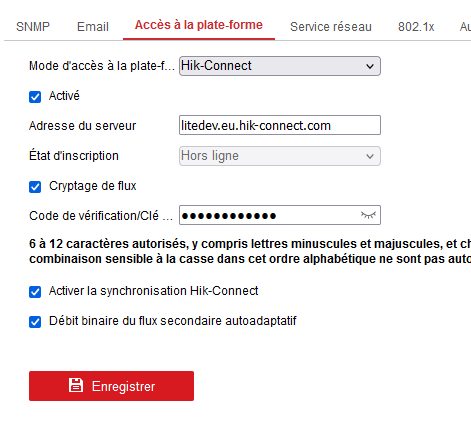

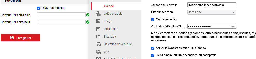

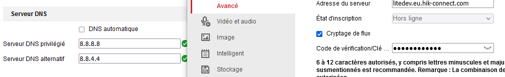

Okay,
Can you try changing the Hik-Connect Server Address to litedev.hik-connect.com
Okay,
Tried both with static DNS and autodns and still offline,
How i'm supposed to made it online if i can't even ping my own gateway from the NVR, is there any internal rules that block access to internet?

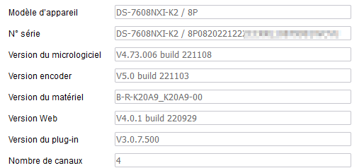

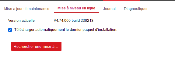

Thanks @Martel
Can you please try updating the NVR firmware to the latest version - V4.74.000_230213? Once updated, please check the Platform Access page again.
Same issue after upgrading :(

Tried to register on hikconnect.com but still got "The device cannot be added."

As i tested i can ping from the interface to internet (ping 8.8.8.8 / traceroute )
I can ping from a computer in the same subnet as NVR
=> I can't ping from the NVR to internet
Can't access the iptables setting on the NVR, how can i do that?
Hi Dan,
Just a quick follow up to tell you that i've managed to make it work.
I tried to downgrade it the firmware without success so i've decided to bypass the firewall and plugged in directly to the router, i don't understand why it was not working as i had no deny rule on this specific vlan.

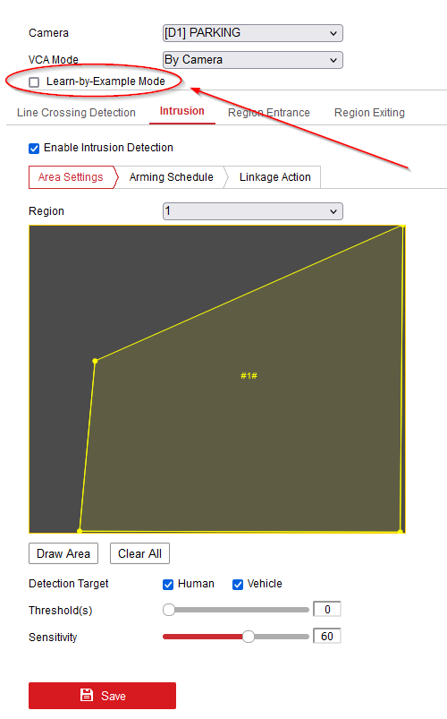

2/ On the storage part, i've setup recording on intrusion only, all other events (motion detection and all zone in/out/line are off) from monday to sunday /24h
Should i tick the box for "Learn by exemple mode" (on the screen) ?
I have on one week a total of 400Gb recorded on 4 camera
Setting are on the 4 cameras (DS-2CD2147G2)
Main stream
2688*1520
Bandwidth = variable
quality = superior
FPS = 30
Bitrate = 8192kbps
Sub stream
1280*720
bandwidth = variable
Video Quality = superior
FPS = 30
Bitrate = 2048 kbps
H265
I find the recording size a little bit big for a week of recording, should i put H265+ encoding? Should i reduce the bitrate ? Are my setting OK or just too demanding?

Have had exactly same issue with DS-7608NXI-I2 / 8P/S and changing DNS to 8.8.8.8 and 1.1.1.1 resolved issue (changed to newest firmware too, but not resolved until DNS change, maybe part of solution)... Strange it wont done this at cheap old HiWatch NVR with local dns.
