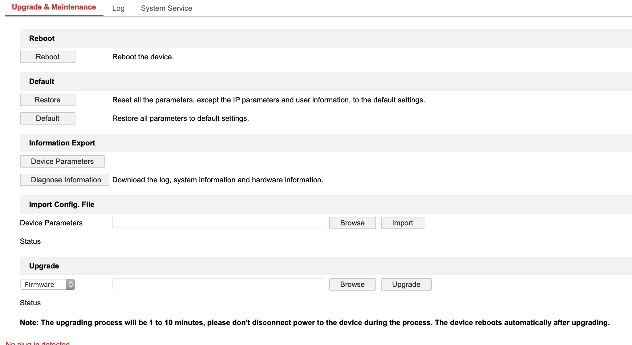

Trying to update 3 OEM cameras, however when logging in on my computer via IP, and clicking the "browse" button to locate the firmware file, nothing happens.
I'm running macOS Mojave. Tried in Safari, Google Chrome. Also tried using my Virtual Desktop running Windows 10, and Google Chrome. Plugins are missing, and can not activate/click on the "browse " button to find firmware.
Cameras: Model NC324-TD, Serial #: NC324-TD20180411AAWR204394473
NVR: Model NR32P4-4, Serial #: NR32P4-40420180710CCRRC14864091WCVU

I'm afraid, I think you're going to need to do this on a Windows PC.
Why do you say that? Again I tried via Virtual Machine (running Parallells on my Mac, loaded up Windows 10, same issue).
Mac issues - I'm afraid these camera manufacturers just do not yet have solid Mac solutions.
Parallels on a Mac is not Windows - sorry :oops:
Seamonkey web browser works. Able to click on browse button.
So Mac users, SEAMONKEY is the answer. Thanks.
