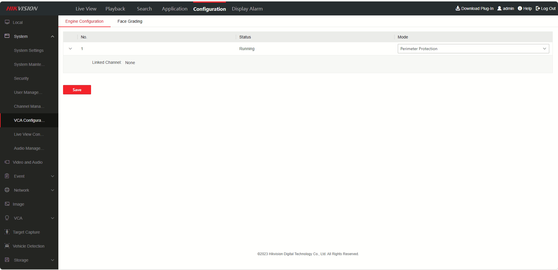

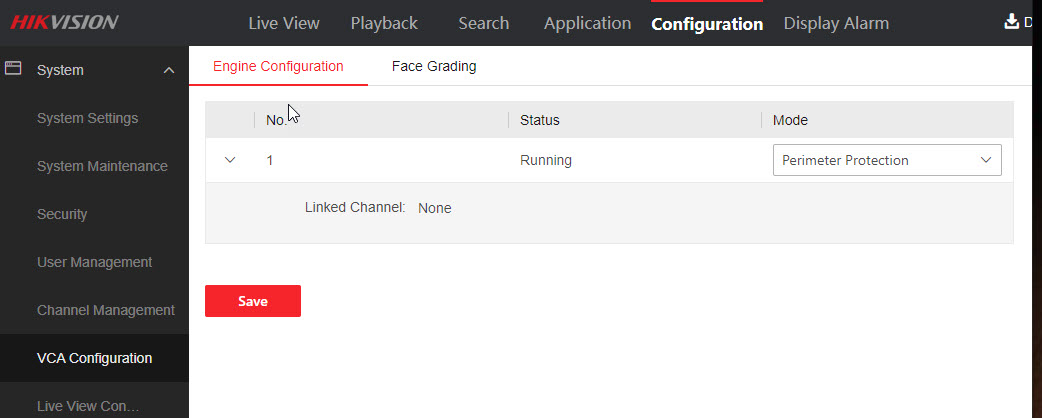

Hi
I cant seem to find the answer anywhere, so I hope someone in here can help me?
Please see attachment - what is this configuration for, and shouldnt I have at least 1 linked channel here? (See attachment, linked channel: None)

This one causes a lot of confusion. You have activated "Smart Event:Intrusion Detection" but it's possible/likely that you're using the cameras VCA. The camera model you've detailed does not have AcuSense Human/Vehicle filtering so you're not getting the benefit of the NVR features and not using the event engine.
Go back to the Smart Event Intrusion Detection setting for the camera, disable it (untick the enable box) and save/apply. Then at the top of the page tick the box for "Use Device VCA" (or similar wording), click apply. Once that's done enable Intrusion detection again and redraw your settings. That should force the NVR to to do the AcuSense filtering and the camera should then appear as using the VCA Event Engine.

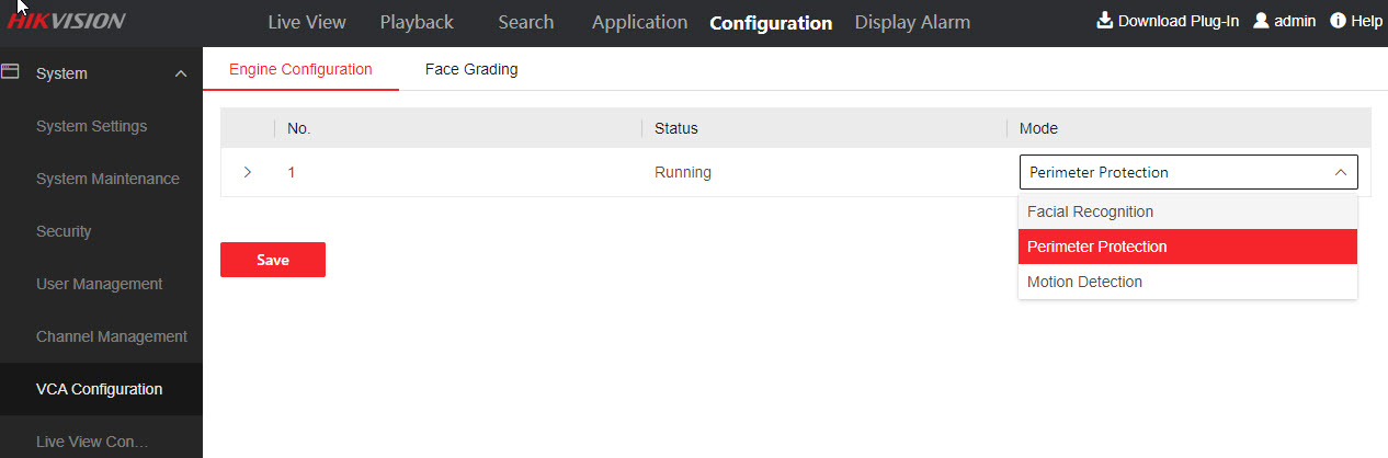

Can you tell me what the difference between VCA Engine set to "Perimeter Protection" or "Motion Detection" is for?
And when I should change that?

If you use the AcuSense feature built into to the cameras (use device VCA unticked) there's no need to do anything. The camera is processing the events and only sending them to to the NVR if the conditions are met. The camera can be configured to filter events based on human/vehicle for motion detection, line crossing and intrusion detection simultaneously if more than one event type is configured for that camera.
If you use the AcuSense feature built into the NVR (use device VCA ticked), the NVR engine can either be used for motion detection, OR perimeter detection (line crossing/intrusion) to filter events based on human/vehicle. Any camera can be used and the event is sent to the NVR without regard as to whether there's a human/vehicle present. The NVR event engine then applies filtering to each incoming event, only performing the configured actions if the human/vehicle filter is matched. Because the processing capabilities of the NVR are finite, there are limitations:
  • You can't have both motion detection and a perimeter detection (filtered) event on a camera IF using the NVR VCA engine (as you have to set one or the other in the NVR page you've shown)
  • You can't have filtered motion on one camera and filtered perimeter detection on another IF using the NVR VCA engine (as you have to set one or the other in the NVR page you've shown)
Generally you would always use the AcuSense feature in the camera (use device VCA unticked) on any channel where the camera has the AcuSense feature (so if all of your cameras are those 2143G2's, set it up this way and forget that the NVR has that feature as it's less restrictive to use the cameras inbuilt functionality)
Alternatively if you have a mix of old/new cameras without/with AcuSense capability; you would use the AcuSense feature in the camera (use device VCA unticked) on the capable cameras. On the cameras that aren't capable you would use the feature in the NVR (use device VCA ticked), decide whether motion or perimeter detection was more important and select that option in the page you've shown prior to setting up the events.
Primarily the NXI models have the feature as a means to upgrade an existing system where the existing cameras don't have the capability.

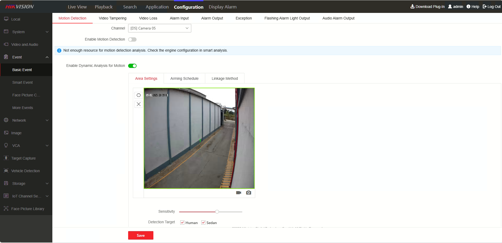

Now about the Motion detection in basic events...
1) It appears the message "Not enough resource for motion detection analysis. Check the engine configuration in smart analysis." Probably by playing with configurations I have messed them all up. What do I have to do to remove this message?
2) In motion detection it also gives me the option to choose for human/vehicles clarification but only in my AcuSense cameras. So what that means? Does that means that the cameras use the AcuSense feature also in motion detection except the smart events? So cameras with AcuSense feature applies it to both basic and smart events?
3) My Engine Configuration in VCA configuration is set to perimeter protection. Is this why in the non AcuSense cameras gives me the option to select human/vehicles clarification at smart events and not in motion detection? For example... if I change the engine configuration to motion detection, will then allow me to choose human/vehicles in motion detection and will remove this option from smart events?
For VCA by NVR (needed for your non AcuSense cameras) the 'engine' can only do perimeter protection (line crossing/intrusion) OR motion detection. For perimeter protection, the NVR may be limited to a particular number of channels. You need to decide for the non AcuSense cameras whether you want motion or perimeter protection.
Human/Vehicle is available on Acusense cameras for both motion and perimeter protection; in fact you can use both simultaneously when VCA is 'by camera'. That's one of the benefits of having the camera doing the processing (where capable) as it's unrestricted. If your non AcuSense cameras aren't giving you the option of Human/Vehicle on motion, it's because the engine is configured for perimeter and so it's unavailable.
Yes and yes, but it's a bit of a faff on to switch....

Why you are confused? My engine configuration is set for perimeter protection as it has to be. I use only one non AcuSense camera for smart event so I think that's setting is fine. Also it has no linked channel on it as I have disable all my events.
The problem is that I have this message on all of my cameras channels in motion detection section. So I suppose this message appears because of faulty setting I had in the past.
Yes possibly. That's why the first step listed in my post above was to enable VCA by NVR on all channels, then delete all line crossing, disable line crossing, and switch back to VCA by Camera. There wasn't any point in not deleting the line crossing configuration before switching to VCA by camera; it's no use to you later on. When you do VCA by Camera, although it's displayed in NVR UI, the line crossing is saved in the camera itself. When you do VCA by NVR I think (I could be wrong), that line crossing is saved on the NVR not the camera. So I don't think you can't just switch to NVR by Camera and expect your configuration to work.
I very rarely use VCA by NVR on the NXI NVRs as I install AcuSense cameras by default, but on one occasion where I got things screwed up like you're experiencing, that is what I did to resolve it. For what it takes it's an easy job just to restore the defaults of the NVR from the maintenance menu (using the option to keep the user and network information). It'd take less than 30 minutes to do that and program it again.
