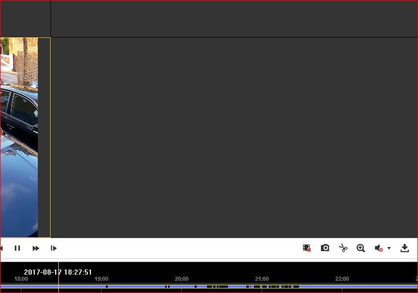

I have 2 wireless cameras in my network, a Hikvision DS-2CD2542FWD & a DS-2CD2142FWD. The 2542 has worked flawlessly while the 2142 occasionally behaves like a poltergeist has sneaked into it.
It can run seemingly smoothly for weeks, then it will go though phases when there are recording blanks. This usually starts with gaps of just a few seconds (only noticeable if you happen to be watching when the clock freezes), then a few minutes and sometimes hours. I have uploaded a snapshot of how this looks on the NVR playback screen.

So I investigated much more closely the recordings of this camera and discovered its image gaps were worse than I had thought. You can’t see these as “black gaps” on the playback screen because of the scale on the time axis. However, there are skips of about half-a-second to a second going on regularly. Also, when I create an intrusion alarm, the event almost always triggers a loss of video, which then takes anything from a couple of seconds to a couple of minutes to reappear. The impact seem to vary with the scale of the moving intrusion, but haven't tested that rigorously.
