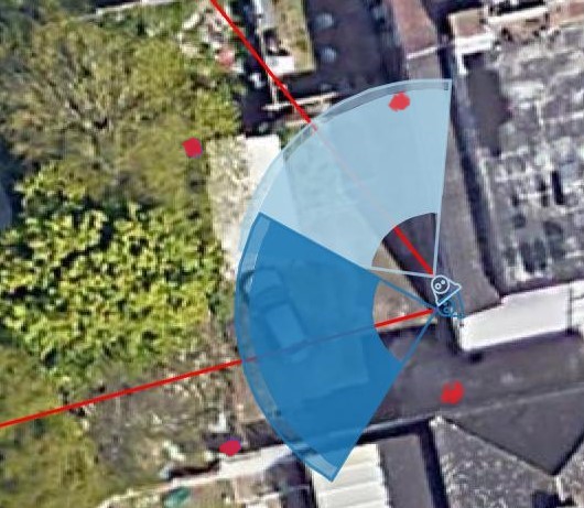

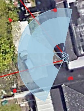

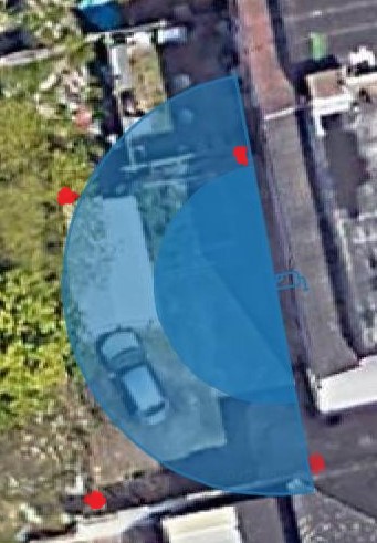

im thinking of both DS-2CD2387G2-LSU/SL 8mp for side house ( 12 x 2m) & new DS-2CD2T87G2P-LSUSL for rear as this would cover 180 degrees and no blind spots. looks ideal but lower ppm. or maybe 2 x DS-2CD2386G2-ISU 4mp. i have attached some pics showing each
which camera setup would you think would be ideal or should i go for a diff model?

first of all, we would not recommend the 180 bullet camera. It has the lowest PPM because it has the same resolution as the 2387G2 but those pixels are spread out over a much larger area, this leads to less detail and some warping/distortion from the ultra-wide FoV.
If you are looking for the most detail we would definitely recommend the 8MP 2387G2 model, but I would also point out that the camera's built-in white light for achieving colour images at night is very bright and might not be a good choice if you are installing in a residential area. We usually recommend that ColorVu cameras work best in locations where there is already some ambient lighting like street lights or motion security lights and thus don't have to use the built-in white light.
If the scene is completely pitch black at night you might be better off using an IR camera like the DS-2CD2386G2-ISU/SL 8MP AcuSense Turret

thankyou for your kind help. do you think the 8mp 2.8 vs the 4mm at a 10m distance there would be much diffrence in picture quality for identify purposes at that range. i ask because i can get the DS-2CD2387G2-ISU 2.8mm version at decent price of someone i know as hes decided not to install.
calculator shows 2.8mm at 214.6 ppm at 10m away vs 4mm 248.8 ppm at 10m away from camera. 4mm does have the higher ppm due to being more zoomed in but would the aprox 30+ ppm diffrence over the 2.8mm really be noticable up to 10-11 neters.
should i stick with 2 x 2.8mm for rear or pay the extra and go with 4mm option. or even go with the 2.8 and 4mm mix?
