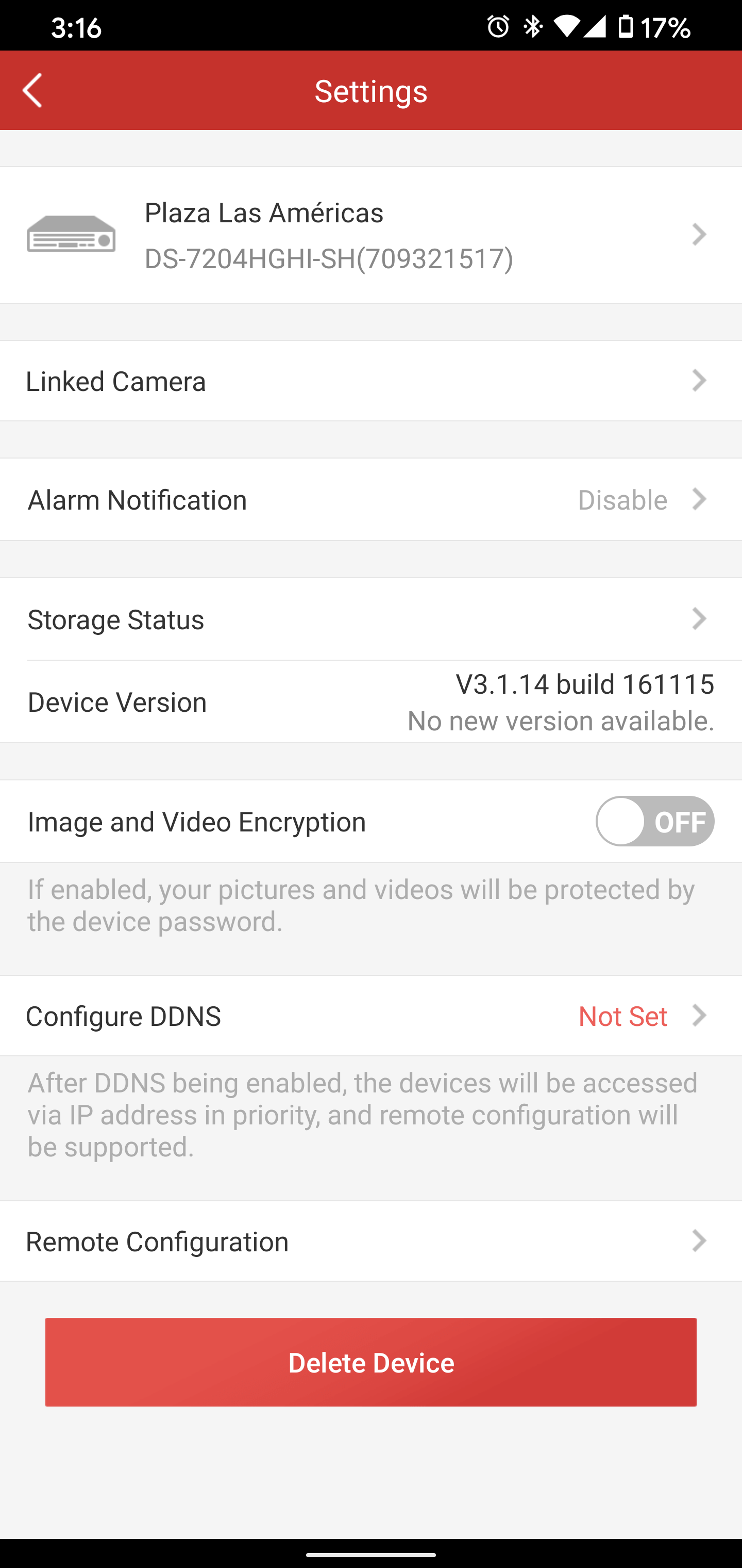

Morning, what are the model numbers and firmware details?
I'm not an expert on this stuff. Does this image contain that info?
Upvote 0
@justinestrella That DVR is an old discontinued model...
DVR DS-7204HGHI-SH
Firmware 3.1.14 build 161115
Hardware platform K32
Turbo 1.0
The latest firmware for the K32 platform is here. NVR firmware upgrade instructions are here. Maybe @Phil or @Dan know where the DVR firmware update guide is.
