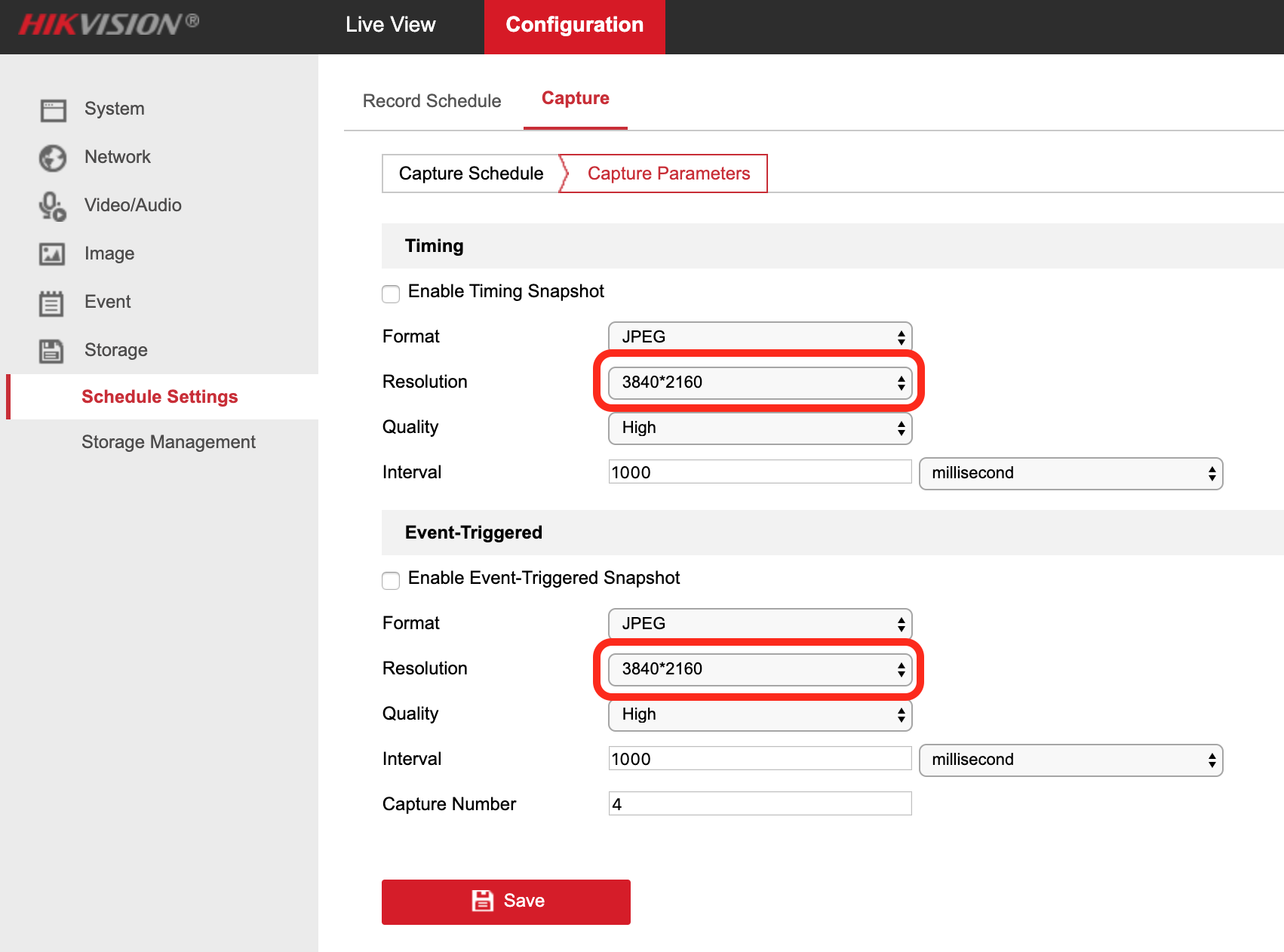

Further to the above the snapshots i am talking which can be set to take when an event occurs, the setting for this is under the capture section of storage management on the NVR which will only allow the pics to be captured at a max 704x 480 but if you look at the same setting son the camera it will allow max res.
Is there a way to get the NVR to capture at the max res?
So those settings only apply to captures that are to be sent by email via FTP, the fact that the max resolution is low here is due to restrictions on the size of email attachments.
I'm looking into an alternate way to capture at max resolution, I'll let you know if I find anything.
Looks like the capture parameters allow you to set it so maximum resolution when logged into the camera directly - so ignoring the NVR capture parameters and setting up all events/enabling snapshots on the camera only. Here is the full resolution option when logged into an 8MP turret:
The file size restrictions seem to be down to the NVR's processing limitations, so the above settings will still send the captures via email/FTP in full resolution, as they will be sent straight from the camera.

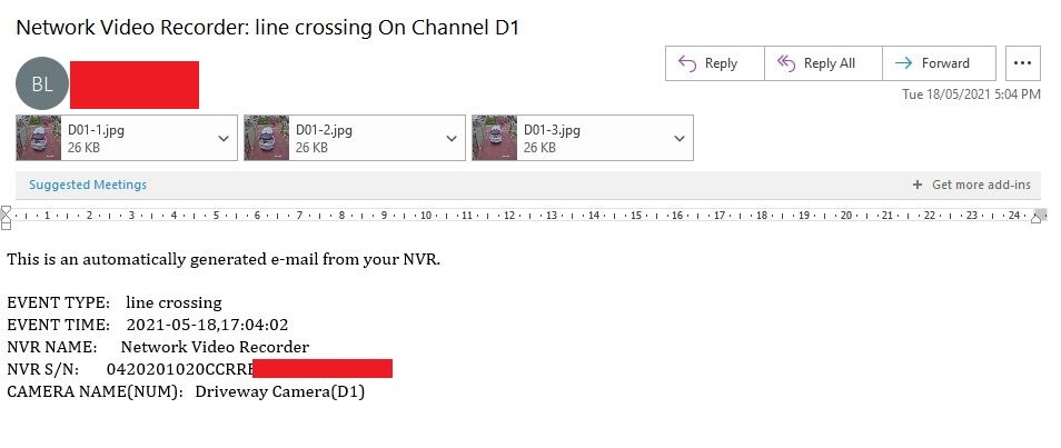

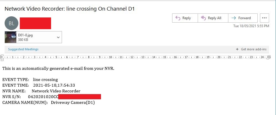

I have a DS-7604NI-K1/4P-B NVR with 1 Camera - (Acusense DS-2CD2386G2-I) connected to it. Both items have the latest firmware on them as of 22 May 2021. I have been trying to resolve the 3 images by email issue for almost a week and am ready to give up. I have noticed that when there is "limited light" intrusion events, I receive 1 image of around 400kb to 520kb sent by email via the NVR. During the day (even when it is a cloudy and overcast) i receive 3 small images of around 27kb each. The small images are next to useless and I would prefer just 1 large image.
I have tried many combination of changes and am at a loss to fix the problem. The people that I purchased the NVR & Camera from here in Australia have offered numerous suggestions - from Hikvision Technical Support - but nothing has worked so far. Surely this cannot be so complicated and if Hikvision can't resolve the issue who can?

We have discussed this issue with Hikvision support previously and the latest information we had was that Hikvision now only supports 1 image being sent via email and that there is no way to change this. We have never encountered 3 images being sent during the day and 1 during the night for the same event on the same camera.
Hi Dan,
Thanks for the reply.
Find attached "snip" of email showing 3 images (27kb each) being sent at 17:04 and then a "snip" of email showing 1 image (380kb) being sent at 17:54. Same camera and same smart event (line crossing).
Hi @BLOZ
