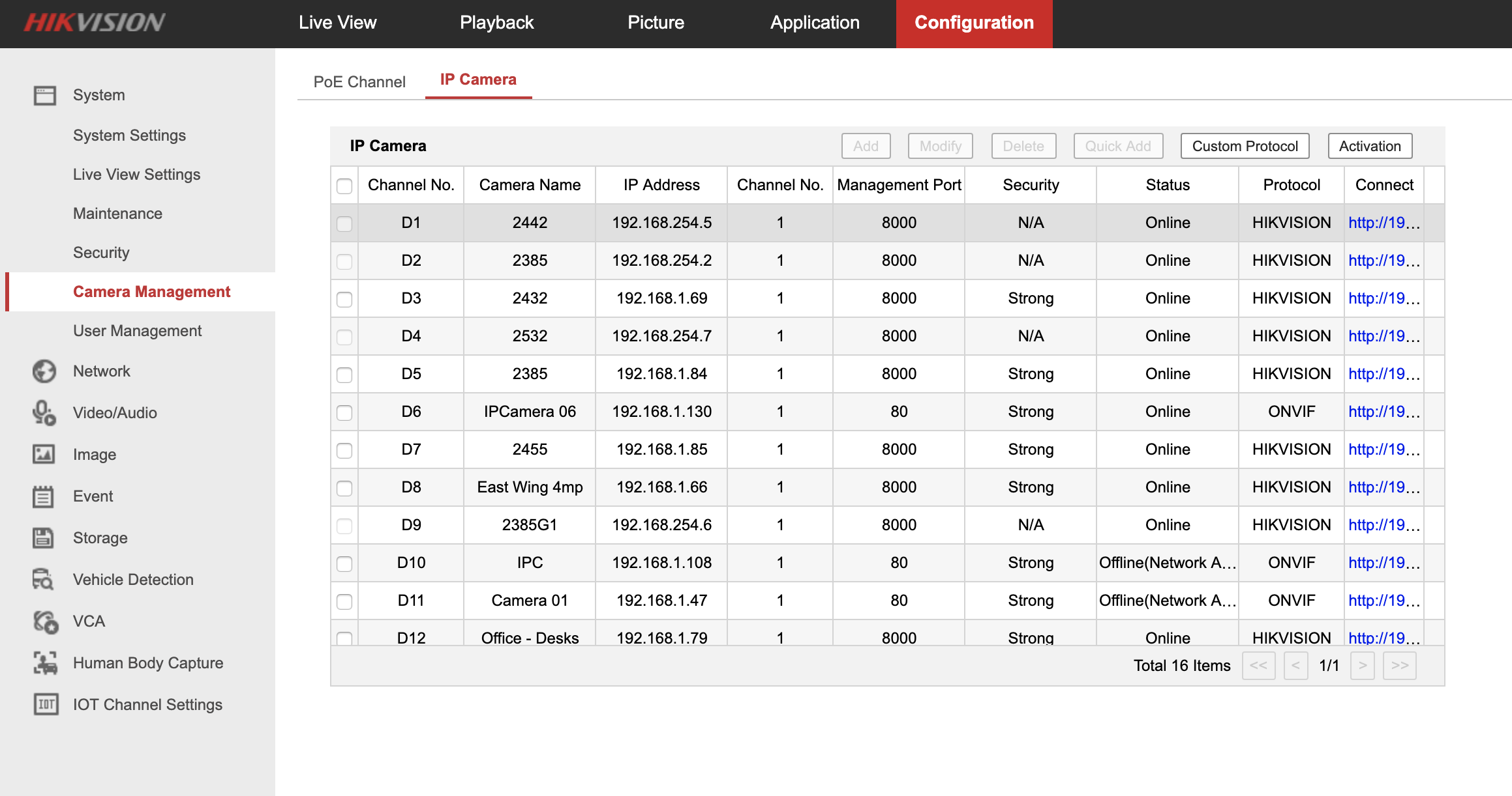

@Dan Ive managed to get the password.. It was under the IP Camera activation.. For some reason the Cameras have IP Camera activation Password set.
How can i change that to the same password as the NVR?
Use virtual host to login to the camera and you can change the camera password from within the camera's settings

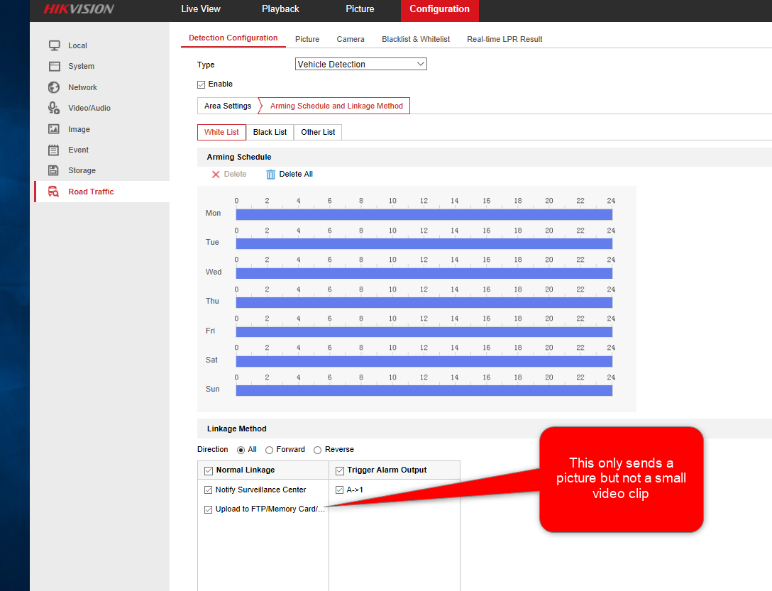

I also have a DS-2CD4A26FWD-IZS/P - which has great ANPR capturing. It captures the number plate of the car as an image. But is there a feature where it will record the video 5 secs before and after seeing the car as a small video clip. I would like it to then FTP this short video, to an FTP site. I dont suppose anybody has managed to do something like this? I have an SD card in the camera, but i dont see an option in the send a video - see attached screen shot
Many thanks in advance
