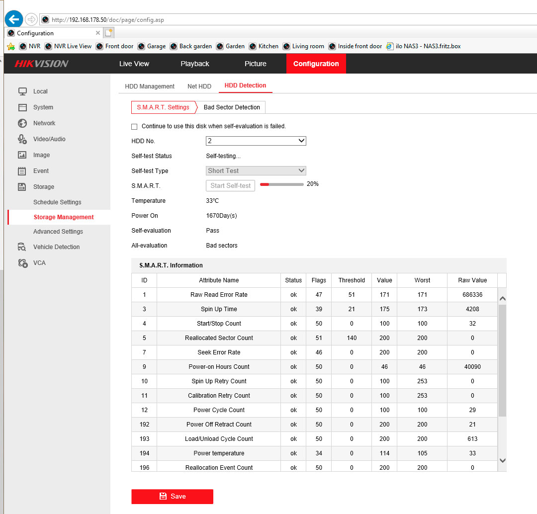

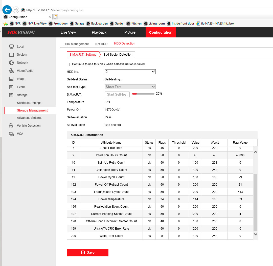

If you go to Maintenance > HDD Detection > S.M.A.R.T Settings and select a short test from Test Type, and then click the little cog symbol you can start a quick HDD test. Does the test fail or throw up any errors?
What firmware version is your NVR currently running? (you should see this under System Info in the same Maintenance menu)

The firmware is V3.4.103 build 181226 and I've attached screen grabs of the self test results which (to me) appear to be OK.
