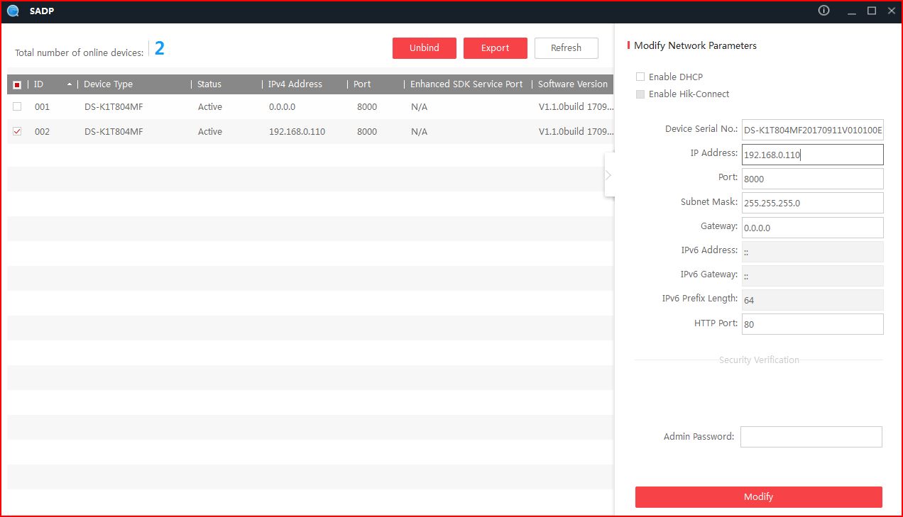

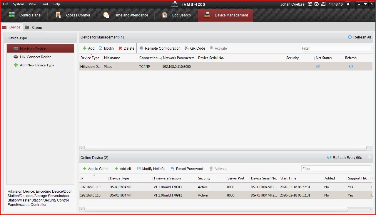

I bought the DS-K1T804MF Fingerprint Access Control Terminal and did all the setup steps. SADP Picks up the unit. But in iVMS-4200 the unit does not allow the option of being activated. I assume it is something to do wth the IP/ Subnet Mask/ Gateway, but i have no knowledge on how this works and which IP I have to change. Hik-Connect also does not pick up the unit.

Would you be able to attach a screenshot of your device list in SADP and the network settings, and what you're seeing in iVMS-4200?

Hi Kyle

Unfortunately I am having trouble with the iVMS-4200 tool where it asks for the password, of which the only password i set up is not working, so I have to wait 30min for the next try.
Attached is the pictures as requested.

My mistake, ignore my last comment about the gateway, I meant to say you should't worry about the 'port' much.
My immediate thought is that the gateway field looks incorrect. Launch 'commandprompt' on your PC, type 'ipconfig' and then hit enter when its open, this should list your gateway address which you need to fill in the SADP network parameters.
When are you getting the password prompt for iVMS-4200? There will be two different user/password combinations needed in the program, one is for the superuser password that the program will ask for upon launch and you will have set when you first installed the program. The other is the device password which you should have also set yourself and the program will ask for when you try to add a device, here's a link to our article about the Hikvision device passwords.

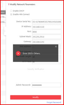

When I insert my Gateway address, it gives me this error: Error 2015: Others

That's maybe to do with the password that you're trying to set. Try a password that only includes letters and numbers and see if that makes a difference.
If not, try inserting the device's listed IP address into Internet Explorer search bar and see if it lets you set a password this way.
