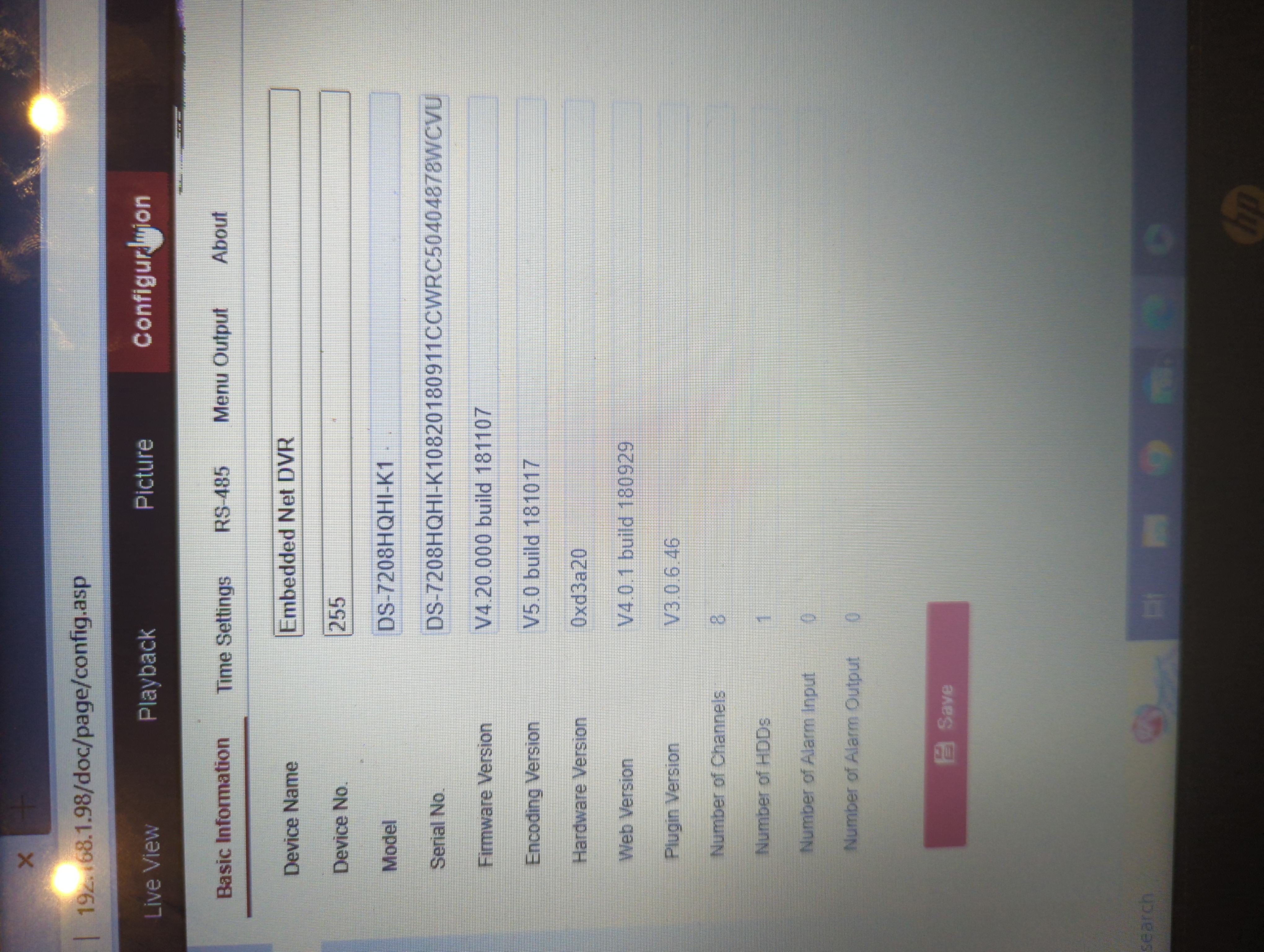

Can you also share a screenshot of the NVR's System>System Settings>Basic Information page from the web interface, please?
Upvote 0

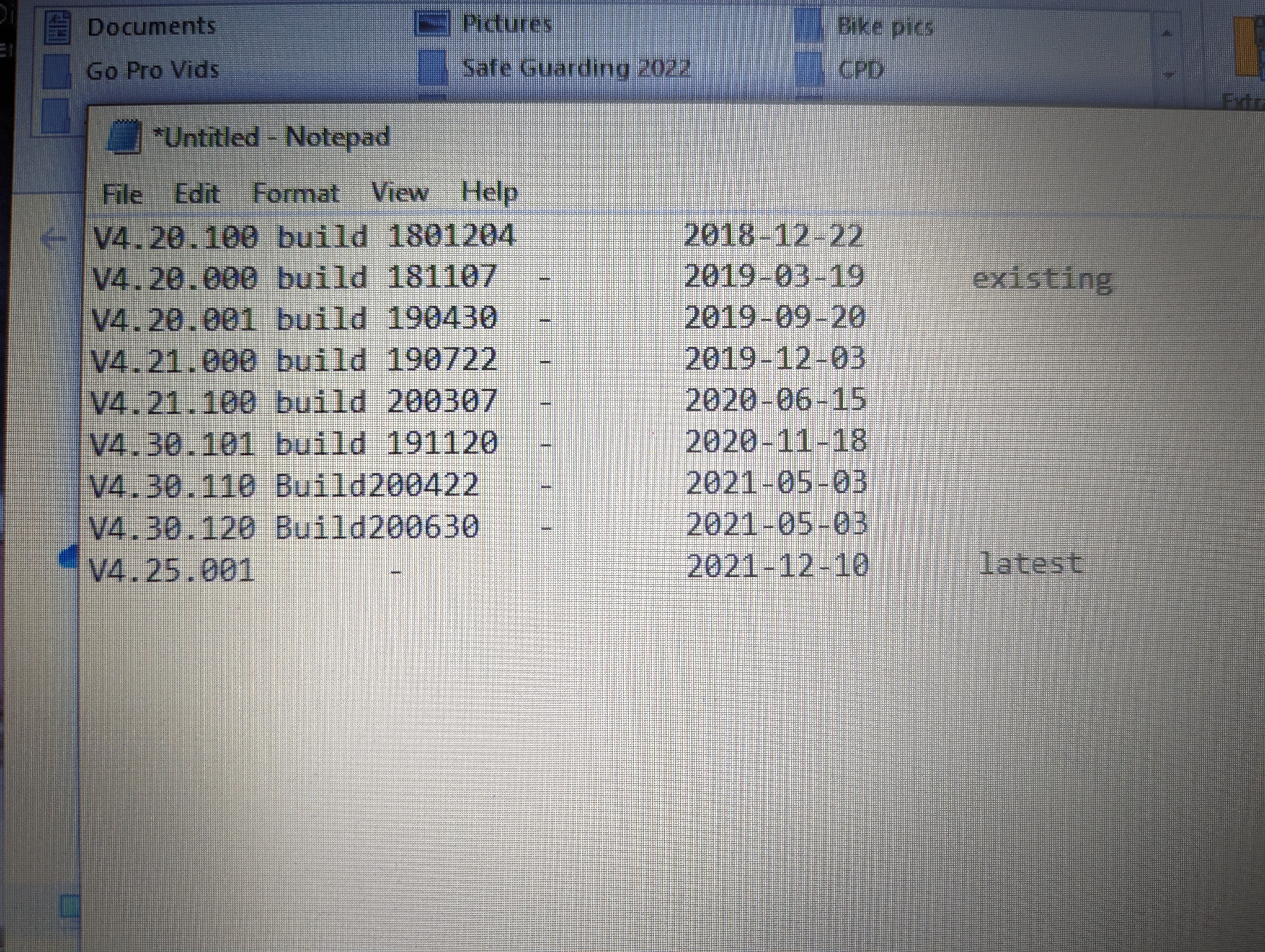

It's from the Hik Vision Europe site (UK and Ireland been down for a while). Attached image shows the existing firmware and latest as per the Hik vision site. I tried the version after mine and again it looks like it's worked but after a reboot the firmware is still showing as the old.
Thanks :)

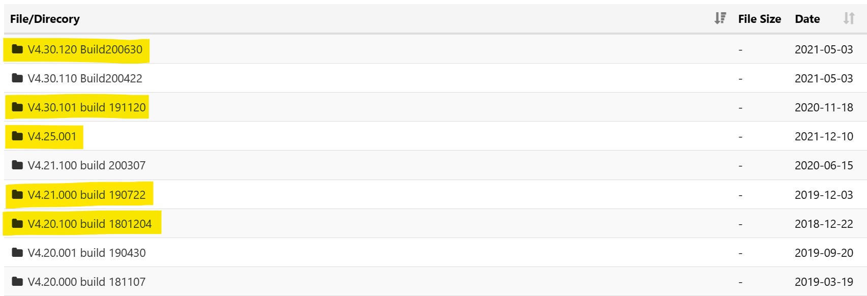

Thanks, I've found the folder, it looks like the European portal is definitely updated the most regularly:
It might just be too big a jump, try updating in steps via the versions highlighted below:
