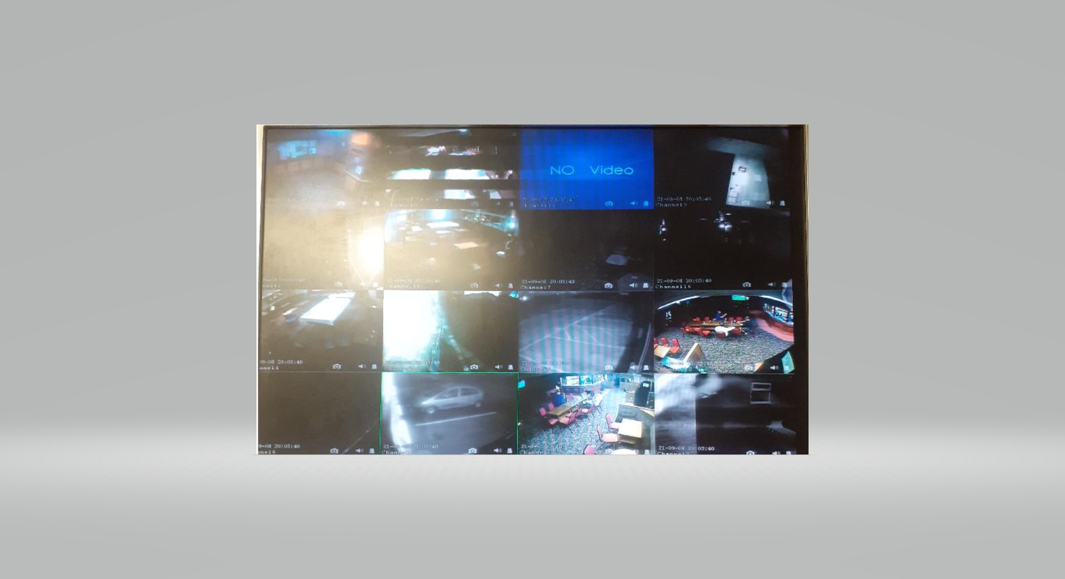

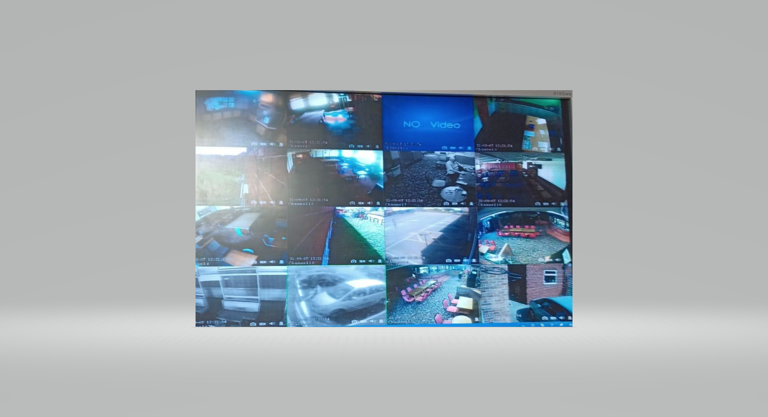

these are the current cameras he wants to replace, both pics are day and night images , any more advice on what cameras he needs your help would be grateful mate

these are the current cameras he wants to replace, both pics are day and night images , any more advice on what cameras he needs your help would be grateful mate View attachment 6591
You can easily use that cameras, that Dan explained before. You will see, the new ColorVu or AcuSense 4MP Models make a very nice image, and your old 2MP Cameras are nothing against thats. For Indoor use Dome Cameras, for Outdoor i prefer Bullet!
With the new cameras, you have nice functions included for intrustion detection or line crossing. With Hik Connect you can use the camera system like a alarmsystem ^^
