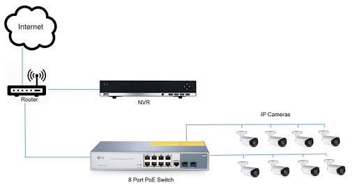

Ive attached a diagram of my set up - its exactly as shown but mine has just 4 cams obviously. the poe switch is a Hikvision model.

We wouldn't recommend connecting the PoE switch directly to the NVR. You're best to plug them directly into the back of the NVR or into the PoE switch connected to the router that you have the test camera working on. If the cameras are working then they'll show up on SADP when plugged into the same switch as the test camera.
You'll then need to activate each of the cameras which you have connected to the switch in the SADP tool, see the how to activate a Hikvision NVR or camera section of our Megathread to see how to do so. This should get you back up and running, remote access should be fine as it is.
