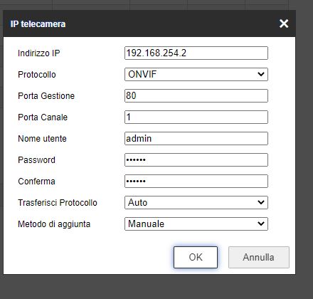

To connect 3rd-party cameras directly to the NVR PoE ports you will need to first connect the cameras to the TP-Link PoE switch, open the cameras in a browser or find them with an IP Utility Tool, change the camera's IP address and gateway to match the NVRs subnet range (check the NVRs network settings to confirm this but probably 192.168.254.xxx), save those details and then reconnect the camera to the NVR PoE ports.
Once connected you will need to go into the NVRs Camera Management page and switch the corresponding channel (e.g. D1 is port 1) to Manual rather than Plug & Play. Finally, you need to click edit/modify for that channel and change the IP address, user name, and password to match what you set on the camera when it was connected to the TP-lInk switch.
As you can see this process is quite complicated and as they are 3rd-party cameras you will not be able to login to them directly once they are plugged into the NVR PoE ports. We usually recommend that 3rd-party cameras should be installed on a separate switch and then added to the NVR over the local network because that way they have their own LAN IP address which means you can log in to the cameras individually to adjust camera-specific settings and update firmware.

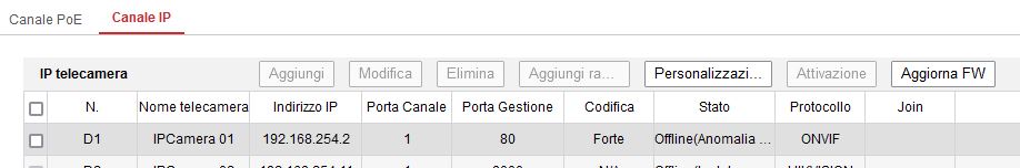

I did as you advised me: I set the first ip address indicated in the poe channels of the nvr to the ipcam. I also set the same password of the nvr, but the poe port continues to remain off. What protocol should I set to the ip cam?
Hi @gnesper
If ReoLink and/or SIMICAM don't appear in the protocol list, use ONVIF instead.

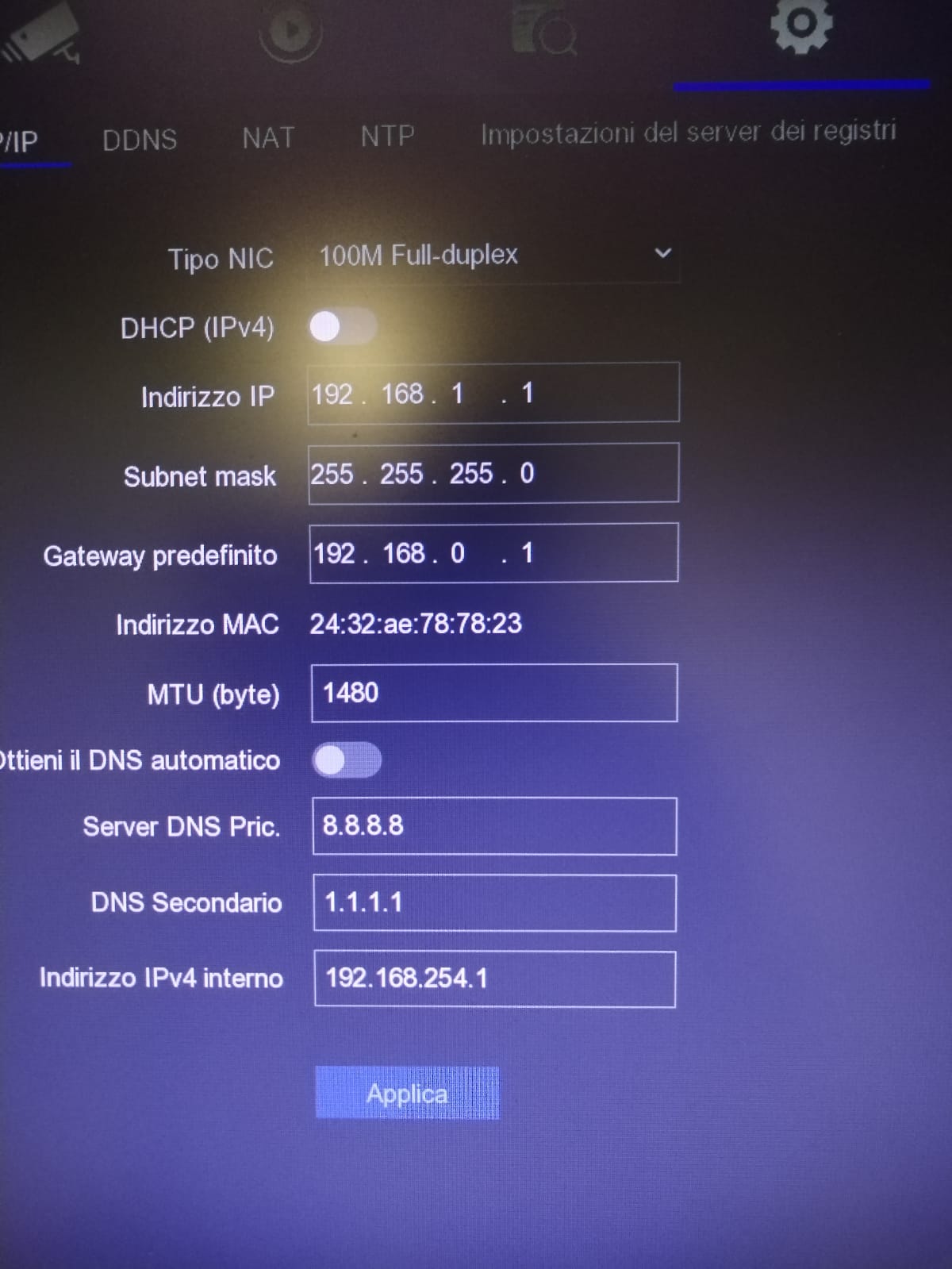

Hi @gnesper
Can you go to the NVR network settings and confirm the NVRs "Internal network card IPv4 address"?
If that address is definitely 192.168.254.1 then the only other things that might be causing an issue would be:
Strong Password - when you set the password for the camera(s) was it strong? Did it include at least 3 of the following characters - lowercase, uppercase, numbers, or special characters?
ONVIF - Some camera brands do not have ONVIF enabled by default, you may need to get the camera back on a separate PoE switch and log back into to check for ONVIF settings that may need to be enabled.
(you may have to locate the user manuals for the specific camera models you have to find out where those settings might be)
Hi @Dan
I confirm that the internal ipv4 address of nvr is 192.168.254.1 (picture1).
The camera's password is strong, it includes lowercase, uppercase, numbers and one special character.

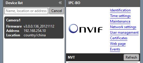

I can confirm that Reolink is Onvif compatible and you can see the ip address (192.168.254.10 ) is in the same range ad nvr (picture2).

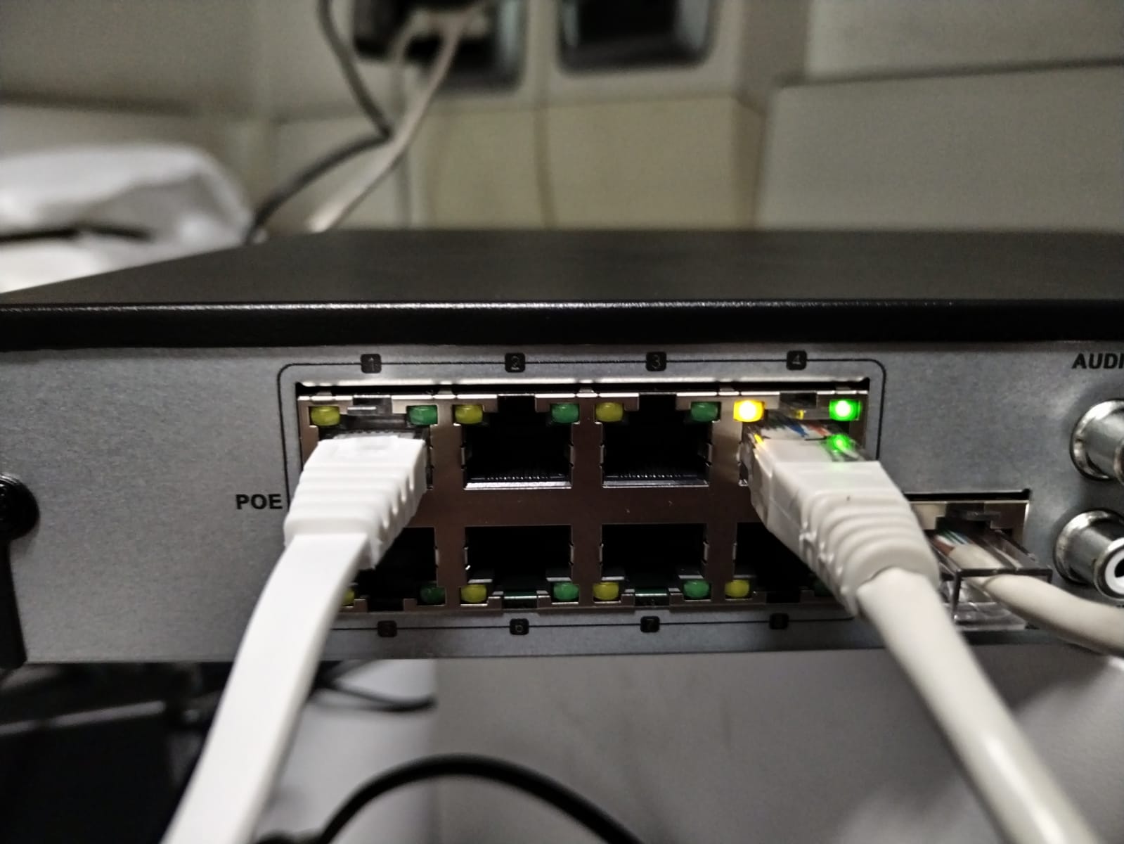

The problem I have isn't in the configuration part (infact, I can make it work without any problem through external poe switch) but when I connect the ipcam directly to the nvr's poe ports.
As you can see in the picture3, in the port1 there's connected the ipcam poe but there's no lights on, as if there wasn't nothing connected
meanwhile in the port4 there's a switch connectec and the lights turns on without problem.
To me it seems like the nvr can't turn on the device connected, but it works only like a classical switch.
I want to know if the poe ports are malfunctioning or the ports light turn on only it connect a original hikvision ipcam poe.

Hi @gnesper
You hadn't mentioned the switch being plugged into the NVR PoE ports.
Some Hikvision NVRs (not sure about consumer HiLook/HiWatch models like yours) can support having a switch connected to the PoE ports, but when you do this it disables the other PoE ports on the NVR.
If you unplug the camera and switch and then reconnect the camera it will probably power the camera without a problem (although you may have to go into the NVRs PoE port settings and re-enable power to the ports).
If you want to have some cameras connected via a separate switch, that switch needs to be connected to the local network and not directly to the NVR. You can then assign local network IP addresses to each camera on the switch and manually add them to the NVR over the local network.
(I should also point out that in the first screenshot of your network settings, it looks like your IP address & gateway address are on different ranges - 192.168.0.xxx & 192.168.1.xxx - I'm not sure which is the correct range so you are probably best off enabling DHCP at the top of the page, save settings, and then once the network details have changed you can disable DHCP and save settings again)

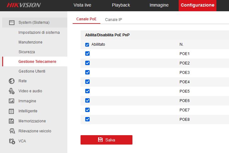

I tried to connected only ipcam to the nvr's poe ports (without external switch) but the lights remain off and the poe ports settings are enable (picture1).
Don't worry about the ip configuration, it was just a test without internet

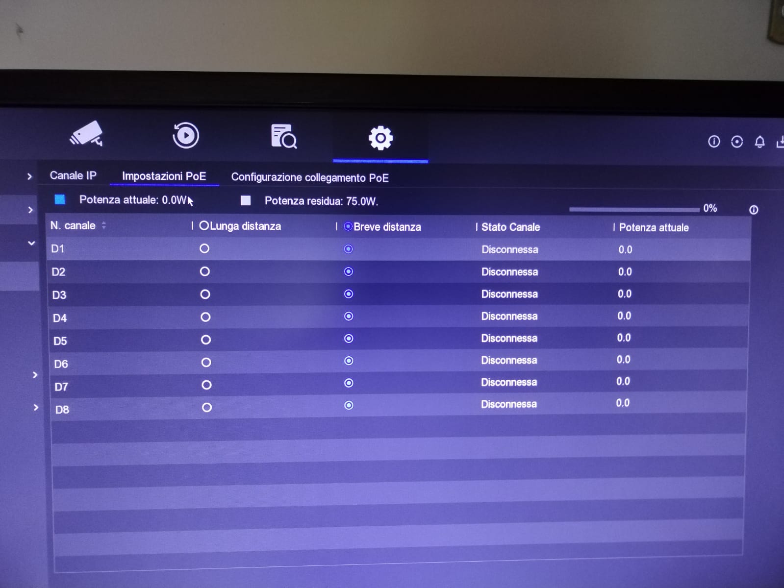

I just did it.
After doing the first configuration, still no sign of life coming from poe ports.
In the picture you can see that there's not power going out, it makes me think there is something wrong with nvr.
What do you think?
If you are plugging cameras into that port and you are not seeing any PoE power being used then that probably suggests a fault, we would recommend speaking to the supplier you bought it from.
